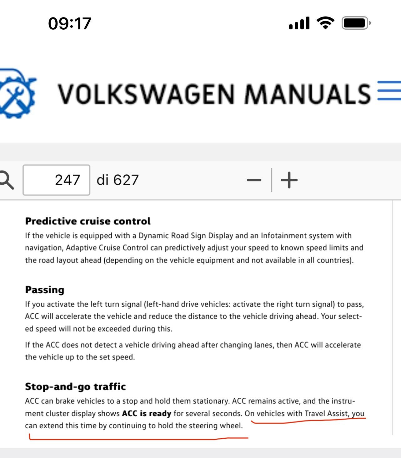

The test is: a car stops behind me, how many seconds does the ACC stay engaged? Just 3/5 secs, no capacitive, long time with your hand touching the wheel, capacitive

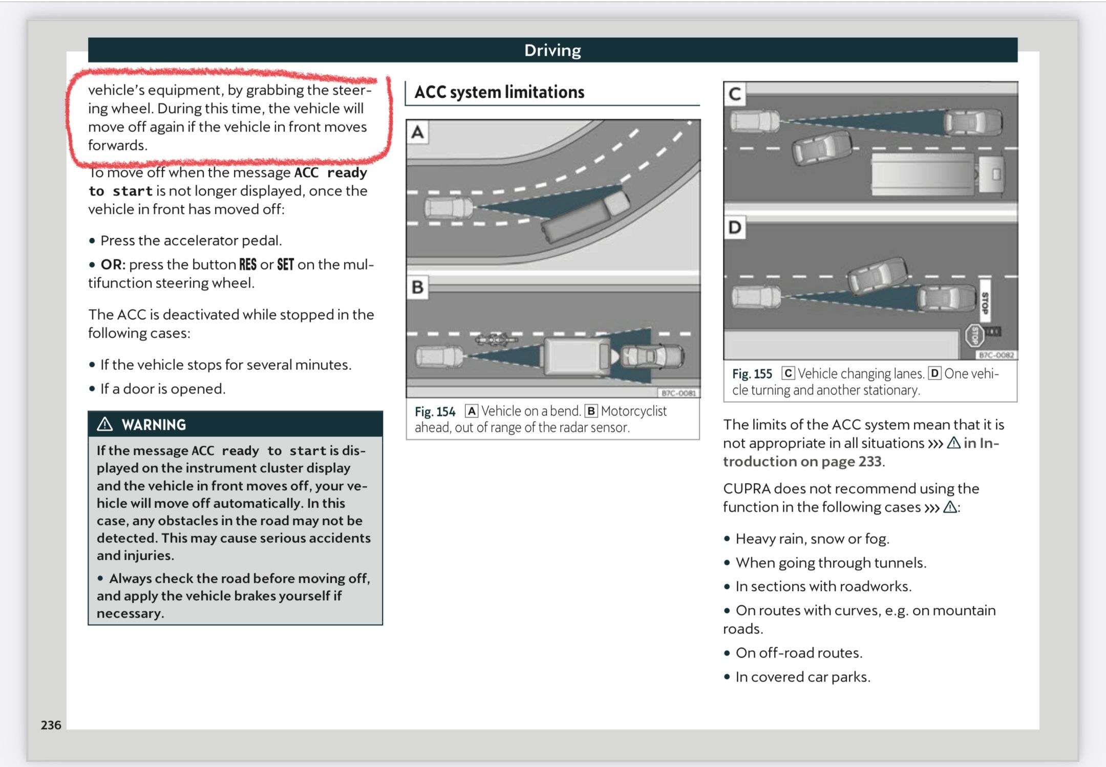

From Golf 8 manual

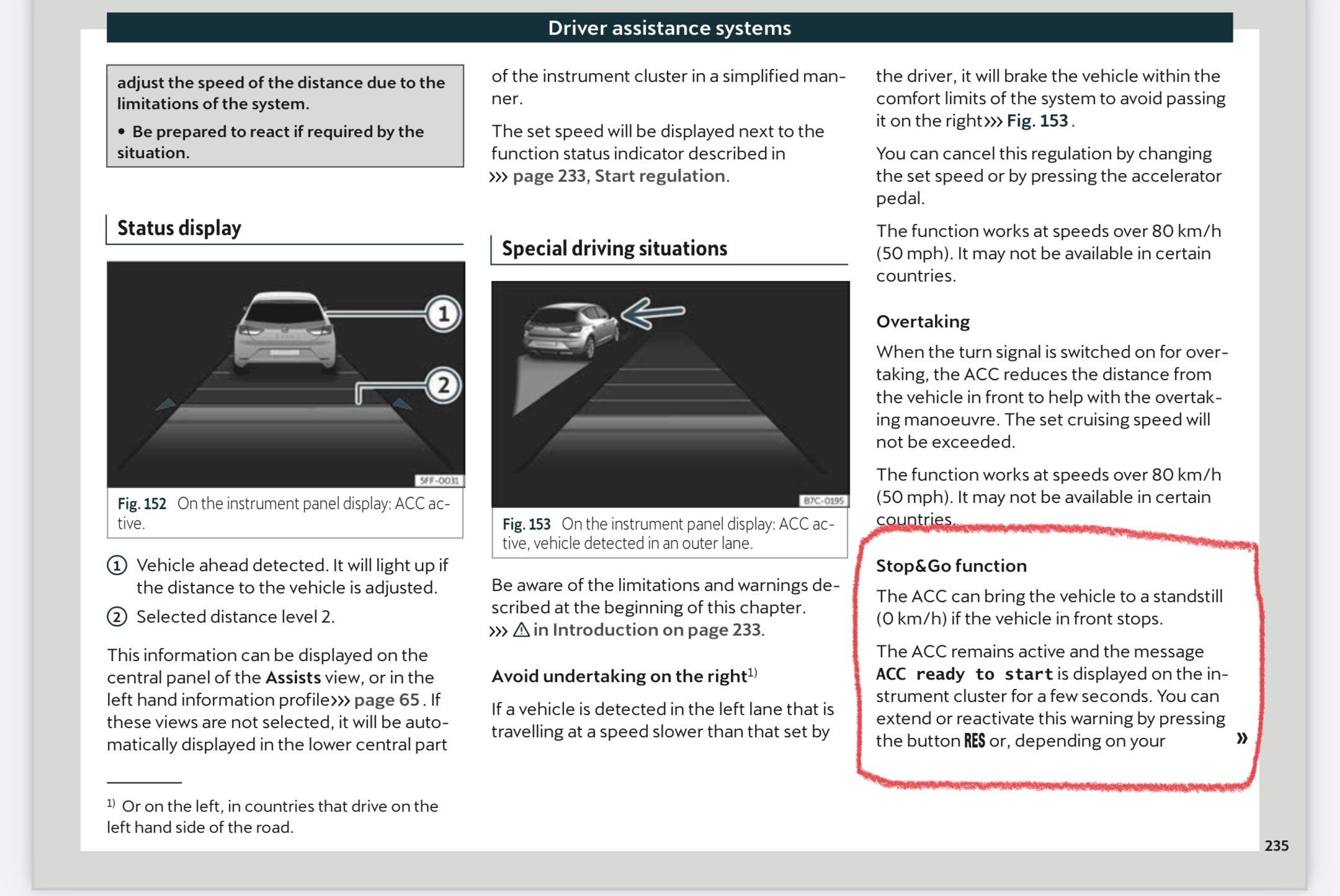

In the manual I downloaded when I got my car the text is slightly different (and more amusing):
The ACC remains active and the message ACC ready to start is displayed on the instrument cluster for a few seconds. You can extend or reactivate this warning by pressing the button or, depending on your vehicle’s equipment, by grabbing the steering wheel. During this time, the vehicle will move off again if the vehicle in front moves forwards.

Ok so it looks like older models are not equipped with a capacity steering wheel. Any other experiences?

In fact, our Formentor, Manual doesn’t originally explaines that there is a new automatic touch steering wheel. While the Volkswagen ones are reporting that.
