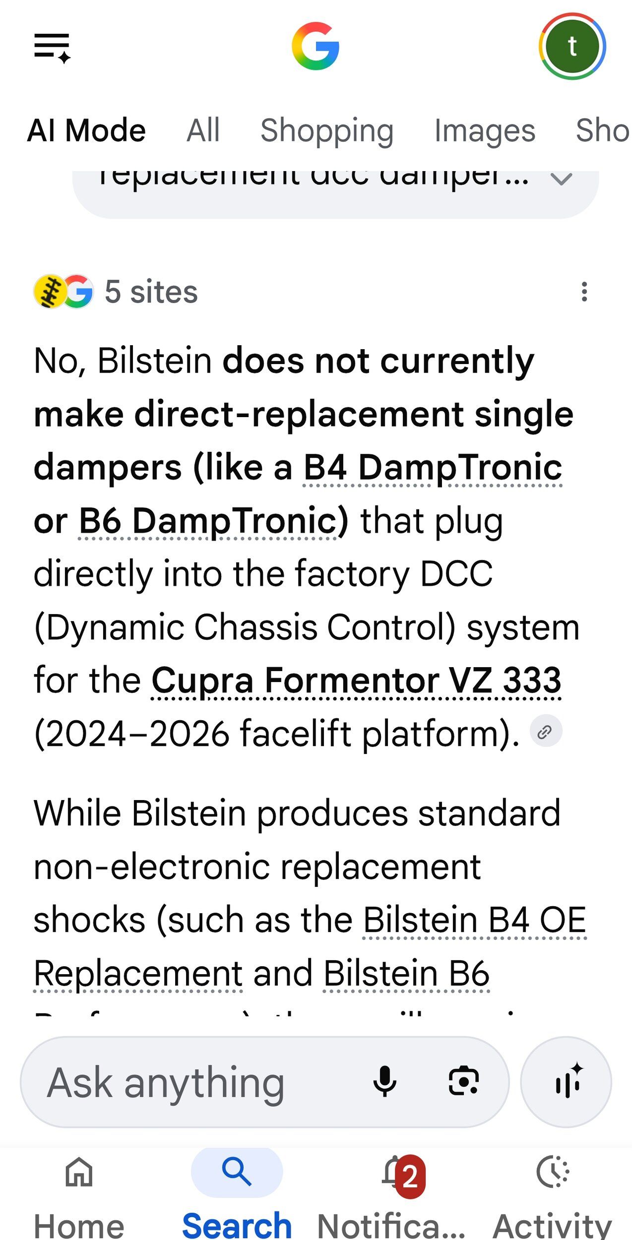

^^^^ My research suggests Bilstein B6 DampTronic retain DCC functionality with the aspect of working with standard springs / ride height.

See here.... unless its the pre facelift maybe....
