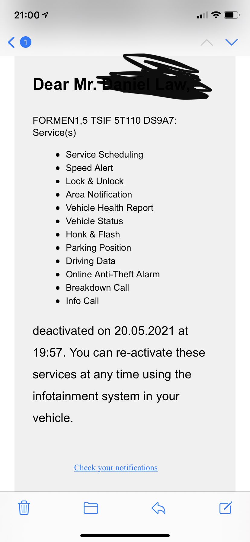

Just had the email. Car has been parked up for the past 6 hours. Anyone else come across this?
My car switched to anonymous user after being parked for a week. It sent similar email. When Infotainment switched on, I switched the user to myself with no issue.
Reactions: CupraPoopra
I’ve had that a couple of times, not had it since my “identity” has been verified from dealer and I logged in again to the Cupra app.
Tested the remote unlocking from phone and that works but not actually been in the car since to test anything out.
