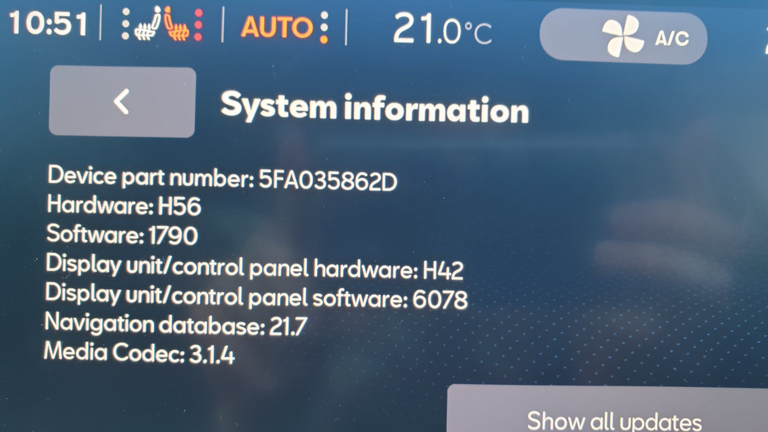

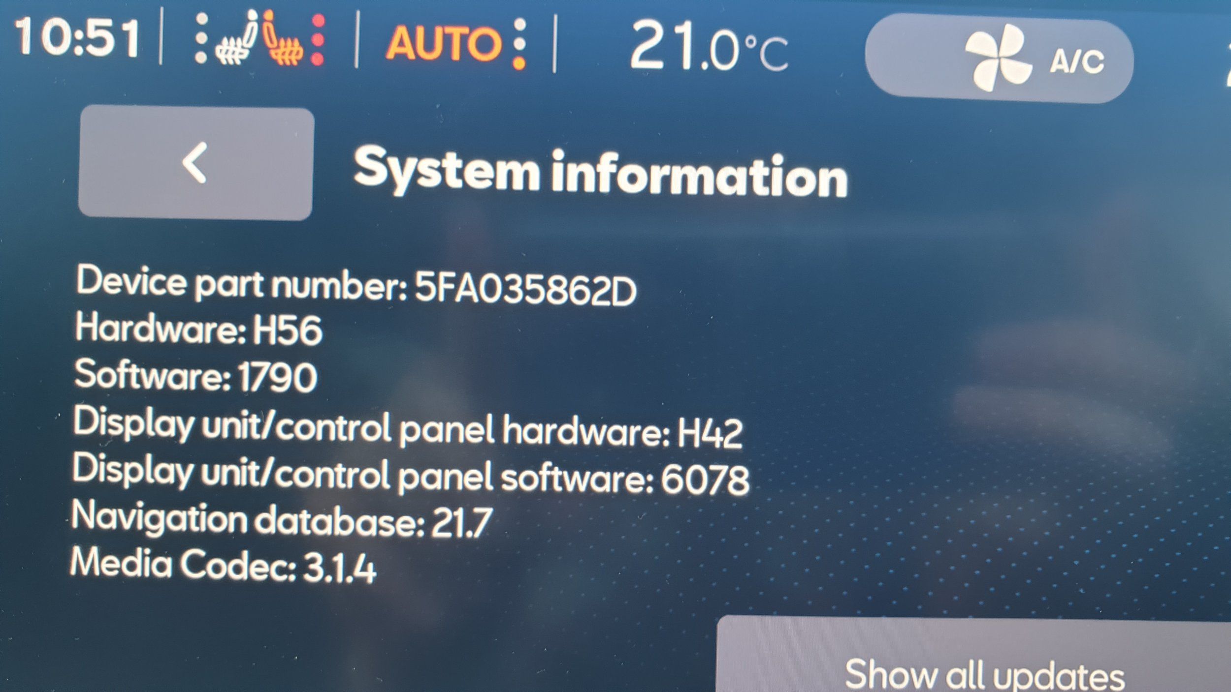

Can you post your software versions?

One more thing, My individual driving mode was not configured any more. I suspect it lost its settings when car was showing messages about changing configuration some time ago or when it logged me out while driving. Can't be sure when it happened, because I was using Cupra mode most of the time.
Software version changed only for Display Unit/Control Panel Software from 6069 to 6078. Everything else is the same.
Hate to disappoint you but I’ve got exactly the same software versions and the popping still occurs.
