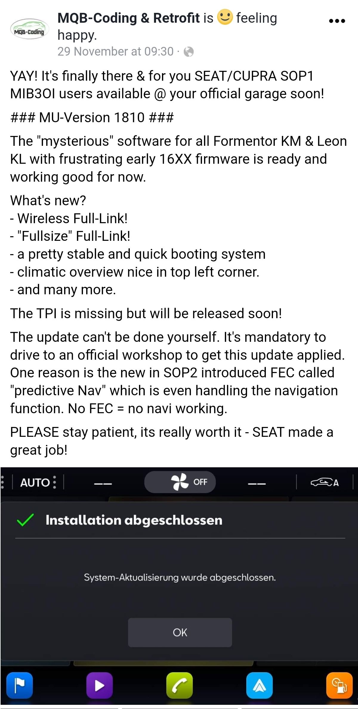

I was talking with user 1803, after update zero SOS error, faster start infotainment
KoNG
Jul 27, 2016
537
126
London
I have 1788, but I saw 1803 in seat KL, I called to workshop but they don't have update for me... Why? I don't know.... Can you sent me link from German group? Do you know something about update in December?
I think the update hasn't been released to the Dealer networks yet only few people for testing i guess standard software development embedded practices. We just have to wait I'm hoping to have it in January. I would doubt it to have it before
KoNG
Jul 27, 2016
537
126
London
Sorry update is for version 1810 and will be only related to older versions infotainment 5FA035862 stuck on 1672
