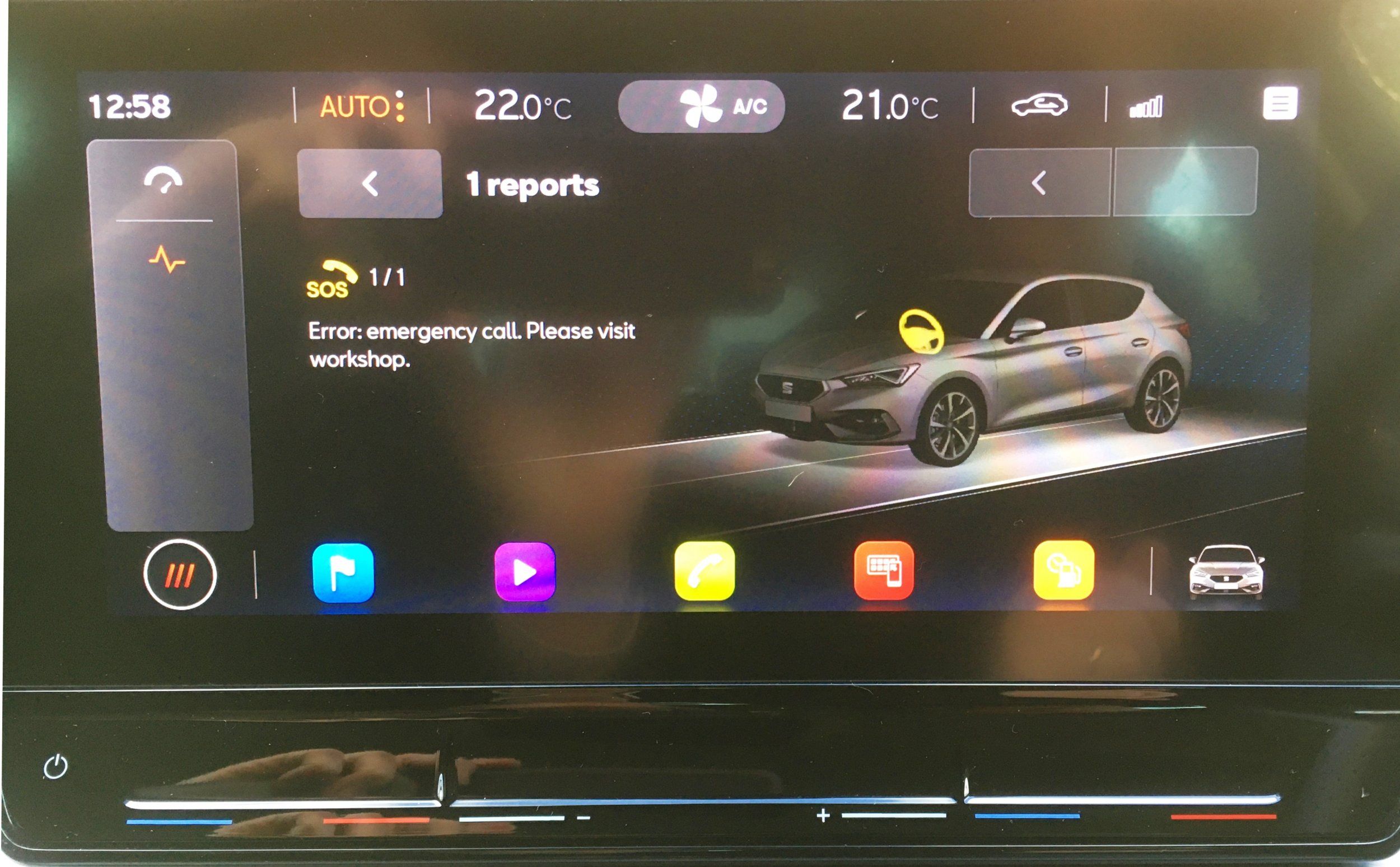

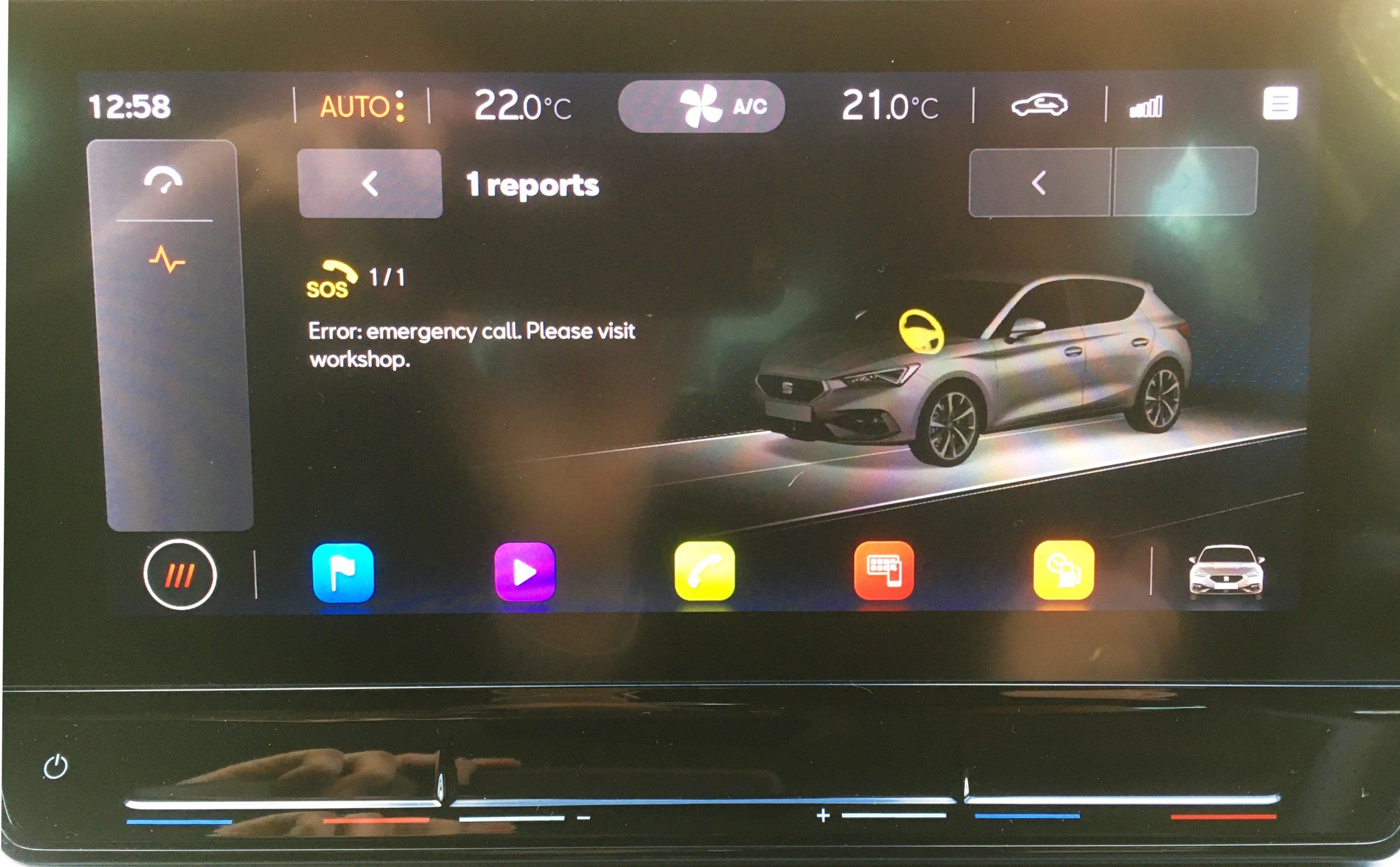

The SOS error happened to me again a few days ago (on a built up road so unlikely to be signal strength related). Once I'd got home, I did not switch the engine off but searched through the various screens until I could display the error log. This is what came up.
It would be interesting to know if others are getting an identical message. For those who don't know, you press the Petrol Pump icon on the bottom of the screen and then select the option to display reports.
Yes, that's what I had last Saturday. Also available by tapping on top right of screen
Did you get a notification (red dot) in the top right-hand corner. As you can see from our photo, there was nothing to indicate a new notification
