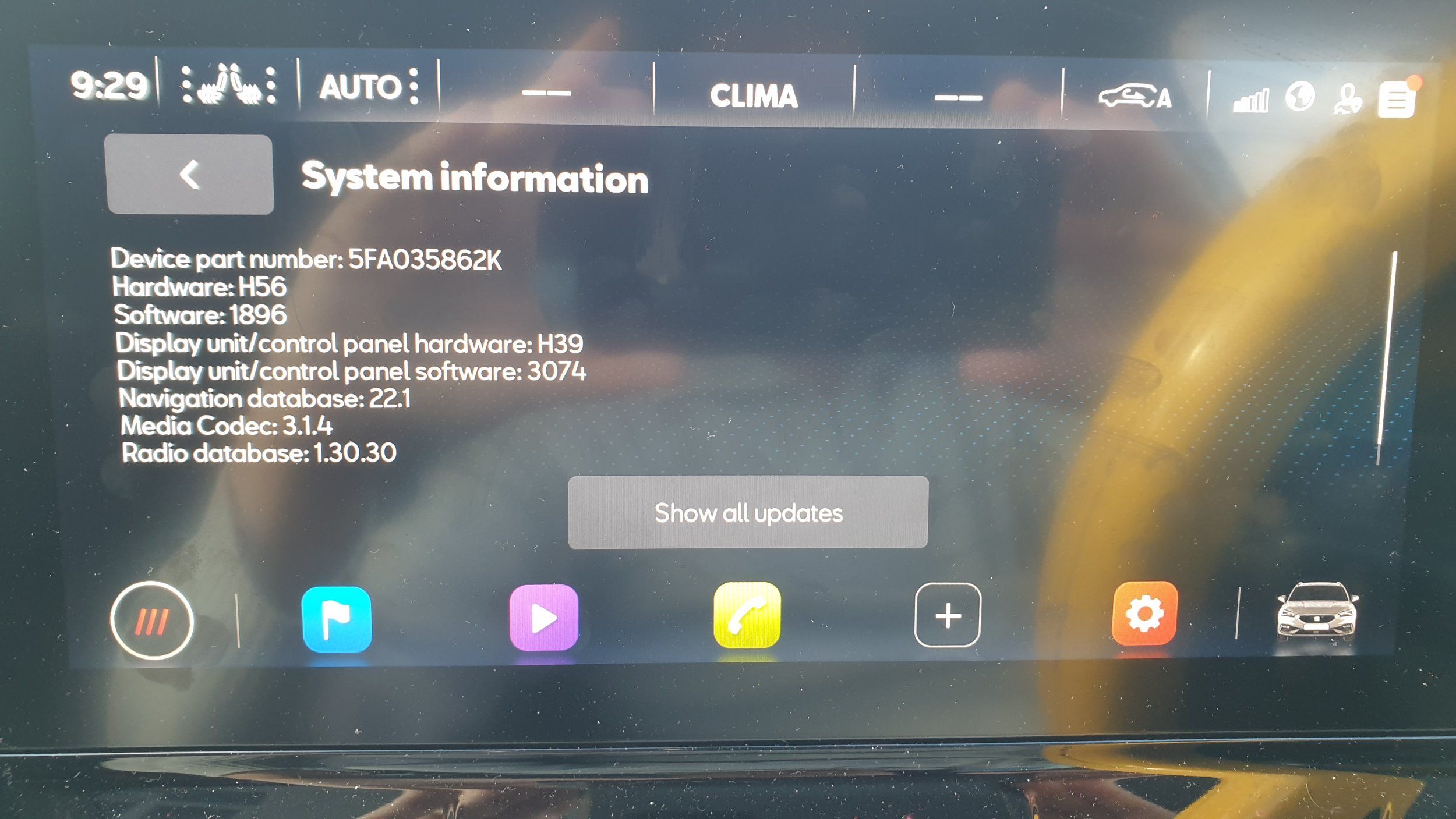

Do you know what version update you got? Was it 1896?
Yes, that's correct.
Mine went in Tuesday and only put 1803 ? but I haven’t had the sos error yet ?? But not to say it won’t happen.
Dealer adamant that 1803 is the latest and the sos fix won’t be out until April.
I had 1803 and was ok for a day then come back ,but guy at work they replaced his infotainment module and that’s cured it and he is on 1788
