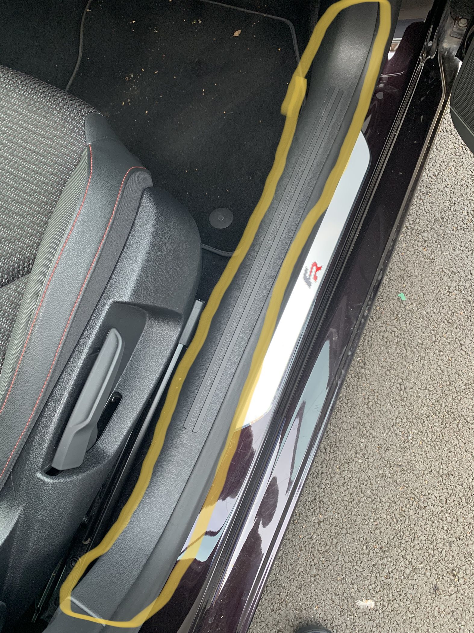

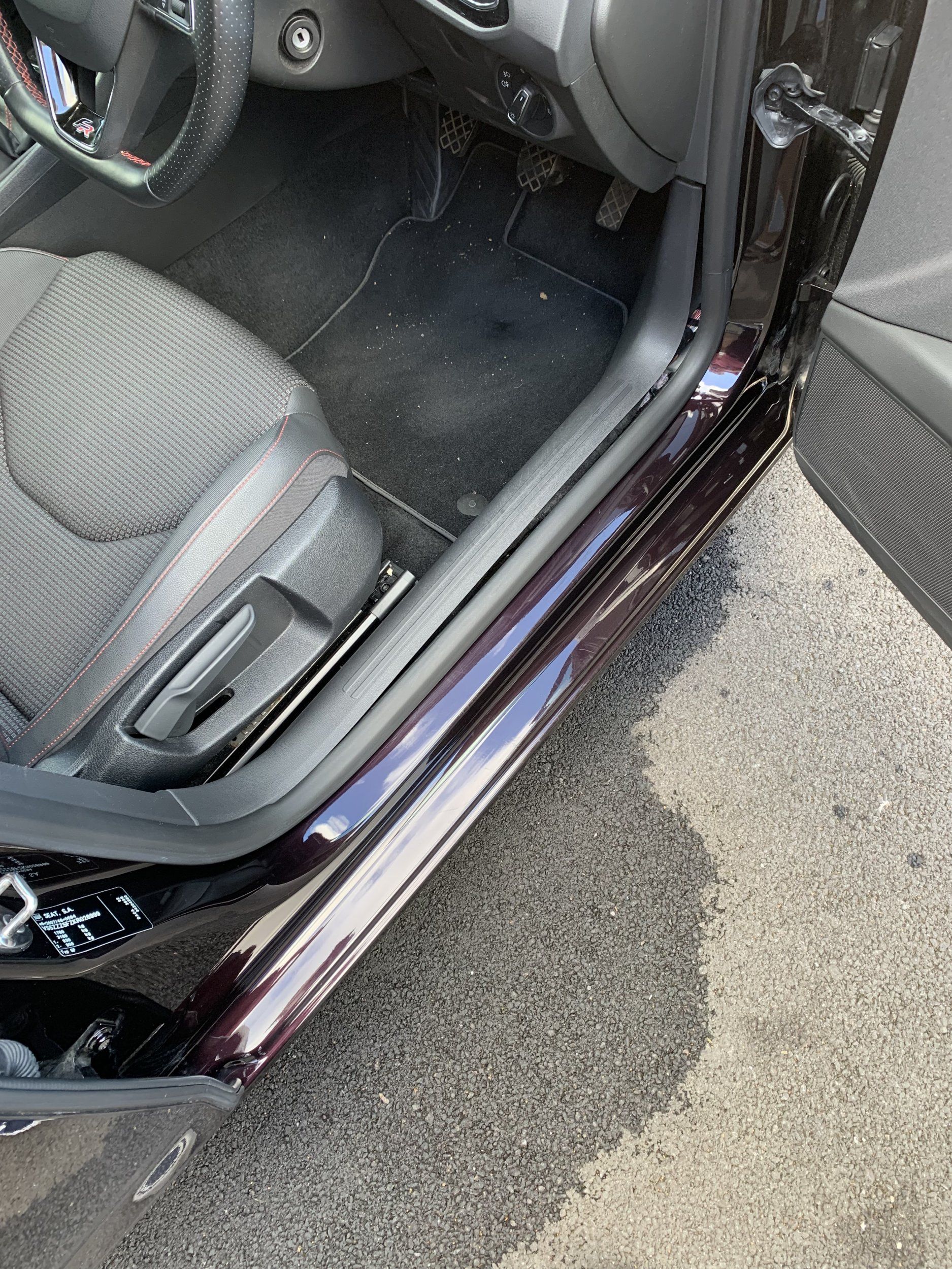

Ah cheers, will have a look at that tomorrow fingers crossed! Thanks for the advice, much appreciatedHair dryer / heat gun will be fine. Plastic trim removal tool underneath to lift. They are flimsy and easily damaged so don’t even think about trying to repair it. Will also need some IPA or ‘sticky stuff remover’ to remove the glue residue/clean prior to reapplication.
New Cupra sill was about £60 f
Hi, I’ve got the same problem and am struggling to get the trim off. Worried I’m just going to snap something, do you remember how to do this? Start at the front? Which way does it pull away? Thanks!Managed to get inside the trim, doesn’t look like the plug is loose, so think it’s the LED that potentially gone. Anybody know what voltage the LED is, so I can test it before ordering a replacement!
