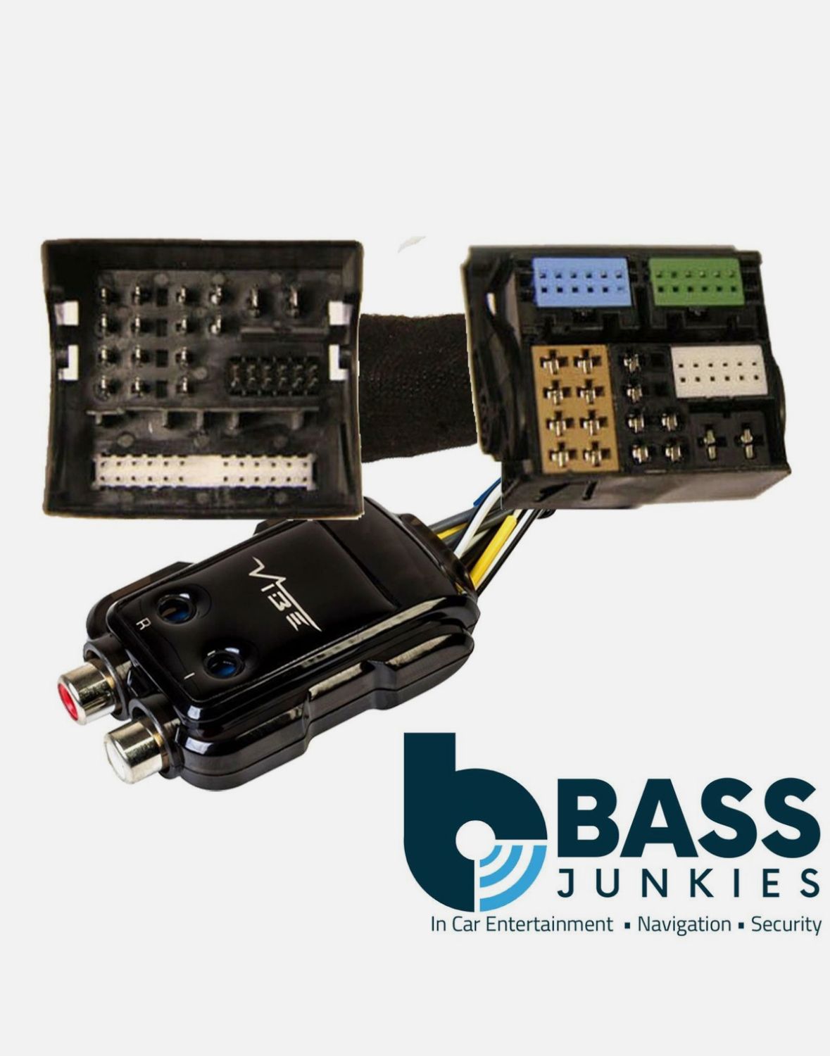

Yes there’s bass coming from the sub, just non existent even though it’s using a hi-low converter, which i’d assume is going to eliminate that problem? It’s been wired in before as you’ve mentioned and that still didn’t work, which is why i bought a converter. I’ll attach a photo of the adaptor i have. Not sure if it’s obvious in the photo but it’s an extension of the wiring harness with a vibe hi low already wired into it.
Well it should be getting a low frequency signal from that, what are the settings on the sub amp and also the Sound/EQ settings on the main unit?
