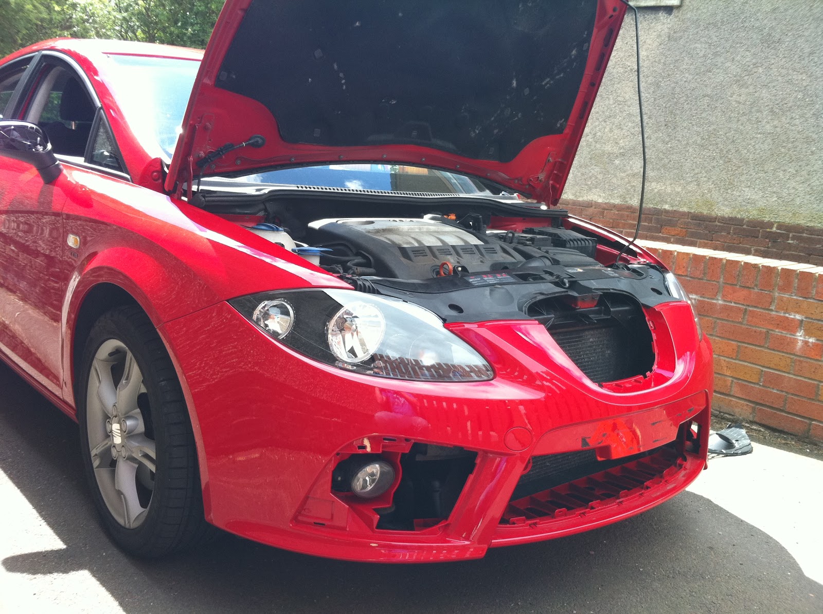

I realise this is a slightly old thread, but I was searching the forum this morning looking for an answer to this myself as Seat wanted £65 to take this grille off for me. I figured I could probably get it off myself relatively easily.
Kev is right, you'll need to take off the two lower side grilles (where the fog lights are) 1 screw holding each side in. The clips holding the lower center grille are SOLID! You really need to get your hand in behind the grill to manoeuvre the clips. The secret is to try to expand the body coloured part of the bumper which is holding the clip in rather than try to push the black plastic bit out.
To get my hand in behind the lower grille I ended up having to take my main grille out as well (I had already done this previously and knew the knack to getting it out)
Thankfully I managed it all without breaking anything (small cut on thumb though! :cry:)
