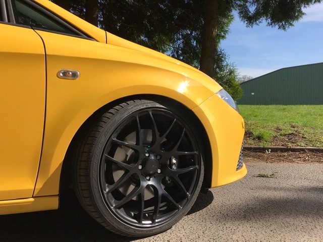

I replaced my stock springs with 35mm H&R’s and the ride is honestly about the same, maybe even better than stock! And it’s a really good ride height IMO
