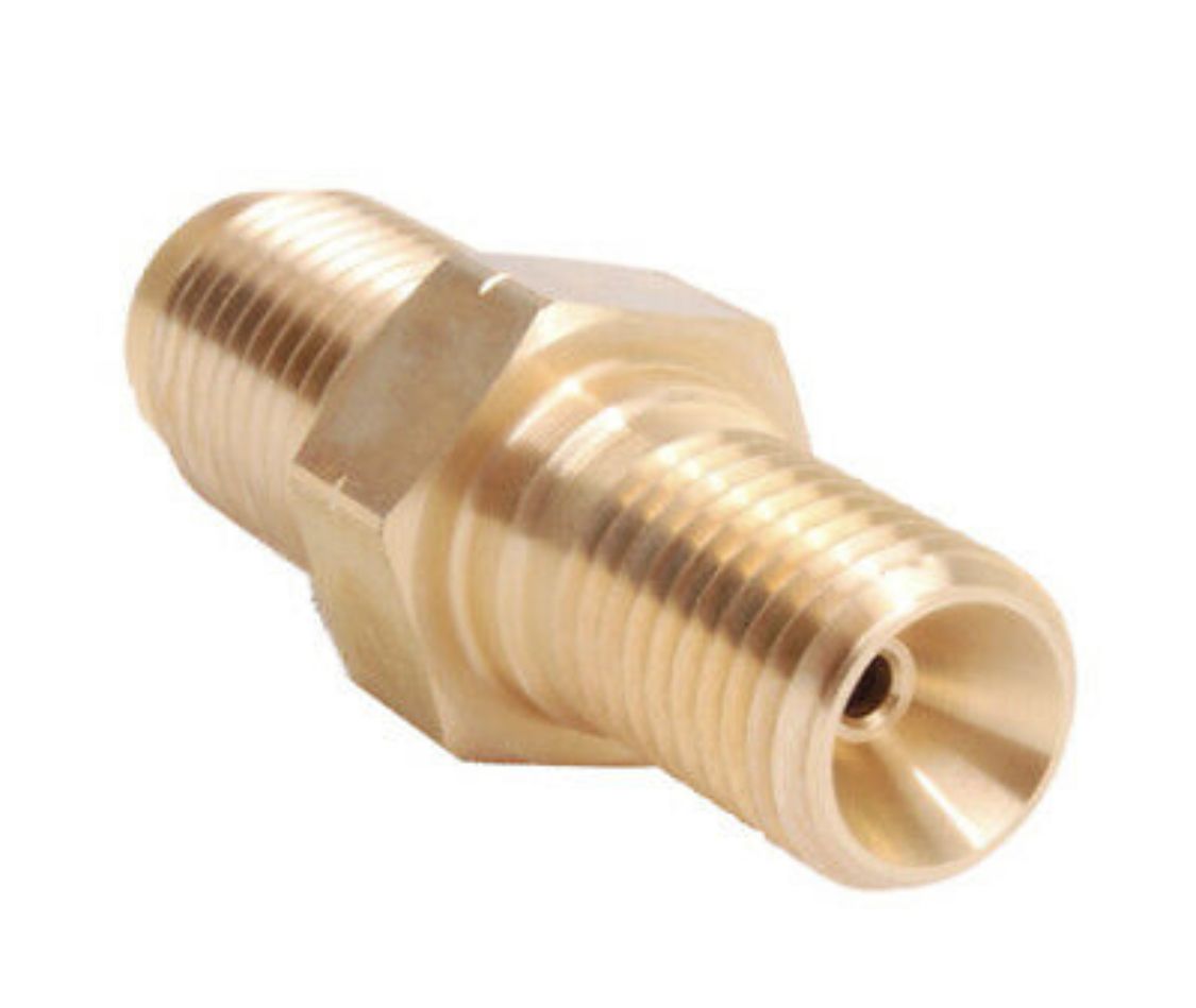

This?

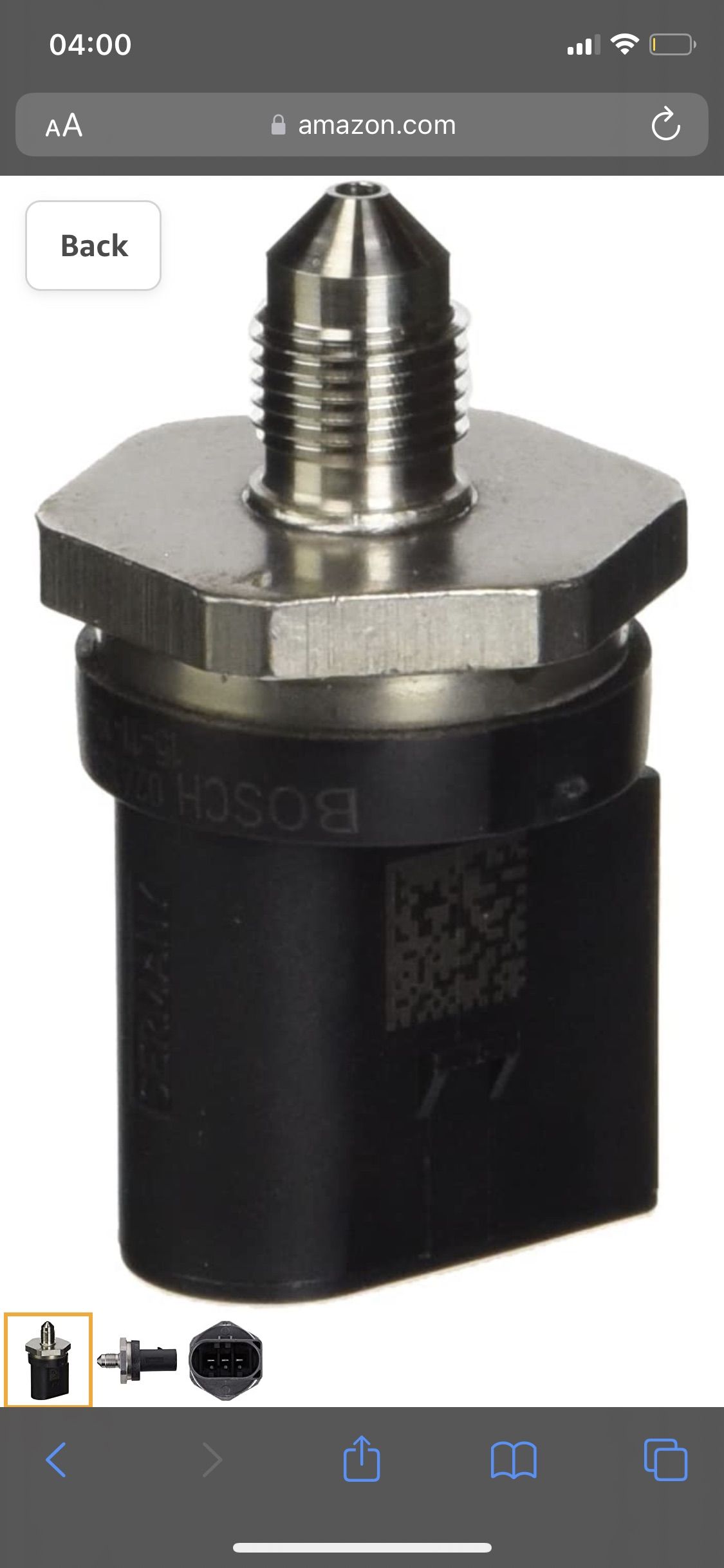

Someone told me to try changing the fuel rail pressure sensor first and then that fuel return valve. I will change both.

Definitely do that first. Shame your not in the Uk as I have a good used one on a spare engine you could have borrowed to test if it helps fix it.

Sorry. I think it fixed that code; today haven’t got it, I floored it in 3rd and 4th gear to 6k rpm without the pending P2293 code appearing. I’ll find out today after some more runs.
I said it didn’t fix the fuel pressure drop when engine is off. The pressure in rail was supposed to go up with warmed up engine; it’s dropping instead. I removed each spark plug to see if it’s wet and smells like gasoline, all 4 had no gasoline smell which tells me it’s not a leaking injector if I’m right, not getting any sort of smoke from exhaust, car accelerates smooth, no problems starting the engine when cold or warm. It’s just this pressure thing which is pissing me off, ‘cause I know somewhere is a problem since I noticed poor fuel mileage as well (or it’s just in my head) + in my friend’s Cupra the pressure is going up when turning the engine off.
