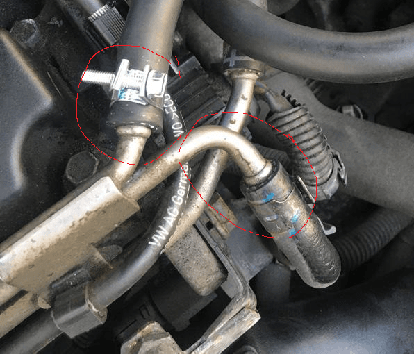

I have to admit that taking off the fuel lines is a PIA, I reccomend taking off the lines from aluminium fuel line than from the tandem pump.(photo attached)

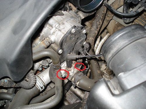

+ second thing if you have the same issue as i had make sure you drain the coolant from the car, after that you need to get rid of the coolant pipe that is under the tandem pump ( the one where is temp sensor, photo attached). if you won't do it and you will start drilling drill will be on 2-3 degree angle and you will have issues tightening the m6 screw. also take out the air filter housing and put the car in 6 gear so there is enough space to fit the drill.
