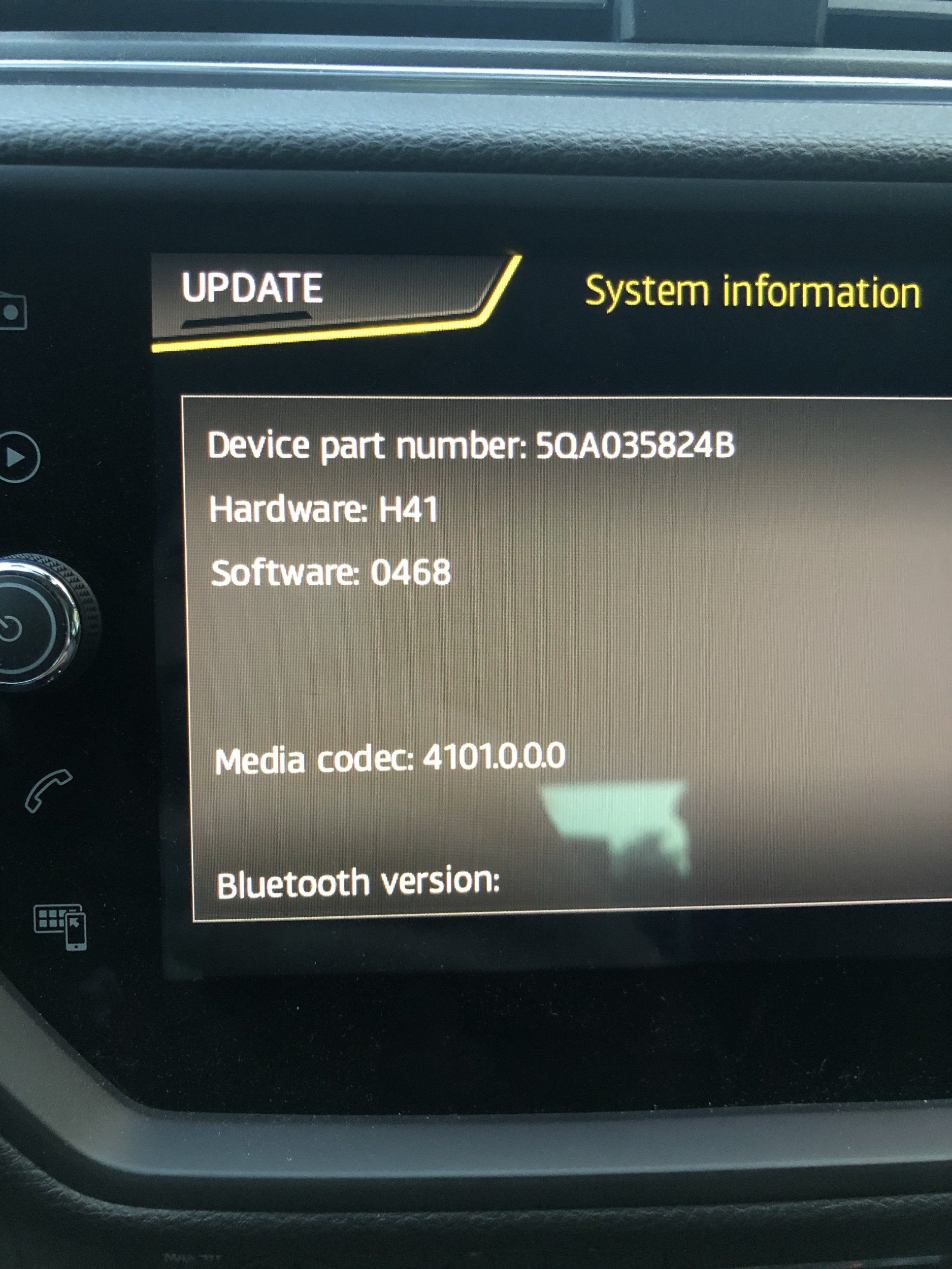

Hi,
I have seat ibiza FR pro 2018 and I have version 0468 and I found here the link to download the 0479 update.. I wish to update to 0515 but I don't want to damage my unit.
Full link is unlocked at my car and I don't know if its like this from the manufacturer or the guy before me unlock it with a dealer.
My question is, if I update my unit to 0479 I will lose my Full Link activation??

If you go from 0468 -> 0479, you will still have all features active as before (as long as their are legitimate).
Do not go from 04xx -> 05xx software, unless you want a dead / problematic device. Simply not worth it.
The higher number in the VW head unit naming scheme does not mean newer version, but a different set of hardware and software combinations.
For example 04xx are all head units produced by brand X and are validated to work with that software package.
While 05xx are all head units produced by brand Y and are validated to work with a different set of software packages.
If you mix hardware from brand X and software from brand Y, than you will have a bad time, and 0 additional new features / bug fixes.

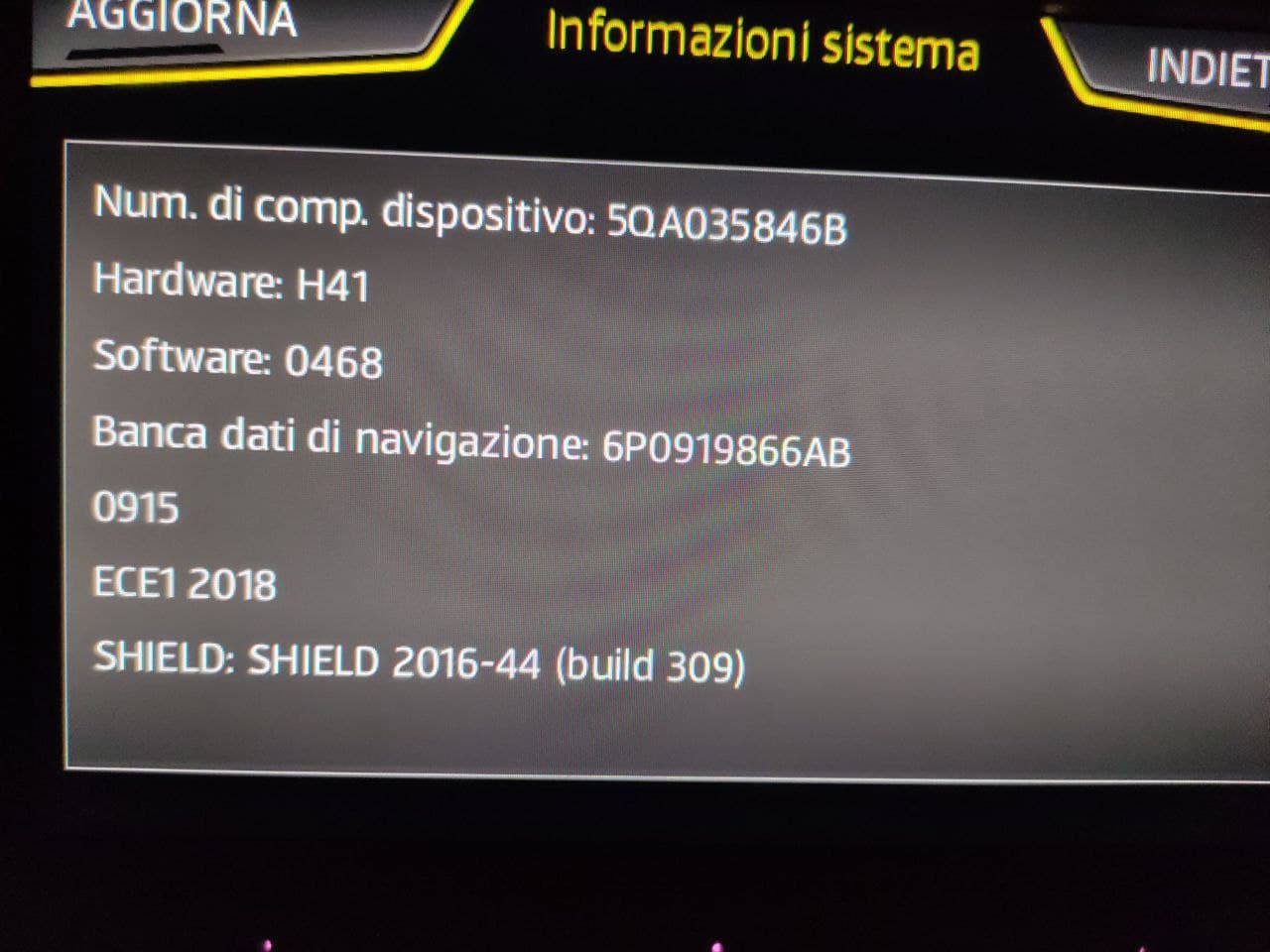

Hi all,
is it possible / save to update my system 5QA035858B, HW: H41 from Version 0468 to 0479 at my Seat Ibiza 2018 by using the file "MST2_EU_SE_ZR_P0479T.7z" as described above via SD card (slot #1 etc.)?
Thnx a lot for your help in advance!

Yes, the same process from my previous post should work on your car. Hardware unit is the same, software branch/variant is compatible. (y)

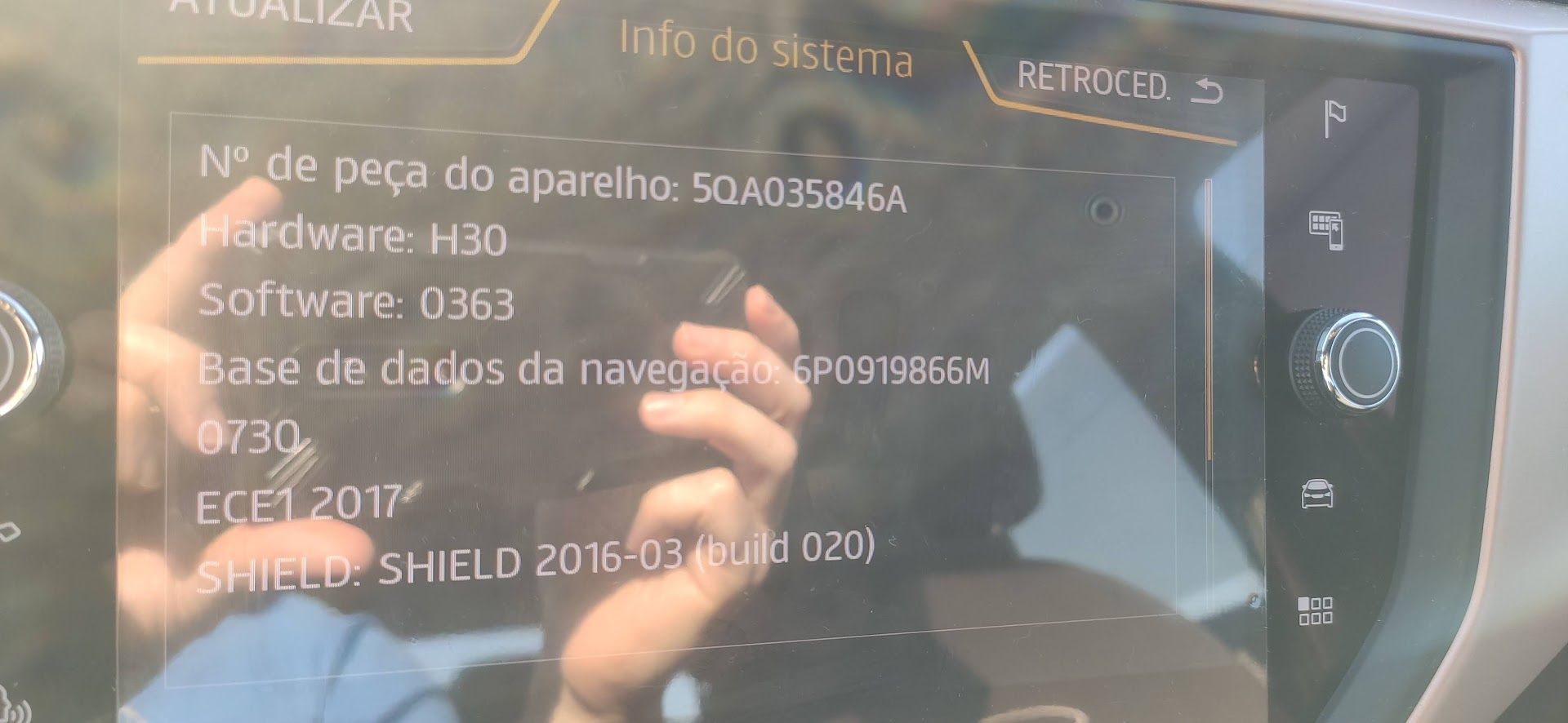

Hi all!
Can anyone help me to confirm that I can update my system?
Thanks a lot!
