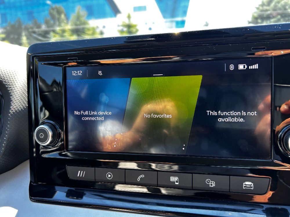

Hi everyone,
I own a Seat Ibiza 2022 1.0 TSI 110hp Style DSG.
At my 60,000 km service, I asked for a software update for the MIB unit because:
  • When connecting my phone, I got the message “accessory not supported.”
  • When trying to use CarPlay with a cable, the system displayed “USB does not contain data” and did not recognize my phone (I had to connect it manually).
The system was updated to version 1800. After this update, a new issue appeared: on the main screen (where Front Assist, Lane Assist and ESP menus normally appear), a permanent message now shows: “Function is not available.”
I reported this to the service before taking the car back. After discussions with the manufacturer, they told me:
  • This layout will stay as it is,
  • The “function is not available” message will always remain,
  • According to TPI, no further action should be taken.
Unfortunately, my original CarPlay/connection issue still remains, and now this additional problem has appeared after the update.
? Has anyone else had this problem after updating to 1800?
? Is there a known fix (maybe coding, firmware rollback, or another update)?
Thanks a lot for your help!

Unfortunately, the photo is completely useless. Officially, you can only get an invalid FeC by reactivating the function online using ODIS. Reverting to the old firmware won't help. I'm not sure if there's a patch available for this model.
That was on my mind because I saw that 0006100 SWaP/FeC code became invalid for some reason after the latest update. And that FeC code is responsible for that bar and the vehicle status.

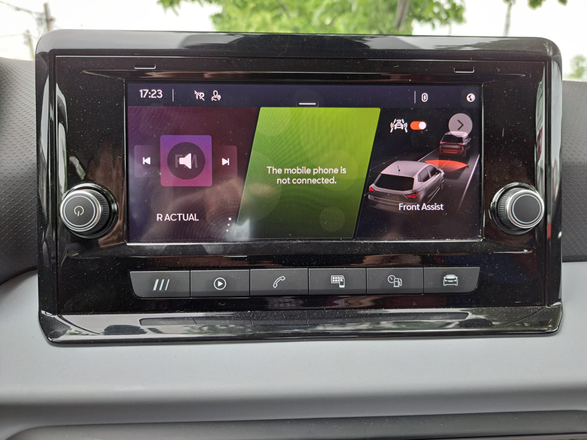

I have the same MIB3 and 00060100 isn't activated, but Front Assist, Lane Assist and ASR menus are visible (SW 1761).
Maybe not 00060100 SWaP/FEC is the right reason.
00060100 SWaP/FEC means ,,Car data monitoring enable,, .
Can you take a picture of your screen and the MMI so I can see how that bar looks on your home screen?
Your software version is 1761, and mine was 1790 when it worked. After updating to 1800, that home screen bar got messed up.
Yep, this is exactly how it was before the dealer updated my MMI to the latest SW version 1800.
So they messed up that bar with the latest update.
Now I only see the message “Start the engine” when I turn the key to ignition but don’t start the engine immediately. After I start the engine, the message changes to “This function is not available” all the time, and you can’t do anything with that bar.

This issue has nothing to do with mobile devices. It concerns the infotainment system functions and its software version, where functionalities that worked in the previous version are no longer available in the latest version.
I sent an inquiry directly to SEAT Connect support in Martorell. They asked me to provide the necessary details and screenshots from the MMI, and then informed me that everything had been forwarded to their technical department for further analysis.
EDIT:
And they answered me:
I received an official response from an authorized service center. Since the last update and software version 1800, SEAT decided to remove the Front Assist (ADAS) display from the home screen, specifically from the third tab. They claim this is due to safety reasons and EU regulations. Honestly, I’m not sure what kind of safety that is, since all Front Assist settings are still there — it just takes a few extra steps to access them via menu or home button.
Since they didn’t provide an alternative for that space, and there isn’t even an option to enter edit mode (for example, by long-pressing) to customize those home screen tabs, it now just shows a message saying “Function not available.” And it will likely stay that way until a future update either replaces it with something else, brings back Front Assist (ADAS), or allows users to customize shortcuts on the home screen themselves.
