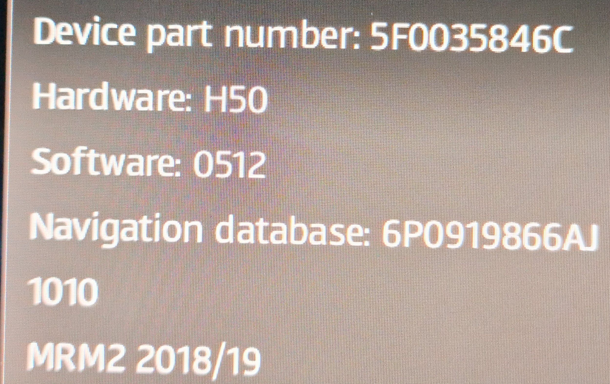

help me figure out what firmware i need to update since i cant find the right one i have 512
this is the info
thank you

Thank you very much, and just for notes does it matter the region of the car or anything like that
I think that it does not. The firmware is called "MST2_EU_..." where EU is the region. But since I did not see any other region variants, I presume that its universal.
EDIT:
According to this: https://www.digital-eliteboard.com/...2-delphi-unit-patchen-fec-swap-cid-cp.495796/
For some units / countries there are special variants. In the link they list:
"EU = Europe Variant (US = USA / CN = China)"
Thank you for the help ive downloaded

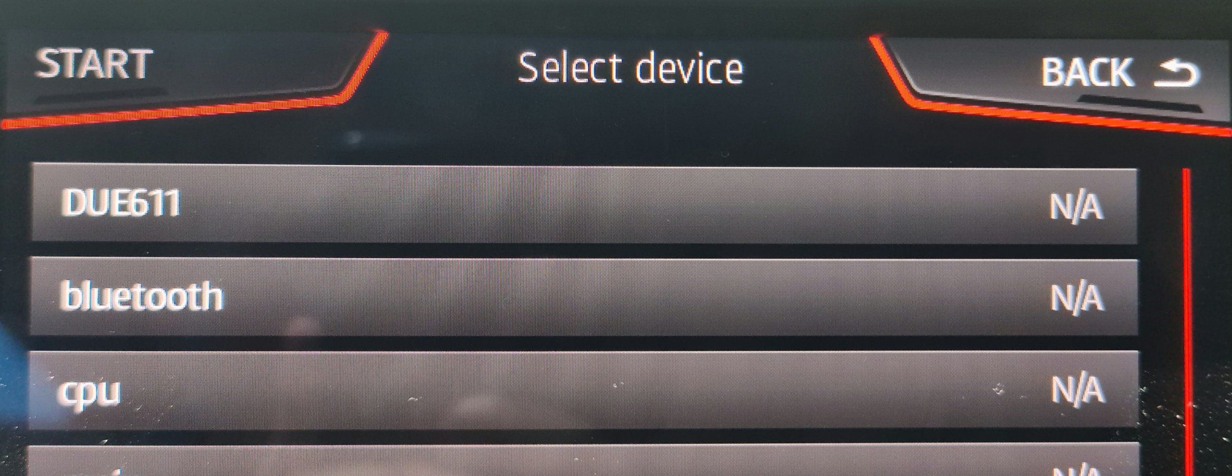

Everything but still have a problem my start button is grayed out and Everything is in NA state
i changed sd cards still the same

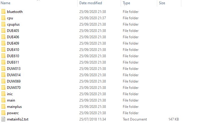

Don't extract to the card, extract to a folder, enter the folder, enter on the folder that was created while extracting and copy paste all files into the root of the card.
You cannot have everything inside a folder otherwise the car won't recognize the files.
See screenshot attached how your SD card should look like
Reactions: kurac338
I'm an idiot for not thinking about that I'm doing that now and ill keep you updated, thanks to you and to kurac338

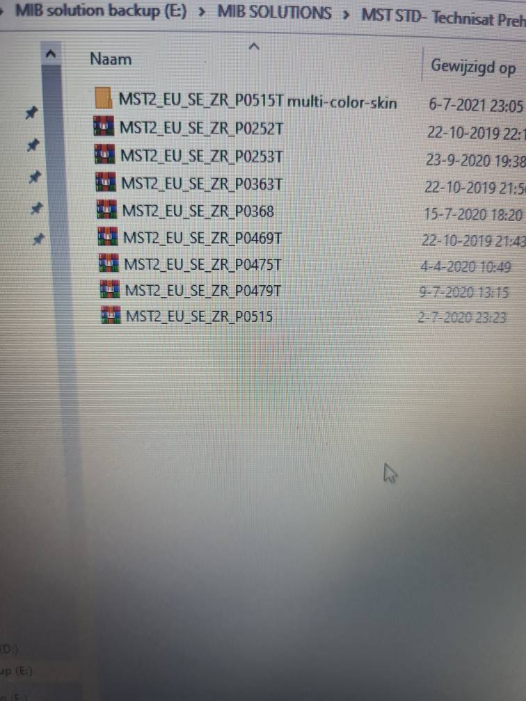

Haha i have about 400gb for mib solution... the fact is why use older version if 0368 is latest? When its patched, and its updated, patch is gone. You should know.

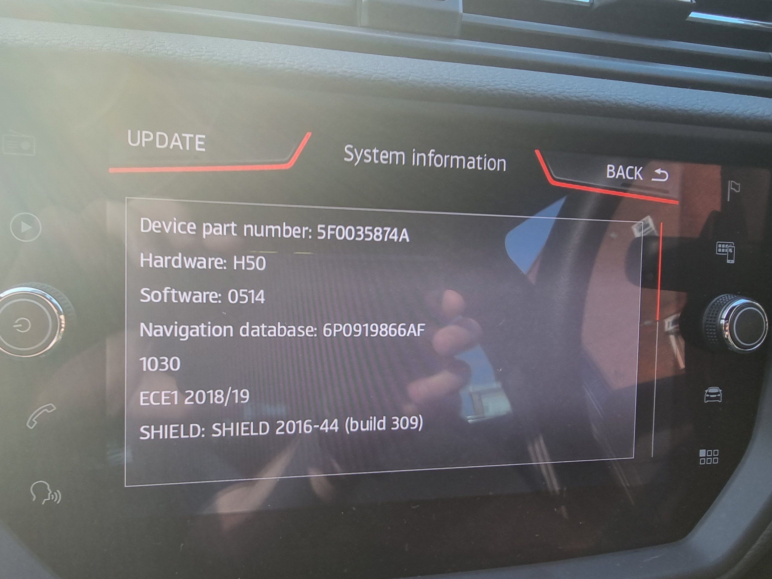

Can someone tell me if there is an update for my unit.
Also how do you update the maps? In the UK do you have to go to a dealer?
