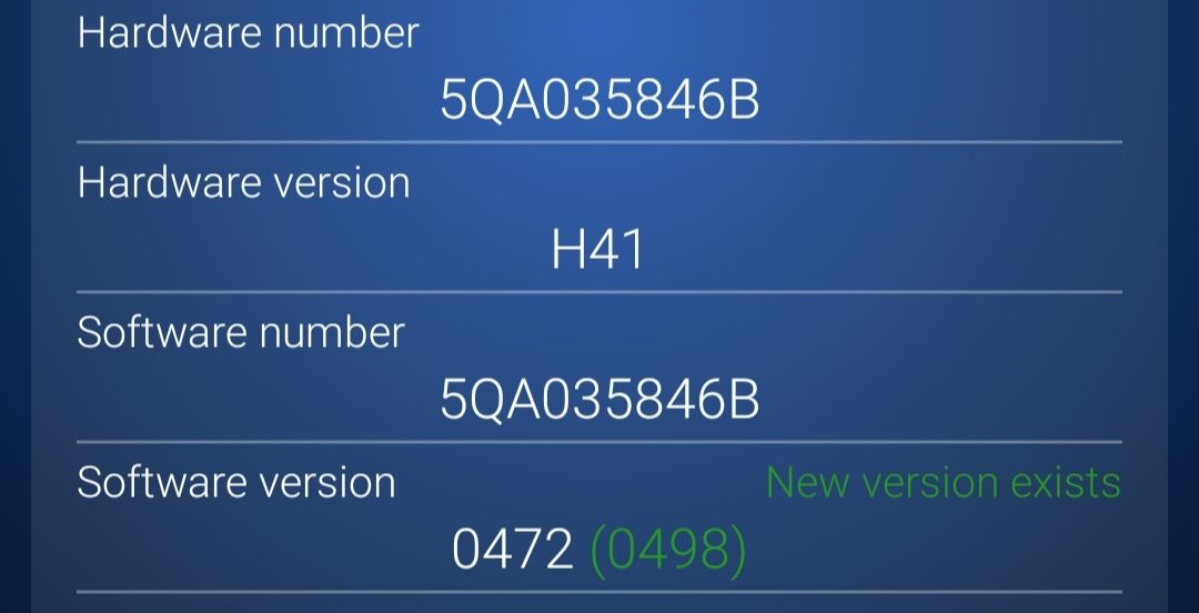

Hello, I want to update my Ibiza 2018 software and my OBDEleven says there's a new software version and it's 0498. I'm on 0472 version and I have the 0479 files (didn't update yet) but I've search for the 0498 files and didn't found any info about it.
Is the 0498 available? Does someone updated to that version or is safest to update to 0479 only?
Sorry for too much questions but I've never updated a car and I don't want to f***k it up 😅
Re-reading the thread on a year past, it's come to pass that the Obdeleven screen that tells you, you have not got the latest copy of the software may just mean you haven't got the latest copy of a hacked one. In this case 0498 being a hack. It happened with the mib2 high 1447 software where there isn't an official release above.
The SLA1 signature check locked down the content of all above from user modification. That was the idea but a useful frig was found where using a POI syntax upload you could upload into the unit without the signature check of everything after the POI signature check although those metacheck tests need to be 're computed so it isn't without work. It's how the mib2 standard and high toolboxes get loaded into the green menu which then use other backdoor techniques to write FeCs.
The technique is being used on the "all in one" (AIO) Mib2 high software across the brands but they keep the release code except in one incident someone didn't. This caused people to start looking for an unofficial release since the signature had been bypassed.
You can check these releases by scrolling down the metainfo2 files looking for the signature and the presence of anything below. If you find code below the signature it's a modified release where they have used the technique to slip under the signature check riding on the back of the POI upload... you don't save anything you look at in these checks since if it's an original, you may enter a character which will mess up the signature check of what is infront of that. That's why it's signed. So you park the file and look at a copy of it if you want to inspect what's in it.
