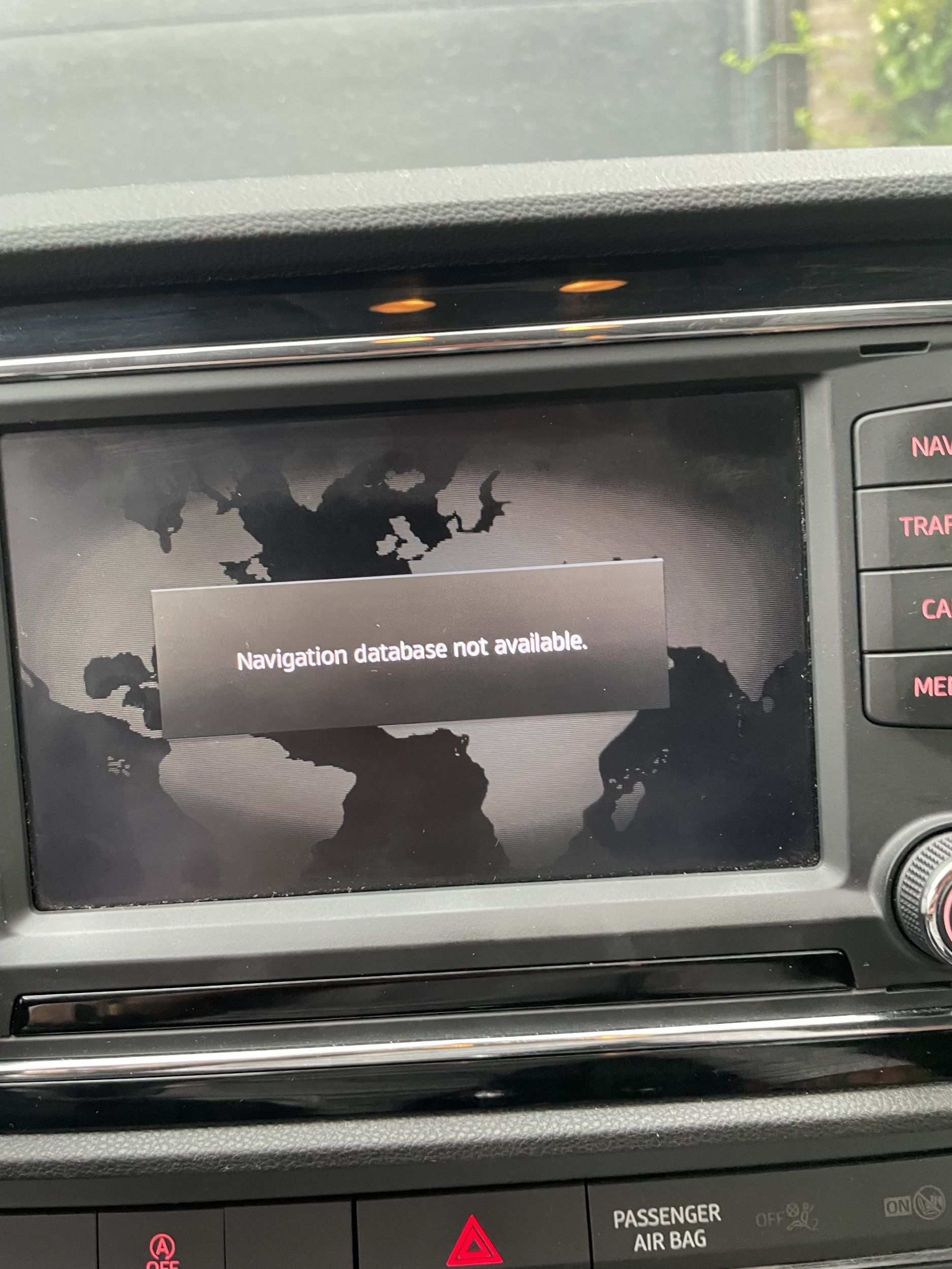

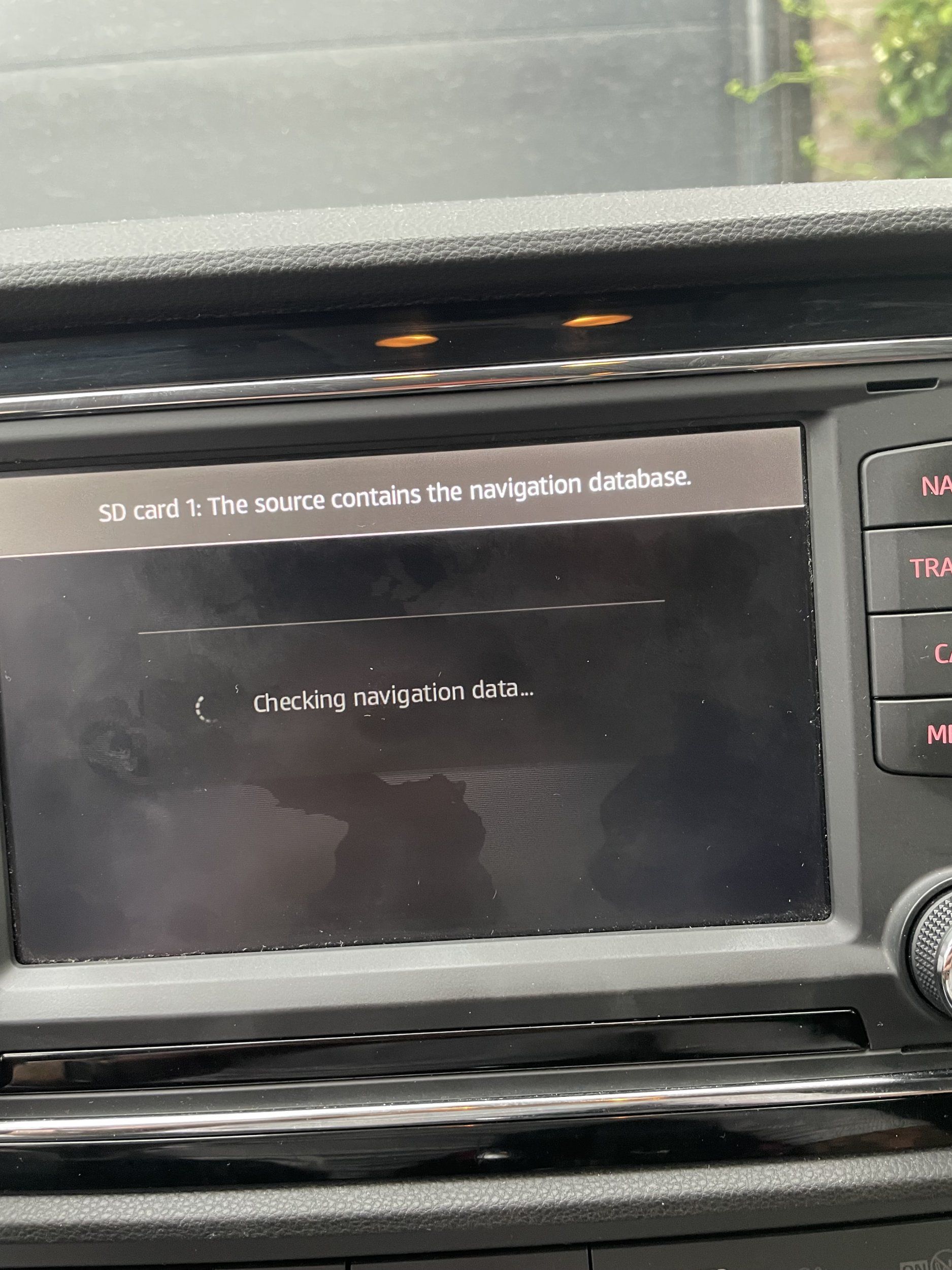

So I installed the update. Unfortunate no change in navigation

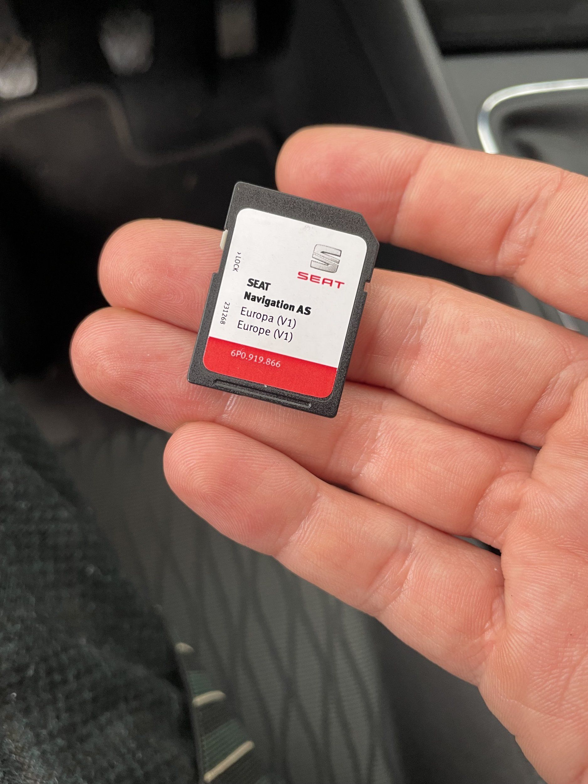

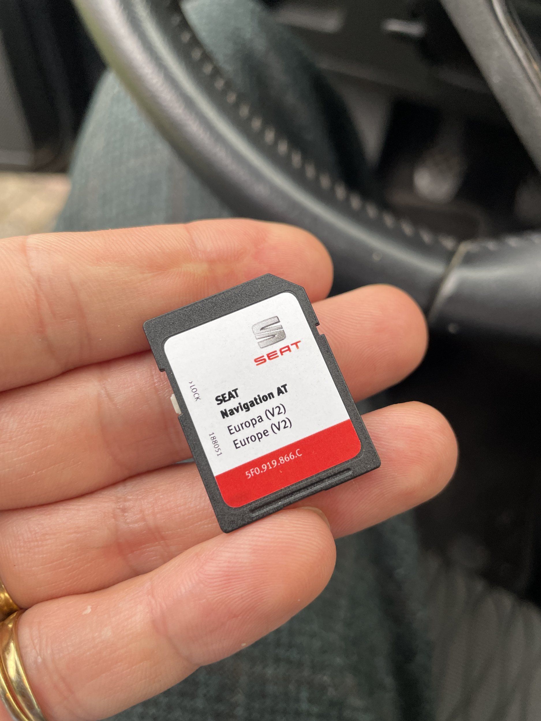

I even found a newer version of the oem in my old mib(1) unit. Also doesn’t do anything. Didn’t even realise I had this.

Everything works, expect the navi… plus I didn’t do a firmware update before now. Only installed the toolbox. Which is ****. I just tried a firmware update in the hope my navigation would work again.

First Picture of SD Card is Not Locked.
But i think it IS not the solution
