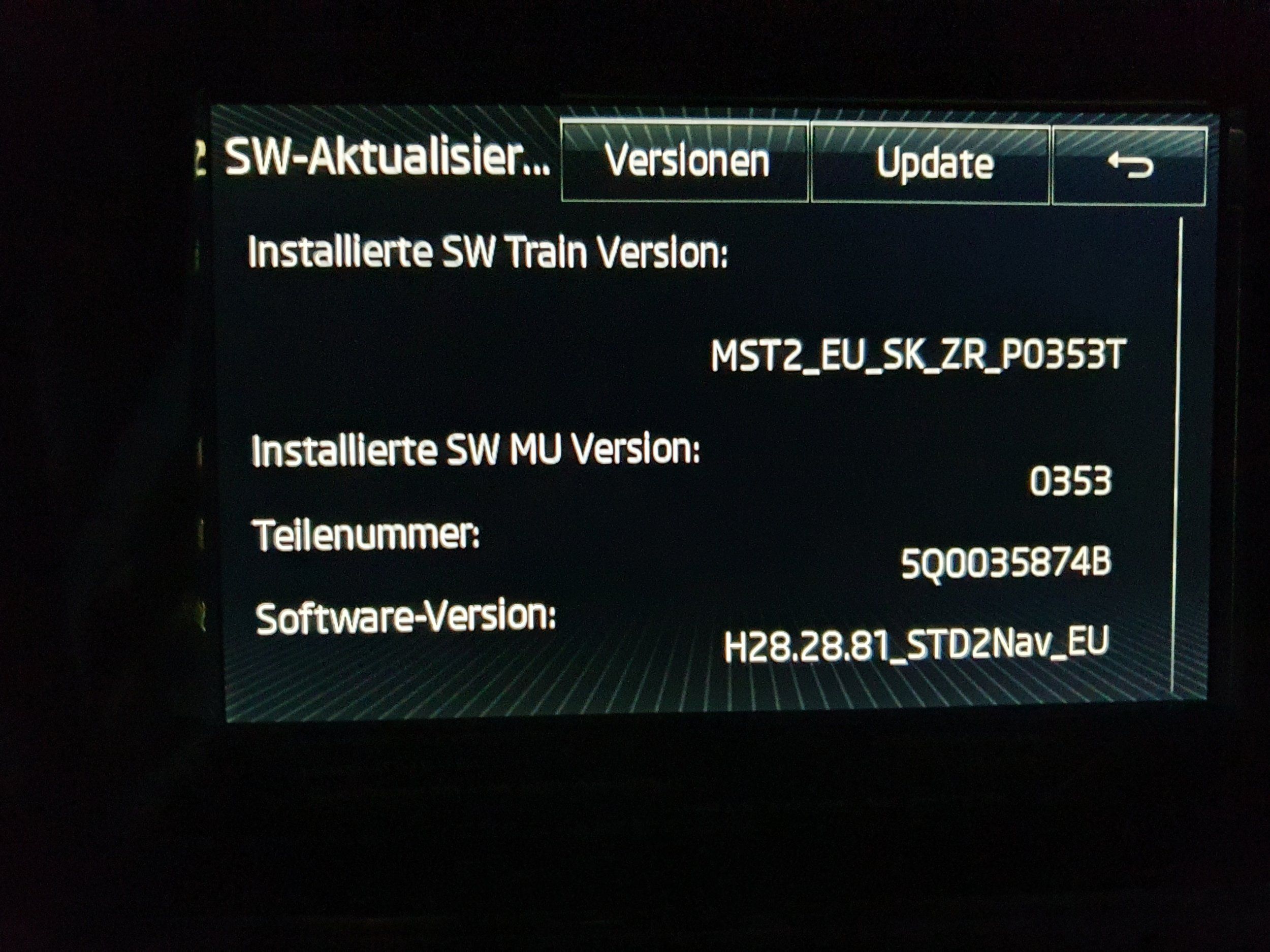

I have a seat alhambra 2016 and I have the same software of this guy:
The device:
Part no. 7N5035680D
Train MST2_EU_SE_PQ_P0351T
SW 0351
SW H.28.28.76_STD2NavPQ_EU
do you think it is possible to have an update of the software? The fact is that my infotainment suddenly starts not to work, it seems like it stops from answering to the controls and keeps going on with the last thing you were listening to…

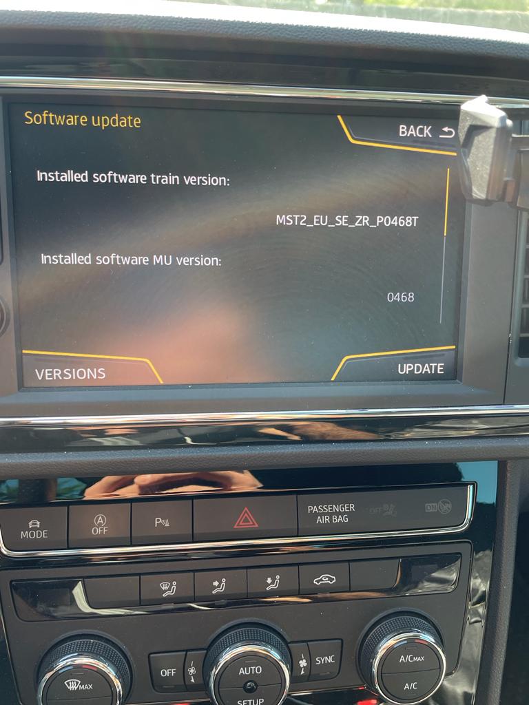

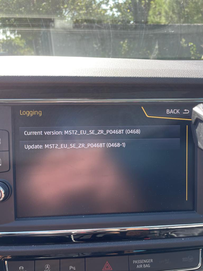

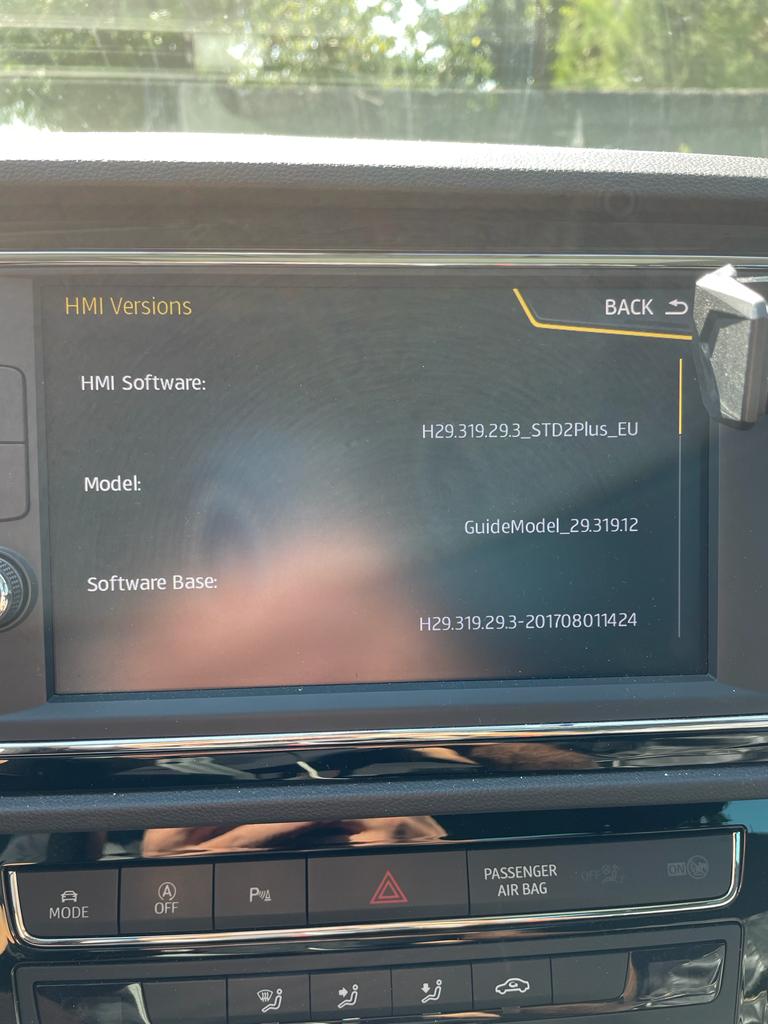

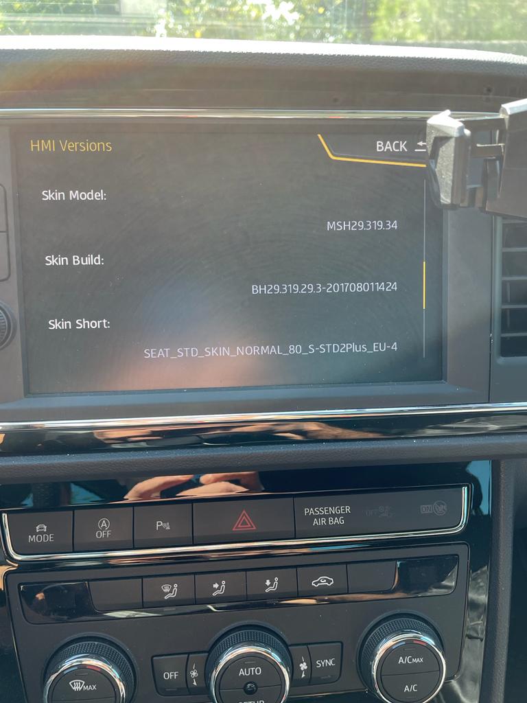

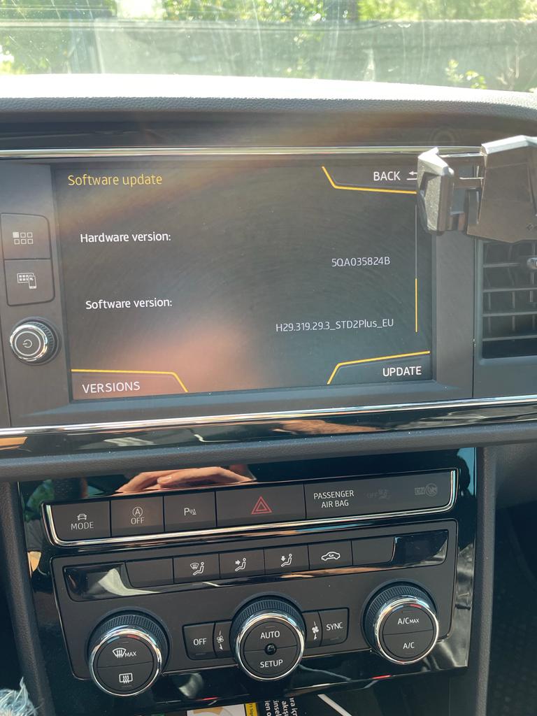

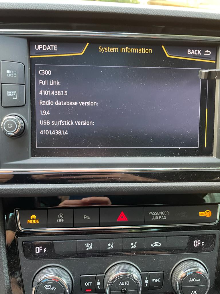

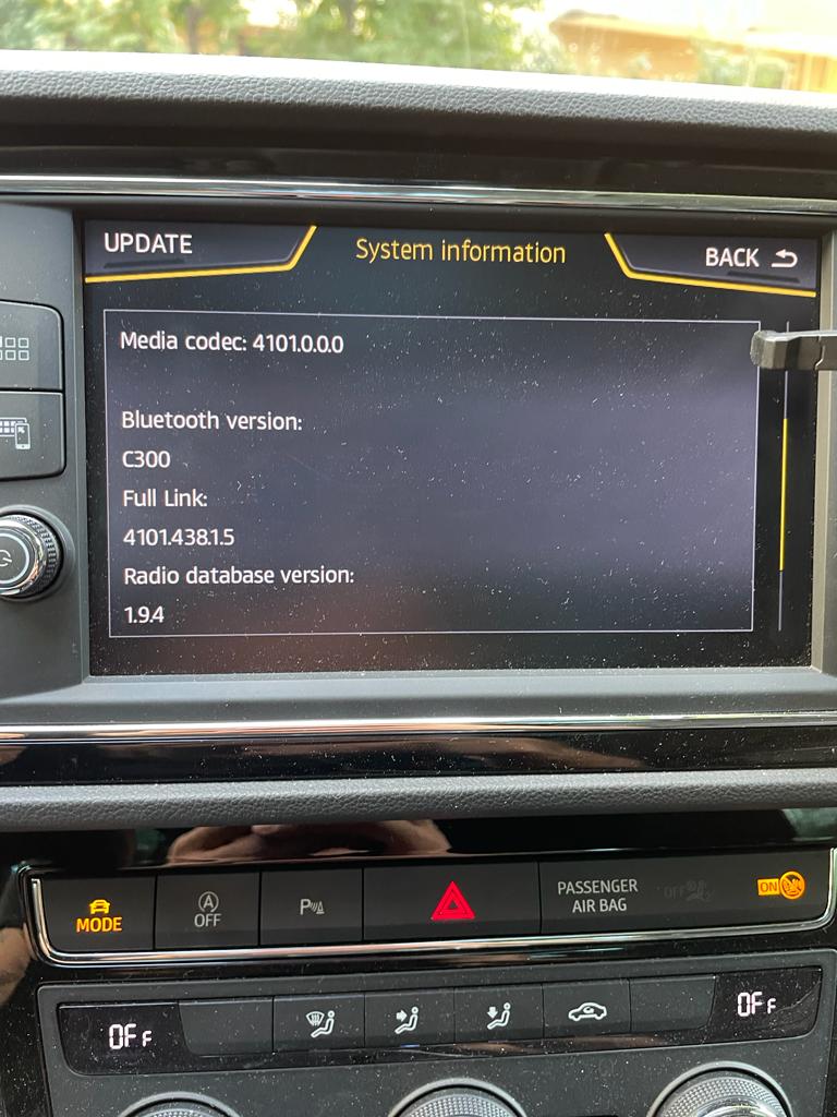

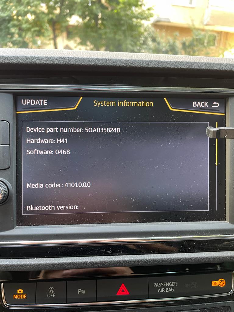

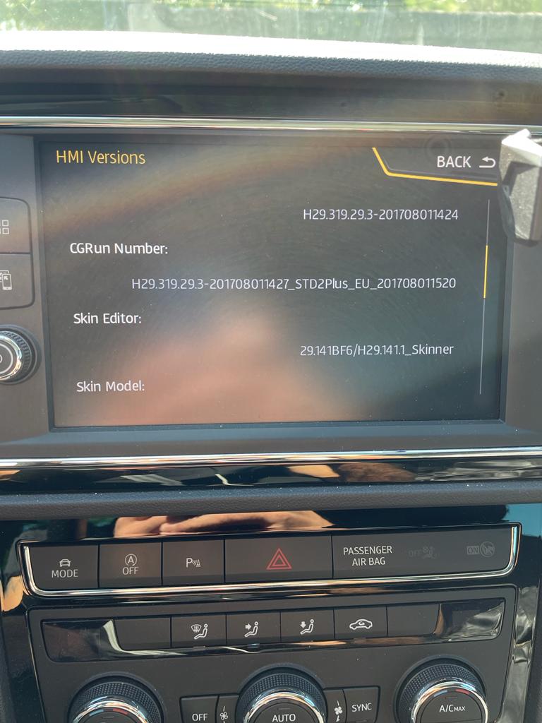

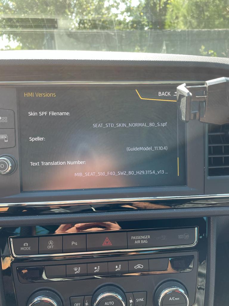

Hello Everyone!
Kind of a newbie here (even though having my 2018 Leon FR 1.4 TSI 125HP) for 4 years.
I just want to double check on something (after excessively reading most of the posts on how to update the infotainment system)
Device Part Number: 5QA035824B
Hardware:H41
Software:0468
Installed Software Train Version: MST2_EU_SE_ZR_P0468T
HMI SOFTWARE: H29.319.29.3_STD2Plus_EU
So the million dollar question is, I'm supposed to download and update this file MST2_EU_SE_ZR_P0479T right?
I've also uploaded the pictures of the infotainment system.

Hello Everyone!
Hardware:H41
Software:0468
If it hasn't been fiddled with already to change its train to 4*. See what others say. I fell into the trap last time that someone had a fiddled box. Once fiddled off the train a standard mib2 can't continue on that train without more fiddling. It's just not a normal update. It was spotted by the part number.
Reactions: dukefb
Well I bought the car brand new back in 2018, so I haven’t fiddled with it.
But I don’t know if any updates were done to it while it was being serviced at the Seat retailer.
Regular Seat service would not change the train from where it originally was. People who wanted the fiddle wanted the tiles display rather than the rotating panels. Pretty sure yours is 4* by the date so I don't reckon you will be hit by that issue. Give it time, I'll be jumped on if I'm telling you wrong, but 99.9999% sure you are OK.
Reactions: dukefb
Thank you a lot for your help ?
