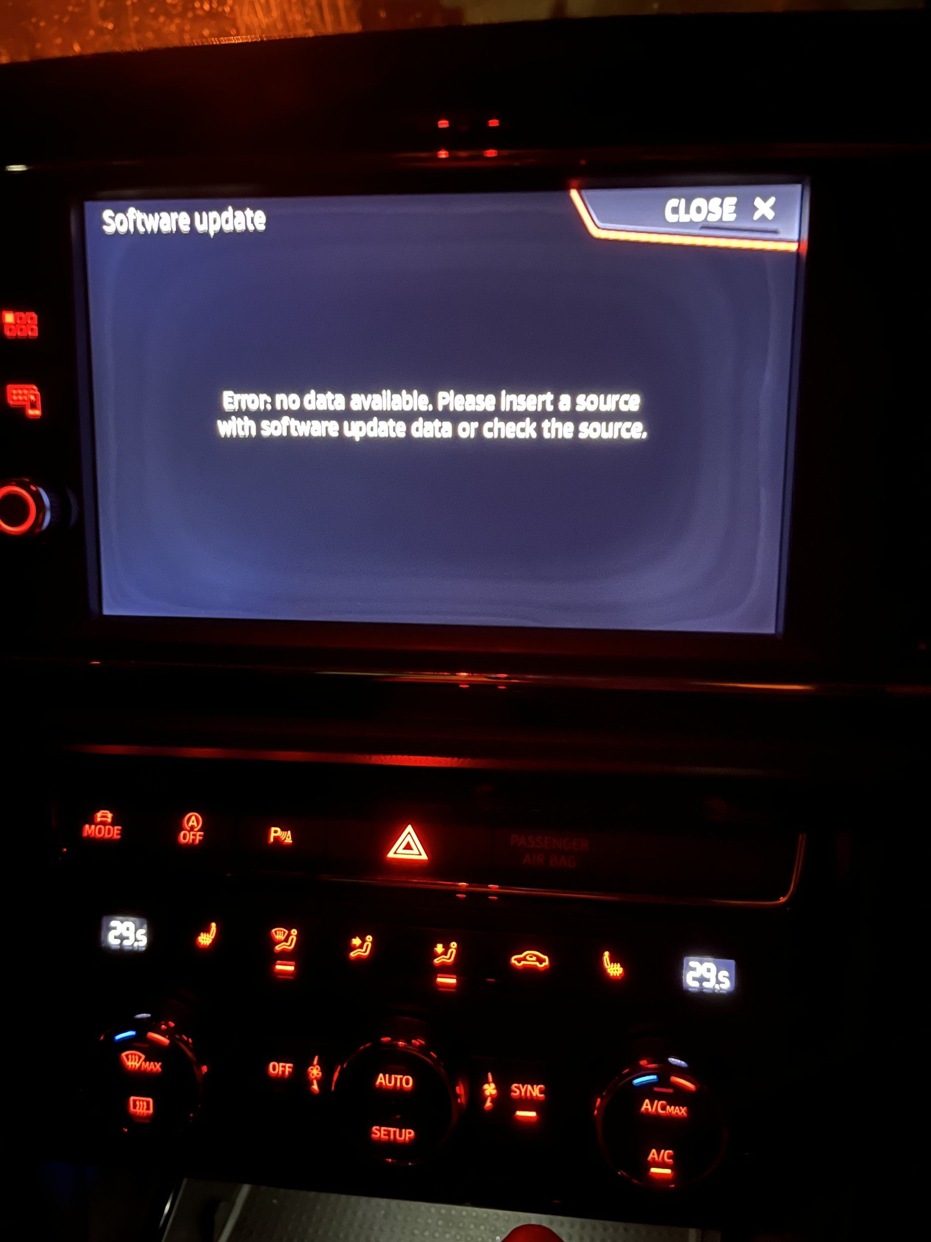

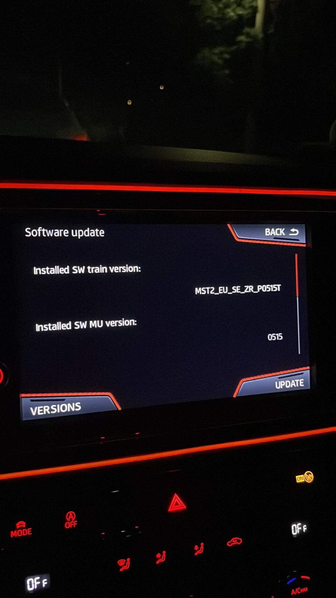

I have a problem, I wanted to update the modified firmware because of the full link. And at the moment my infotainment lights up with the seat logo and can't move any further, can it be reset or unblocked somehow? my version MST2_EU_SE_ZR_P0351T
and I put the modified firmware from the site
https://mibsolution.one/#/1/9/MST2 ...SEAT_ZR/MST2_EU_SE_ZR_P0515T multi-color-skin
I don't know what to do next? please advise

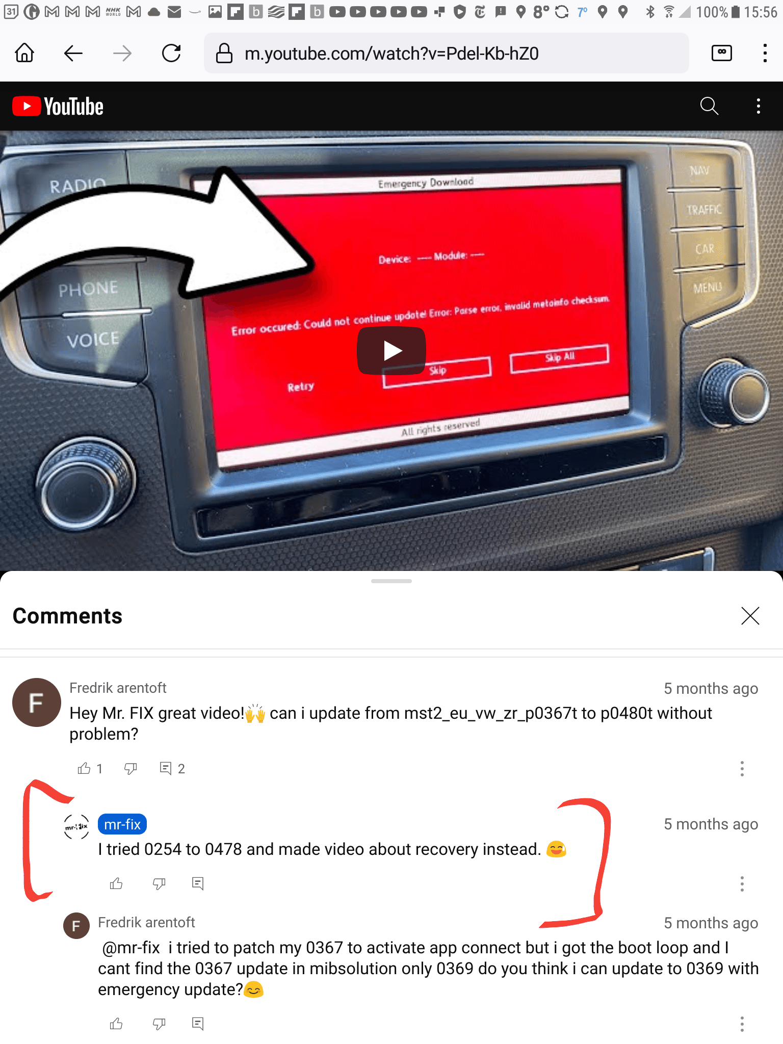

Anybody have a DIY solution for @nutelacamp nut
I offered up this video I found on a Google to @nutelacamp
Reading thru the comments Mr Fixit bricked it when making a video on the upgrade you shouldn't do in this comment... well trodden route.
Leave it to you guys.
Also appears on this thread
We can summoned up @Chillout one of the long time experts on Mib2 but suspect it's difficult going if not into programming and electronics.
It's the associate of East Yorkshire Retrofit that has dug UK people out of this hole in the past, that's Ryan by sending the equipment off for repair to him.
They work together. The golden rule on a mib2 standard (the one with the map card) is don't update the firmware across "trains". Train denoted by the first character of the firmware code. Never update from X* to Y*, X* to X* is fine. 2* to 5* etc will mess up your unit. That's across trains.
so I found a person who will restore the firmware for me without any problems and he wrote to me that he can upgrade my MST2_EU_SE_ZR_P0351T to MST2_EU_SE_ZR_P0516T and activate Fulllink, sport menu, voice amplifier, lifetime maps. So I say to myself, well, I'm going to do it! I also found a used functional unit from a wrecked seat leon, which I would have to upgrade again, so I can do some simple interventions, but complicated restorations, programming a chip or making a USB connecting cable with a PC is difficult for me, but thanks for the information, it should be here give a procedure on how to properly upgrade the firmware, because searching for a procedure is quite demanding and I made a mistake anyway!
It's been repeatedly said of recent on the thread don't change mib2 standard trains since you can't. There are specialist mods that change trains but that isn't stock software. You can't do it with stock software. Once on a mod train you can't change it yourself again, but given you are planning to be on 516, it is likely to be last release you would want in anycase. That is problem we have had in the past guy on non stock software that then get in a state by trying to update the software again.... and not mentioning they are on modified software when asking for advice.

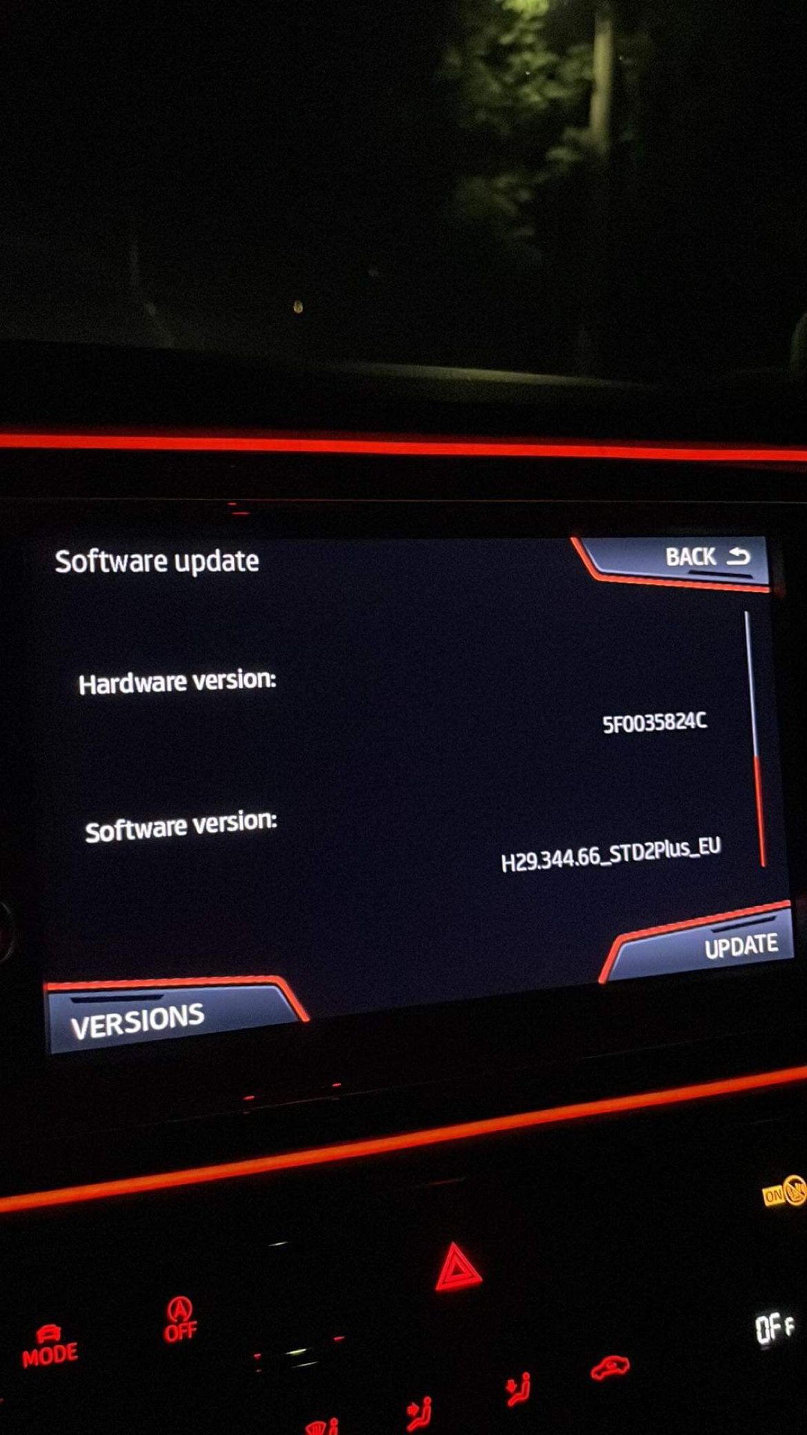

hi all i have ibiza 2016 with msT2_EU_se_zr_p0245t firmware what is the best firmware to safely install it , on mib2 site there MST2_EU_SE_ZR_P0479T , some says that if you on 2xx and going to 4xx u may brick your computer
Don't change trains stay on the 2* train. Any software fixes are on that train you are on. Only mib2 high it appears you can jump trains as reported on the thread with the 1447 AIO. You have a mib2 standard. There are retrofitters that can change the trains but it's not generally DIY unless anyone knows better.
The site has a slightly newer, and safer, update for you which is MST2_EU_SE_ZR_P0253T_MU0253.

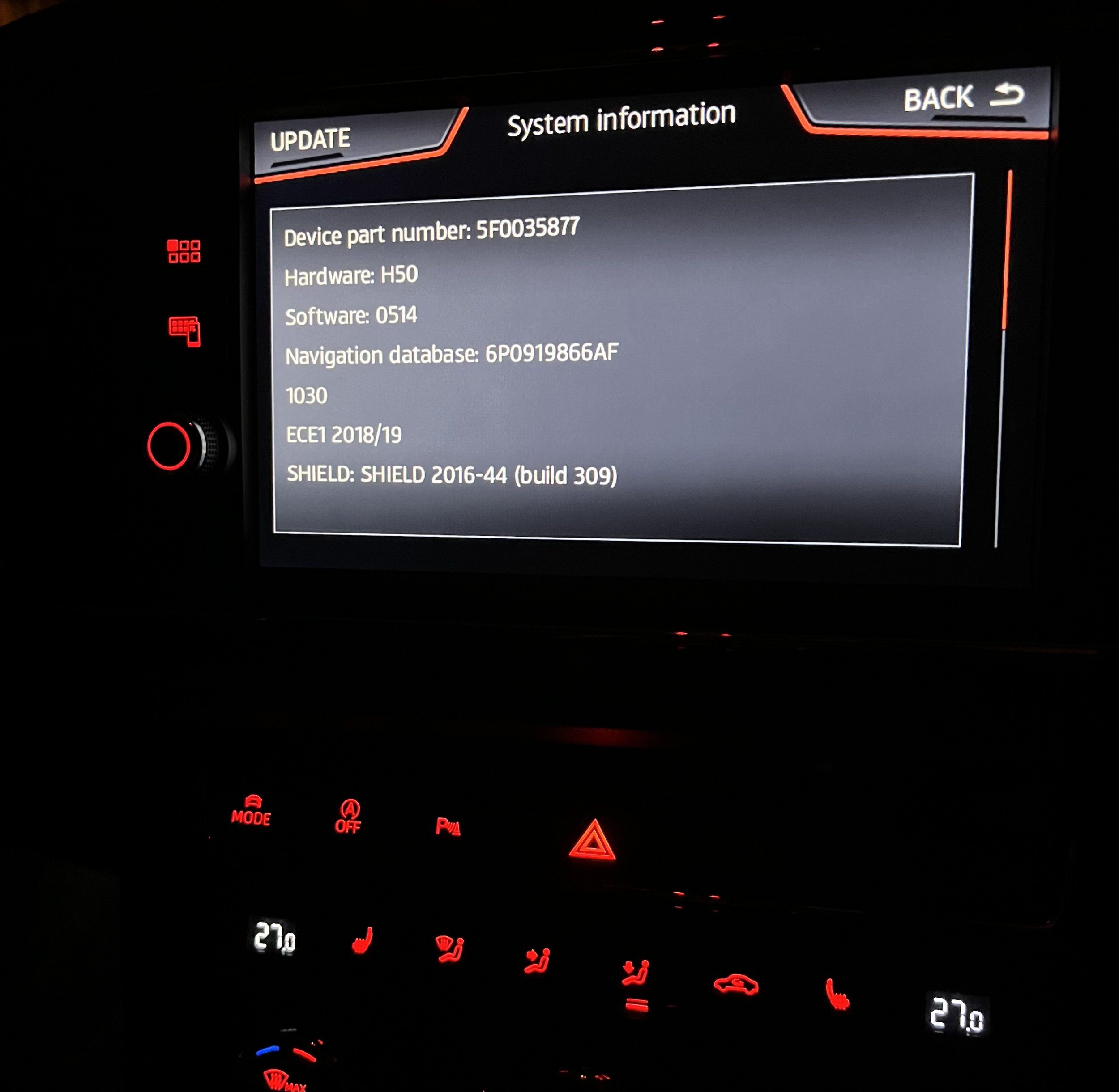

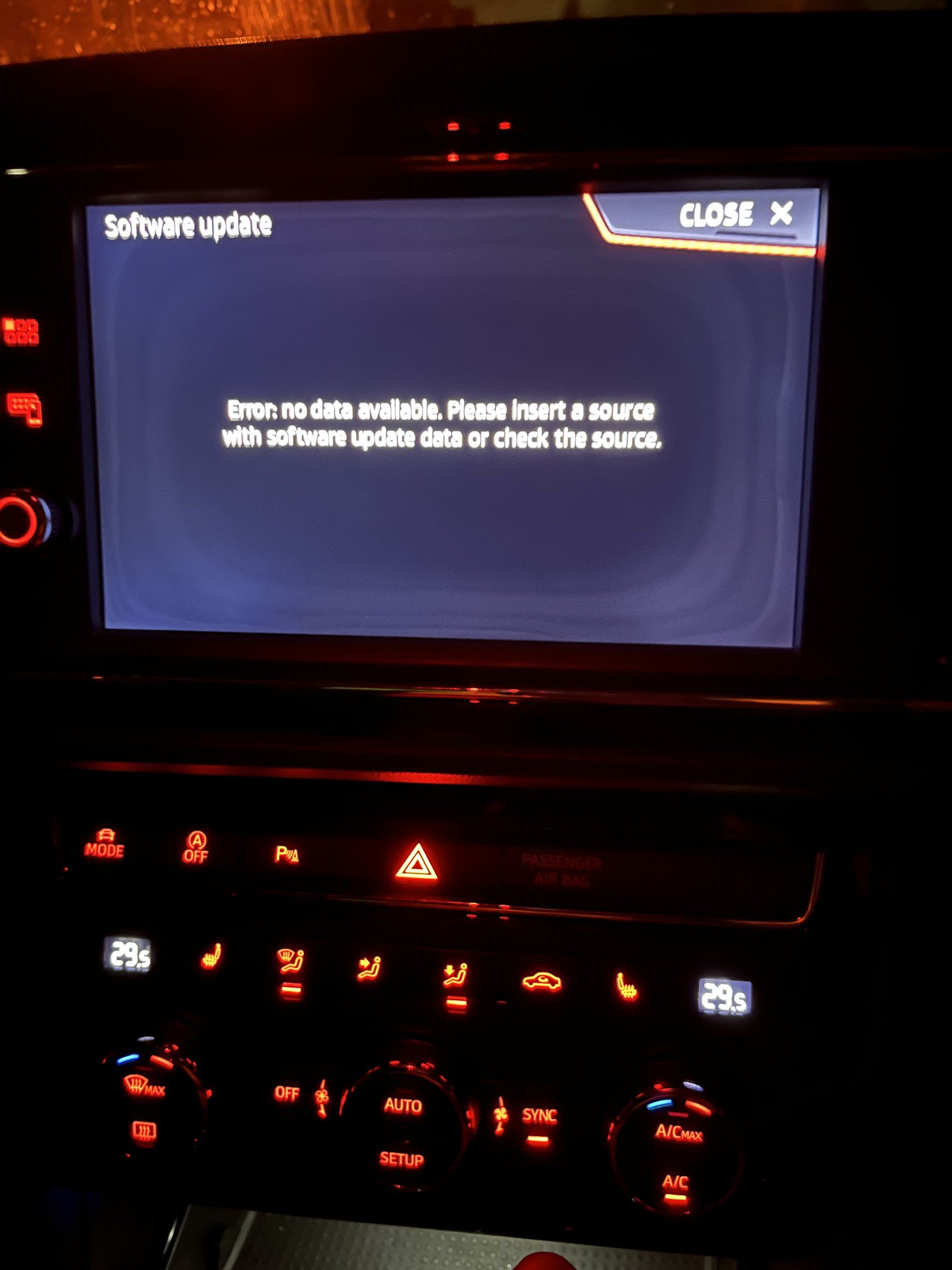

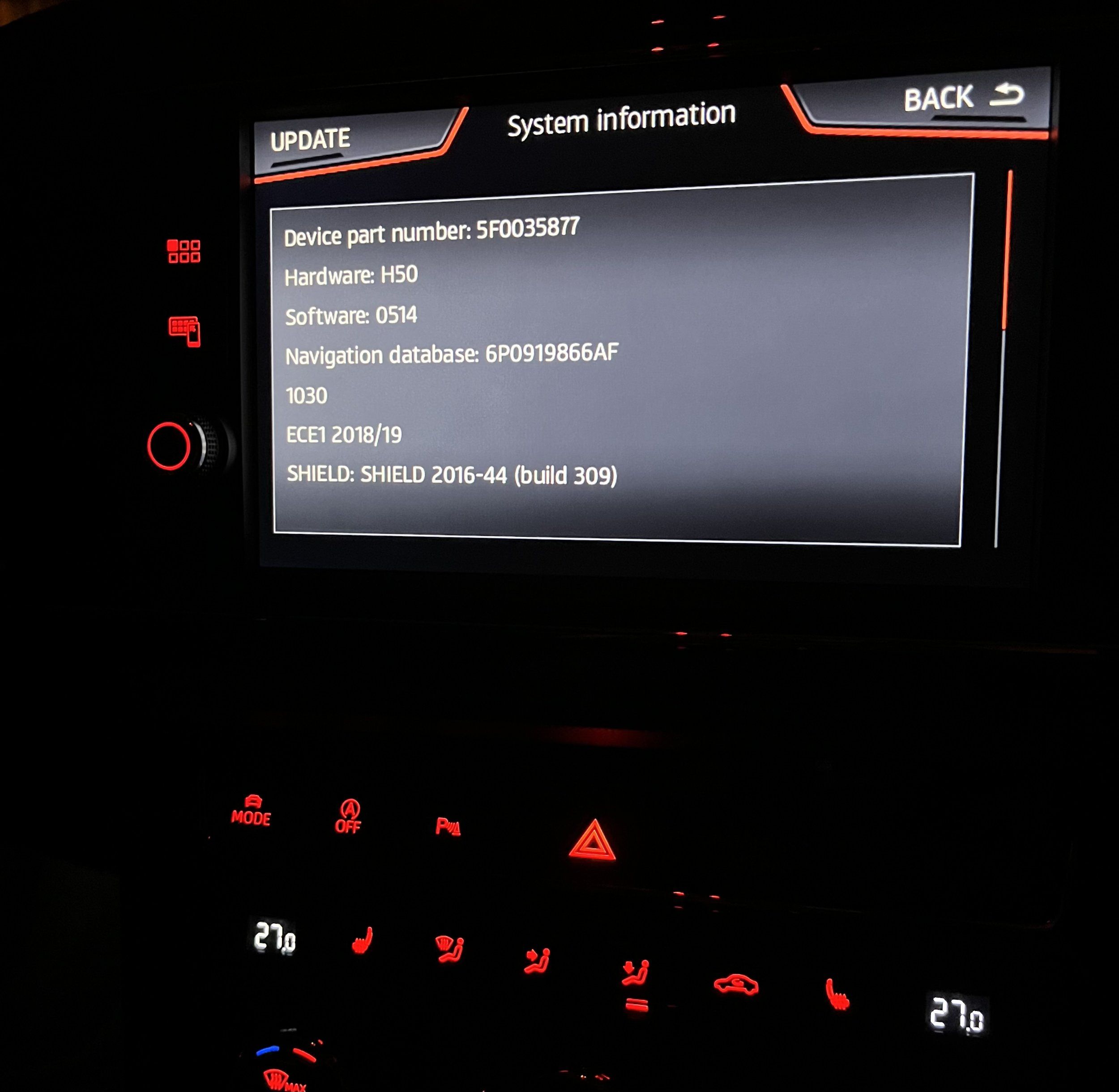

Can I just check if I’m running the latest firmware for my MIB?
I know my maps are due an update.
Also having issues trying to add speed camera POI to my system.
Have tried both a USB and SD Card both formatted and extracted the POI files from:
But keep getting error, when going to manage memory and trying to update. It doesn’t recognise the files

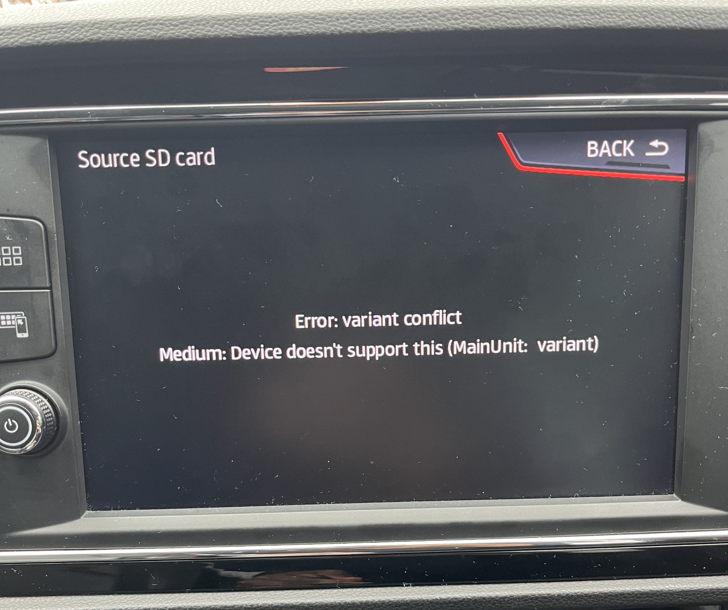

also tried doing long press menu button and update, it says variant conflict.
Unsure why as when I put the SD card in it says updates available.

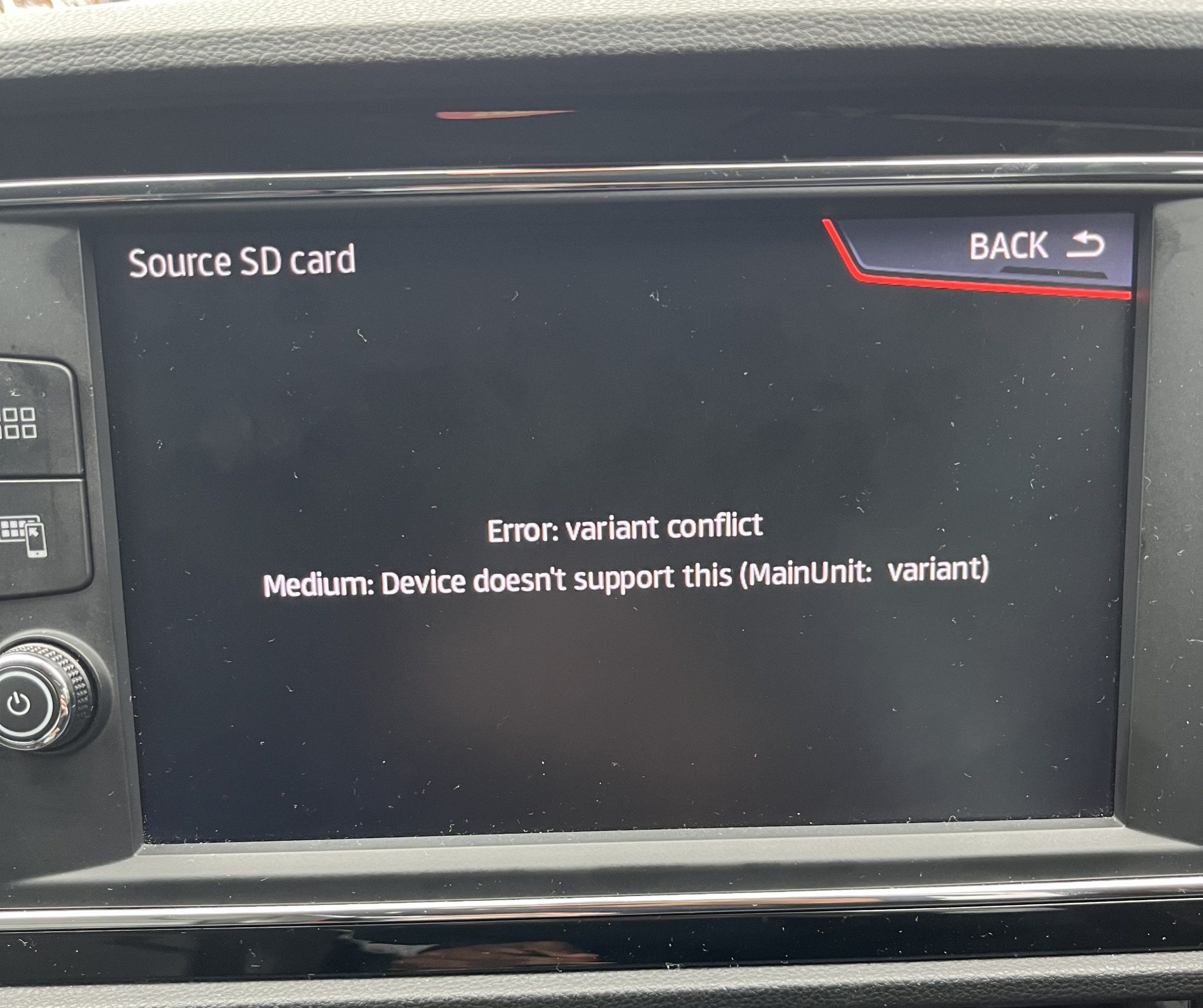

View attachment 35007View attachment 35007
There is the 516 firmware available on the mibsolution board
mibsolution.one
guest, guest
That's run by mib enthusiasts that collect up the material. Unless you are experiencing issues I wouldn't bother.
It can be a high risk thing on the firmware.
On POIs I've answered your question on the other thread:
That I'd say is your freeware mib2 poi file not being updated for the newer hardware. Not always something for nothing.
On map updates we have a resource and thread:
Latest above for the mib2 standard which is what yours is. You must follow the workaround to do the update, just don't go deleting the contents of the SD card without taking a copy of it. All explained.
