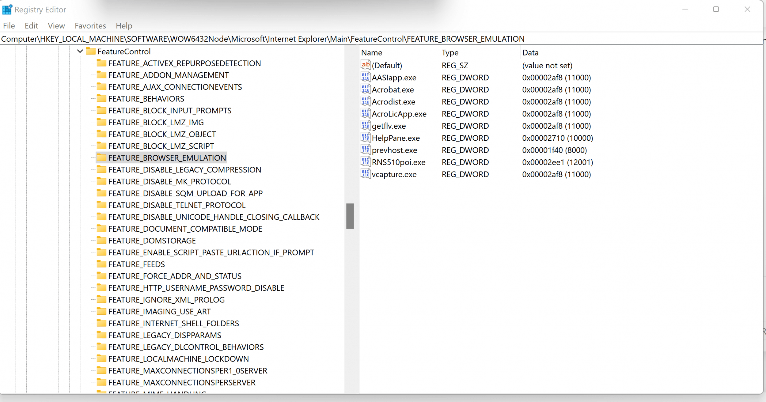

Note the curse of Microsoft strikes again in so far as the maps within Poinspector stopped working as they changed something. The programmer has published a fix:
Register edit with much care and it's working again. :footysup: (whilst the program will work without the fix you get the maps back again with the fix on the PC for visual checking before the import. Regedit can wreck your PC boot if you make a mistake so be careful, you then reboot your PC and the programme works again as designed).
You can carefully find the right key area to edit it in, it may be in a slightly different path based on the Windows release. I couldn't see how the "run this patch" worked so did the edit myself carefully finding the right path to put it in. Google is your friend as always on opening regedit etc.
Example of my finished edit:
The fix from the website:
Google maps fix/workaround
Workaround to fix IE compatibility for built-in app map feature.
Open registry editor (regedit) and browse for the key:
HKEY_LOCAL_MACHINE\SOFTWARE\WOW6432Node\Microsoft\Internet Explorer\Main\FeatureControl\FEATURE_BROWSER_EMULATION
Under this key create new value:
"RNS510poi.exe"=dword:00002ee1
Or simply download and run this patch which do the steps above.
Now you can run again program RNS510poi.exe with map feature!

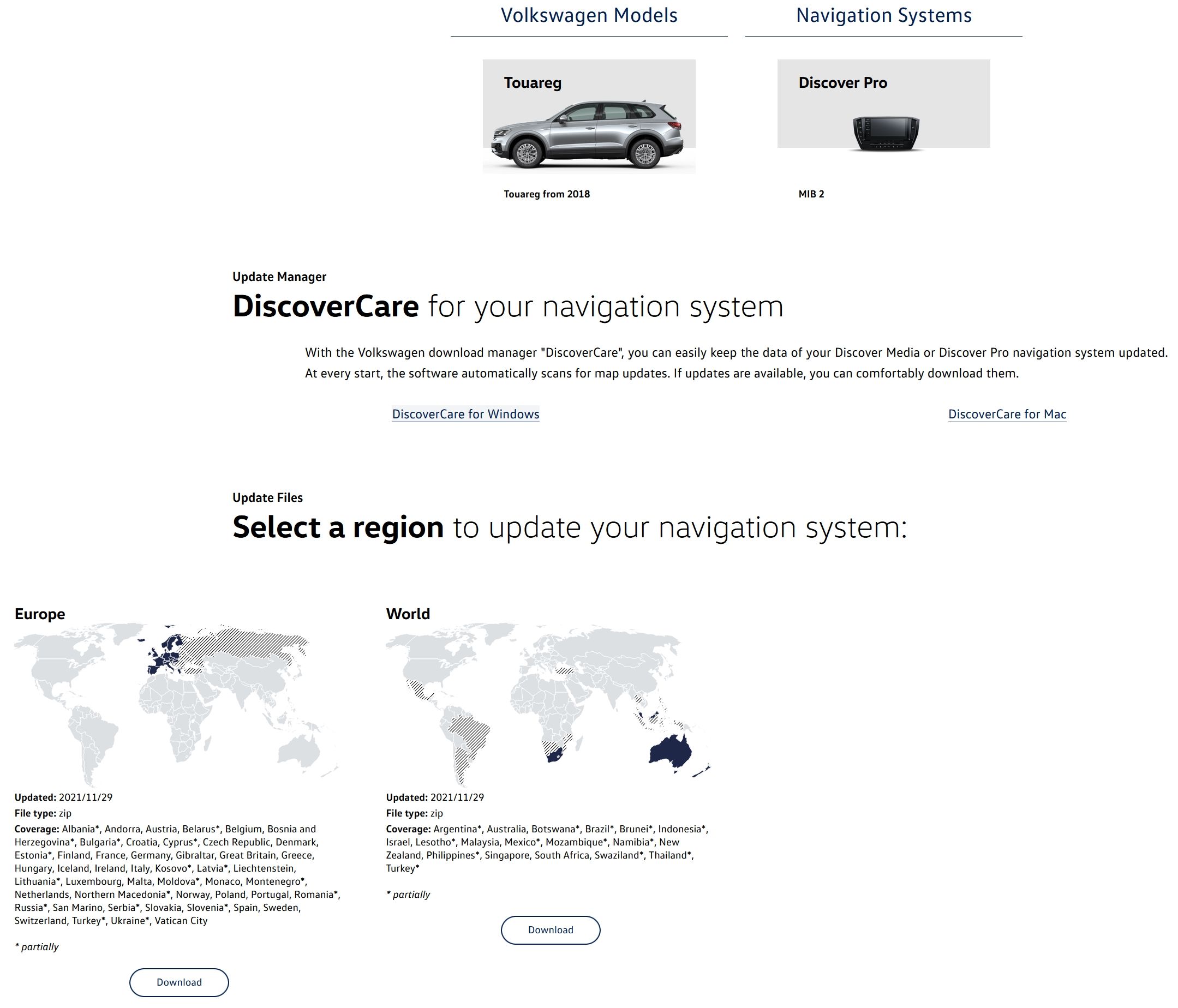

One of the first things I did after getting the car was check for a map update on that very website. There was only one Touareg option, "Touareg from 2018" which I selected after which there were two options, "Discover Pro" and "Discover Premium" so I selected "Discover Pro" then downloaded the Europe map which was in a ZIP file named "P0520_MIB2P_EU" which was 27.4 GB when extracted. Attached is a screen capture and the graphic of the Discover Pro head unit to the right which is the same as that in my car and labelled MIB2. The map installation worked without problems so at that time I believed that the head unit is a MIB2.
Perhaps you have a half way system which isnt called mib3 but isn't mib2. Incorrectly documented. The map code P0520_MIB2P_EU isn't a mib2 high map code. We are currently at 195.
If you have the download and it was mib2 high then it will open up into two directories mib1 and mib2 if it's a mib2 high. If you download the mib3 ones off that site you will see they are very different. Suspects yours looks like that.
Also with mib3 they ditched the POI import option off the screens. Which you have missing as well.
There are only two folders within the map PO520_MIB2P_EU folder after extraction, Data and Meta, both of which have many subfolders of corresponding names, which are Eggnog, NavDB, Truffles and VDE folders, several of each for each country. No MIB1 and MIB2 so from what you say it does look like a MIB3 structure.

That's mib3. The components blobs of files I believe are the component parts that get downloaded as you request a destination across zones that need to be updated during an online in car update. They are the zones.
