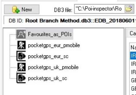

If PocketGPSWorld goes under I'll know where to go. That one I had on recommendation... something that Skoda people use ;). Crowd sourced observations. Think sometimes they have mobile cameras miss classified as fixed cameras in it. Mobile ones are suppose to come up for review, miss classified they don't. You can report ones that dont exist to get them removed. There seems to be a fair amount of misclassification ones, but saying that it does pick up and warn where mobile speed checks are pretty regular even thou they have been put in as fixed cameras. I'm generally not bothered by an element of misclassification. You get a free newsletter as well.
Once you get the frame work set up in Poinspector and remember to delete the data and not the category it's pretty easy. I update quarterly or so, or long journeys and destinations much more frequently.

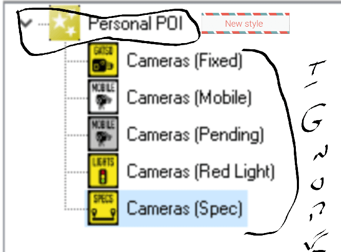

This bit
It is important to construct the category sets as siblings hanging off the root as shown above for the Discover infotainment unit - top left tree structure. Discover infotainment unit only handles siblings on the route and nothing else.
The graphic looks slightly different now but still true. The previous RNS units allowed you much more structure but mib2 doesn't which is why you can't get carried away nesting branches. To support RNS units for backwards comparability Radas the programmer kept the feature in it, but it won't work with mib2 just parent and sibling in one group below.
At this point I added this text to this image:
(Nb. Revised screen is slightly different to the image above, you select between standard and high).
Looking at the ribbing text in the thread Radas tools now give you this:
So it hangs from there now and where I've written ignore that's where my stuff would be. You need to get the relationships looking like that ✔.

Just to be clear, my POI tree structure has to be Sibblings like this:-

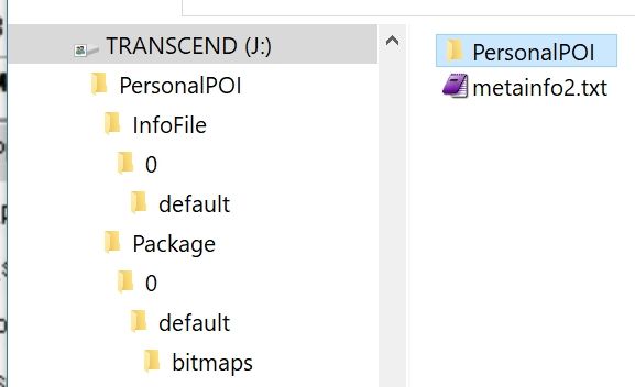

And the SD Card / USB Stick structure should end up like this:-
