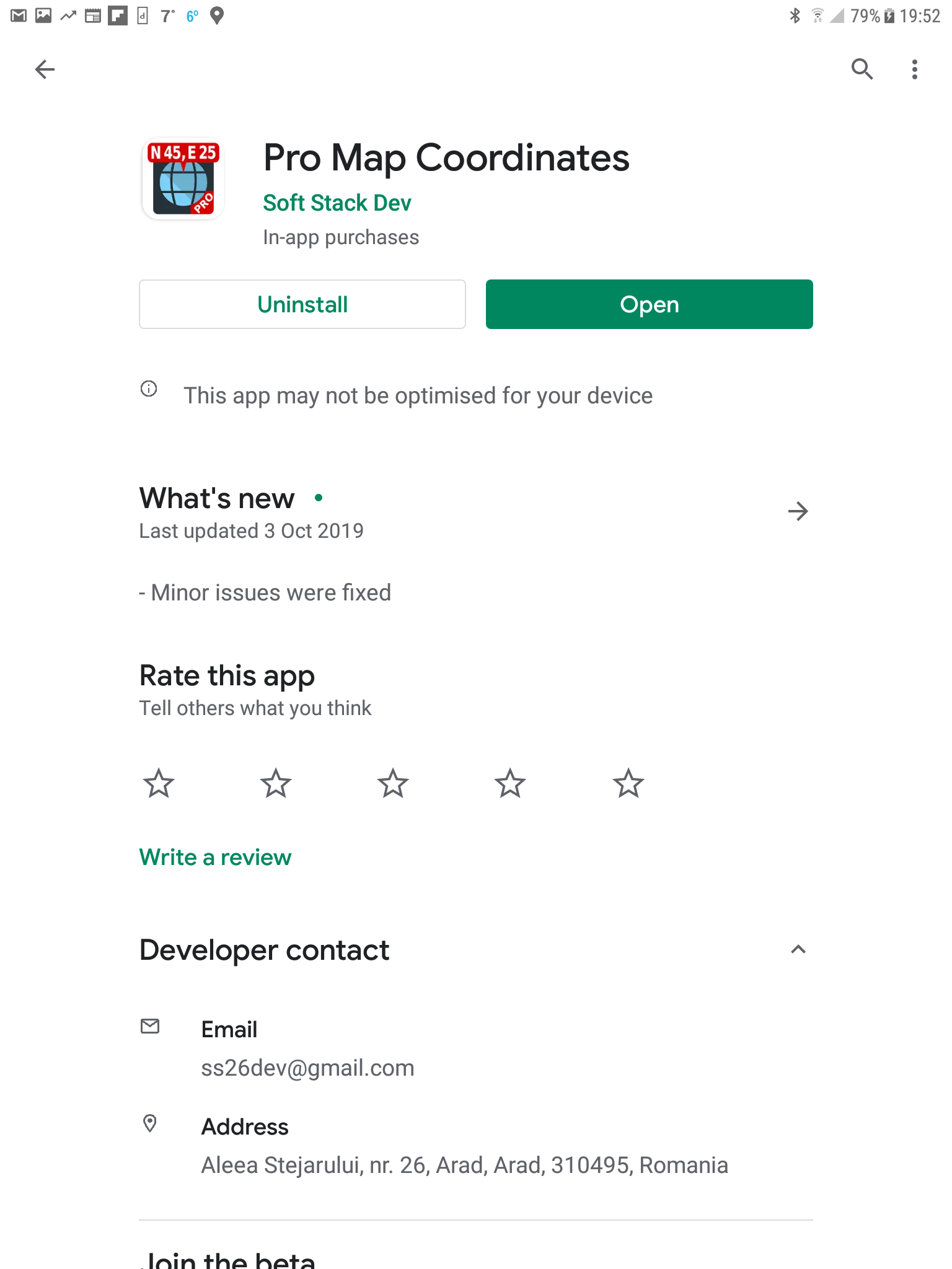

I use Poinspector it to get the speed cameras in and frequent destinations for hikes etc where you pick off the Poi and save as a destination - an old Skoda trick I was told about - slightly bizarre but turns the screen into a traditional GPS view of favourite destinations and populates the destination menu. Use Android app N45, E25 for the coordinates which gives peaky boos to Google Street View, access to Google Maps and Openstreet maps (Good for outdoor activities) where you want exact precision to destinations) and gives you decimal degree coordinates as well as the cars DMS On Map input. So it covers all bases. They are the ones I input as favourites as POIs but note as I said the input is in reverse order to normal coordinates,
x,y
need
y,x
and in decimal form.
That's only if you want to run with speed cameras and favourite destinations.
