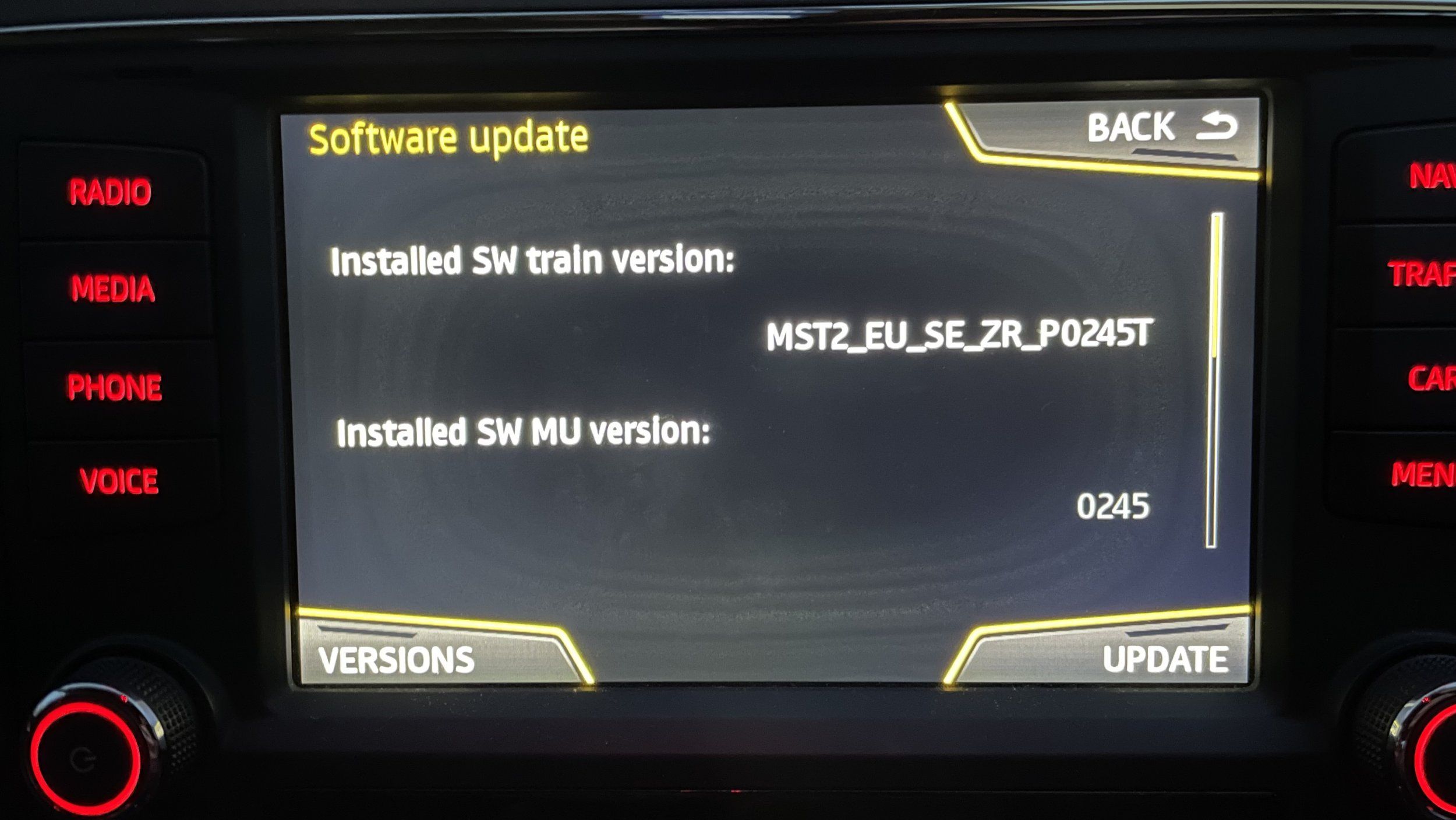

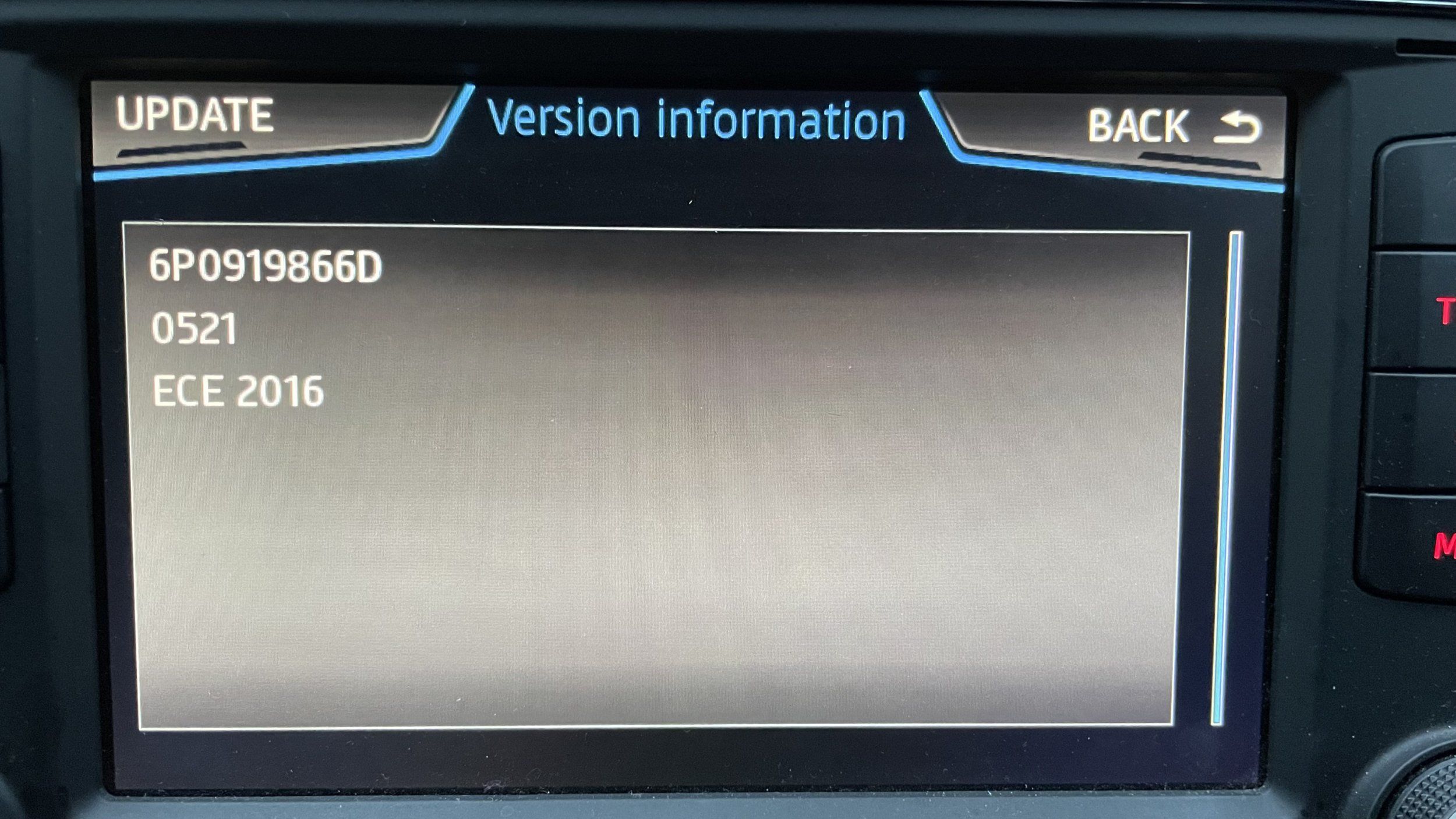

I have 2016 Leon FR, and the maps and software are outdated.
Can someone point me in the direction of how to update the maps and software if required?
Any advantage in updating the software from 0245?
I've attached photos.
Cheers
Cheers
As far as the maps are concerned I gave a recent reply here with links:
In their case they didn't have the card, in your case you have it, so read from there, follow the links.
Start reading from the first link and then follow on:
Serial release 2010 is the latest release. You'll see the link. Be aware of what I said about not deleting the card. To use that card you will have to use one of the zoned areas since all of Europe doesn't fit on them. With a new card 32gb if you need all of Europe you use the "workaround" as detailed.
As far as firmware is concerned stay on the 2* releases, see above for discussion. You can damage the unit if you migrate onto another train your self. 3* etc is another train, train being the leading number. That discussion above on this thread.
Others can comment on the firmware update. As far as the maps are concerned roads are always being built. Toll roads and bridges changed. The mib2 standard which you have uses TomTom cartography. Mib2high Here Maps, ditto mib3. If you follow the links in the resource I give you the websites where you can report and add map alterations in these two systems. They do take these on-board. Whilst people like to think Google is definitive it isn't always the case. I've seen housing estates left off Google Maps for years.

hello, the SW won't move far 245, I don't know which is the latest version, but you personally can do a max update from 200 - 299 with SD or USB, you can't do more than that, you have to contact a programmer who will overwrite the entire memory of the multimedia system in a complicated way for me and upload there are also other versions like 3xx, 4xx, 5xx, I think the last one was 512, you can't do it yourself, you need professional help, try some bazaars or something about cars where these services are offered by programmers

The last one is 516 but inadvisable to jump trains on the standard unit more experts here than me. Goes on a work bench usb / Ethernet adaptor, crack the password etc. So many wrinkles. The boards retrofitter sponsor offers a service. Also a service to put right what people mess up. Best not to mess it up by trying to move off the train or find someone professional to do it. The USB also needs changjng in some instances to get car play to work... again more experts than me on this one. People see the tiled screen and want it, Seat / VW / Skoda didn't provide an update route to that for dealers just the within train ones found on the mibsolution web site.... although there are other things there that aren't the original but custom ones. @MIB-Wiki is the head librarian for that site and I'm sure knows the collection.

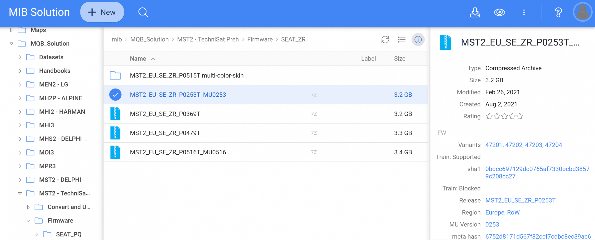

Thanks for the replies, if I wanted to update from 0245 to 0253 which files should I be downloading from mibsolution? There are lots and I don't want to grab the wrong one.

It must have an SE in it for Seat, not SK for Skoda and finish with a T for production if not it's modified for something or other. The 253 isn't jumping out at me at the minute.
There is this
Possible but don't blame me, not sure why it has _MU0253 on the end of it but does show as MST2_EU_SE_ZR_P0253T .... we need the head librarian .... it's probably fine. MU version is shown as 0253 may be just the way these are filed away.

I think you are right, I've just checked the current version and it shows as MST2_EU_SE_ZR_P0245T, just got to build up the courage now to give it a go :)
