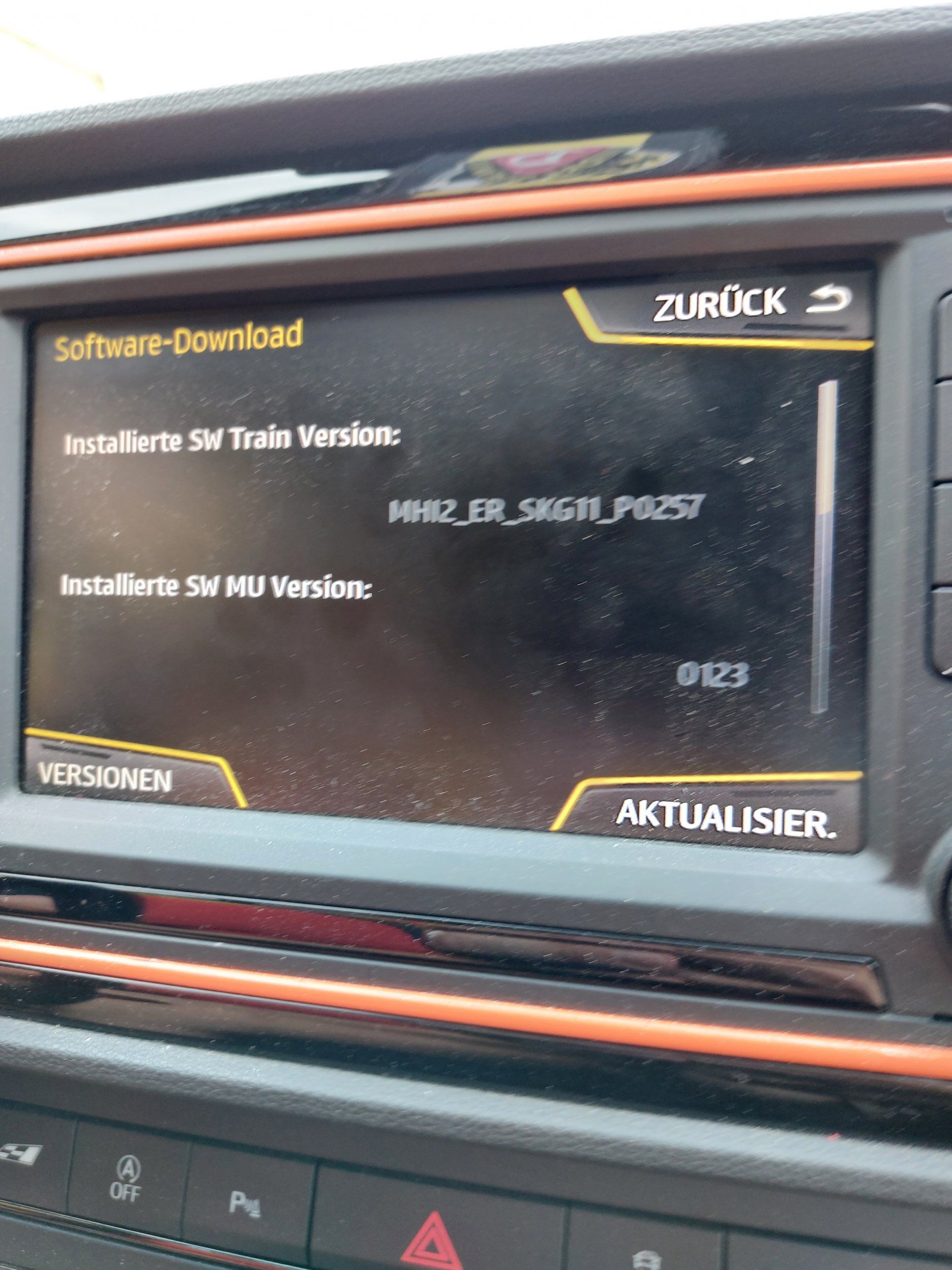

can i directly Update to MHI2_ER_SEG11_P4709_MU1447 with my current System?
no.the first version. normally in train should be SEG11.need little modification .....write me pm.
Is that not the Skoda firmware on that unit ?. SKG so they need Skoda firmware or they have picked up a Skoda unit and put it in a Seat.... hence they need a bit of code to make it look like a Seat. Presume they then need the AIO unless it keeps the Skoda FeCs in the process of becoming a Seat. We know Skoda navigation FeCs work fine.
Skin still looks very much like SEAT and not Skoda.
Maybe someone just played with the unit already...
