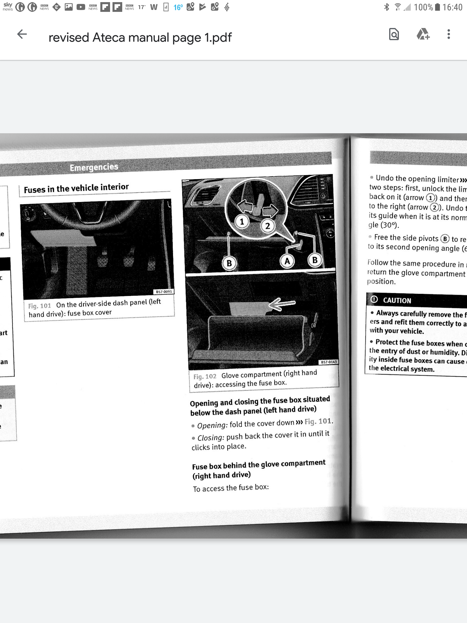

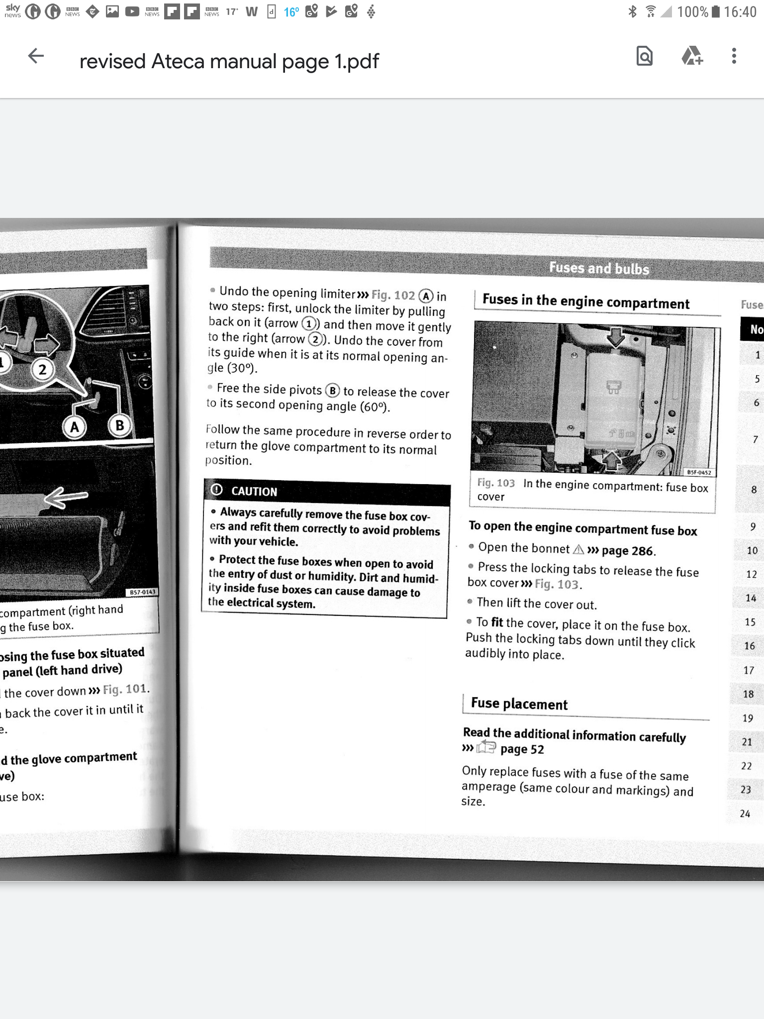

The fuse box is behind the glove box. The glove box drops via fiddling a side fitting. There is a dampner that gives it the slow decent. That's unclipped then it just drops down. Think the pollen filter is behind there from memory as well so routine at service.
I've never got in there but others have - you need strong fingers. At release the manual never covered the access to the fuse box but was added in the second release of the manual. Turns out fair few Vag cars have them up their on RHD model.
View attachment 10124 View attachment 10125 .
