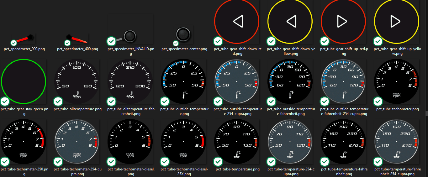

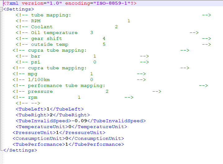

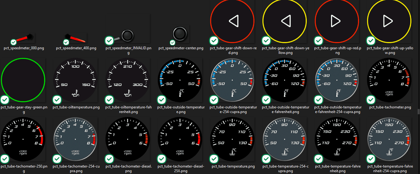

So, I've done some research on this device, since my gf has an Ibiza, which is now rocking it 🙃
There are some cool features, like the gearshift indicator which I haven't yet seen active anywhere:
The gearshift also is in the UserSettingsTubes.default configuration file:
I'm making some updates to the skin files of the device, and I'll try to connect to the serial console today, to see what's on there. I like the binary hacks that were done, but maybe there's a better way to achieve the same by changing configurations on the inside of the device.

Getting somewhere, old school Windows CE. It's been a while since I last played with such a device...
I decided to give it some small updates, to make it more "mine", and as a proof of concept ;-)
Findings so far:
- Windows Embedded CE 6.0 is running on it
- Total commander can be run
- I added some more apps, like VWHighBeam (shows some high beam lights animation) and VWPaint (a touchscreen notes app).
- latest version for Seat seems to be 7.16.9
- there's a hidden partition inside that holds the settings. This can be useful because it might allow additional settings to be set that are normally not available through the user interface. I'm currently experimenting with modifying them manually
- setting the tube setting to Gear shift doesn't seem to work..
