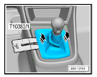

Anyone done it?? Im so pissed, cant move it a bit. The plastic bend but it wont go up. This pic is useless!!!

Not done it myself, but looking at the tool, looks like there are two clips on the left you need to push inwards to the right , then lift the gator up.
I have only ever done the A pillars and they were a pain to remove as the metal clips have a good hold.

Also bear in mind, maybe try from the other side if you have not tried already as diagrams are usually from a European left hand drive car.

I’ve removed mine before, it helps if you pull up gently with the gator “leather” at the same time as prying it

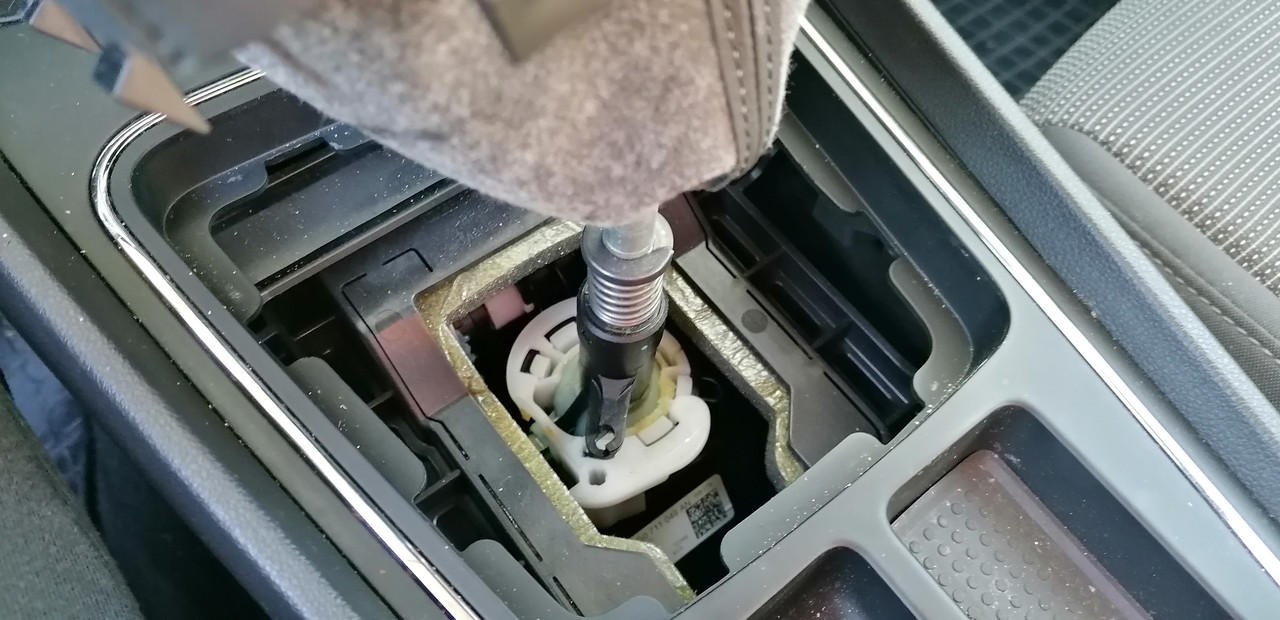

Did it!
I put a plastic tools from 3 sides, left, right and bottom and later i found out that the clips are all over the plastic rim.
Unfortunatelly, i was hoping to have more to greace as there is nothing more than some plastic ball at the bottom of the gear stick, put some silicon spray in it in order to make shifting more smooth.
I did the same thing with the shifting cables.

An official dealer have done linkage adjustment, not very helpful though.
Anyway, after i greased the cables and the plastic little ball just beneath the stick, i feel difference, not much but i can feel it and on this shitty gearbox, even the slight positive change means a lot:
