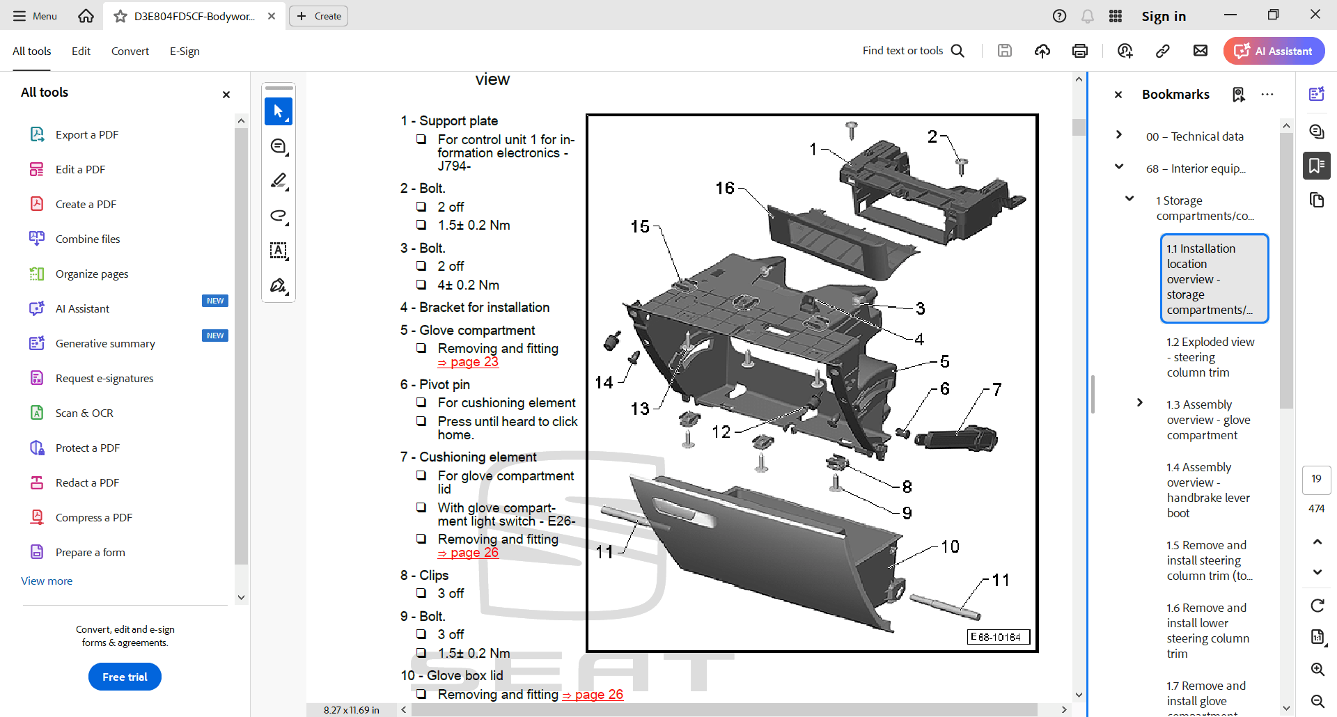

Dear all,
I want to buy a glovebox so that the MIB2 (8") multimedia could be installed properly.
I have the most basic multimedia at the moment (5,6") with no central unit inside.
The problem is that i dont know how to make a difference between those two, meaning that i dont know what to look for.
Can anyone help me by pointing me out what should i look for ? What is the difference between those two gloveboxes ? How the glovebox with installation for central unit looks like ?
Thanx in advance.
Ogi
Can anyone, please, help ?
I got the media but i dont know what glovebox i shouls buy. There are different letters after the aprt number and it seems that they are different.
just cut the cover behind where the mib would usually go that’s what i done i had the basic 6 button radio but i upgraded to mib1 cause it was cheaper and either way better than the 6 yoke
The glove boxes are all the same - you need the inner trim piece to cover the media unit.
As RiponM_27 says - just cut your blank one out
There is a trim piece here
