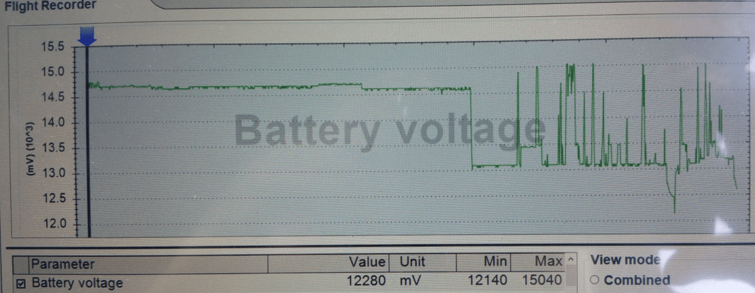

Been doing lots of logging but only thing I can see that is 'interesting' is the battery voltage - which at first log seemed fine for a 'smart' charging system?

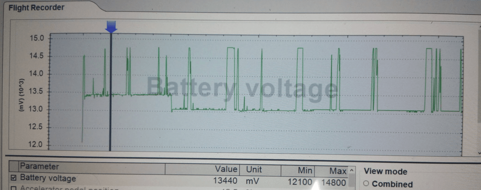

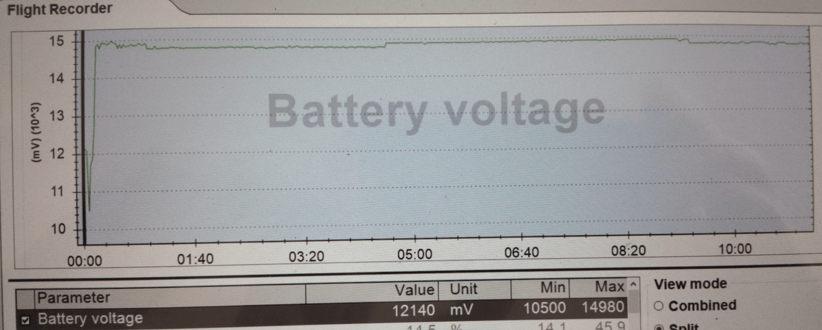

Next log looked strange - constant voltage and then the 'smart charging' kicking in - and then the third log is just constant voltage as a standard alternator might give!
Is this a correctly functioning charging system - just doing its thing?
Or is this a sign my battery is getting tired?

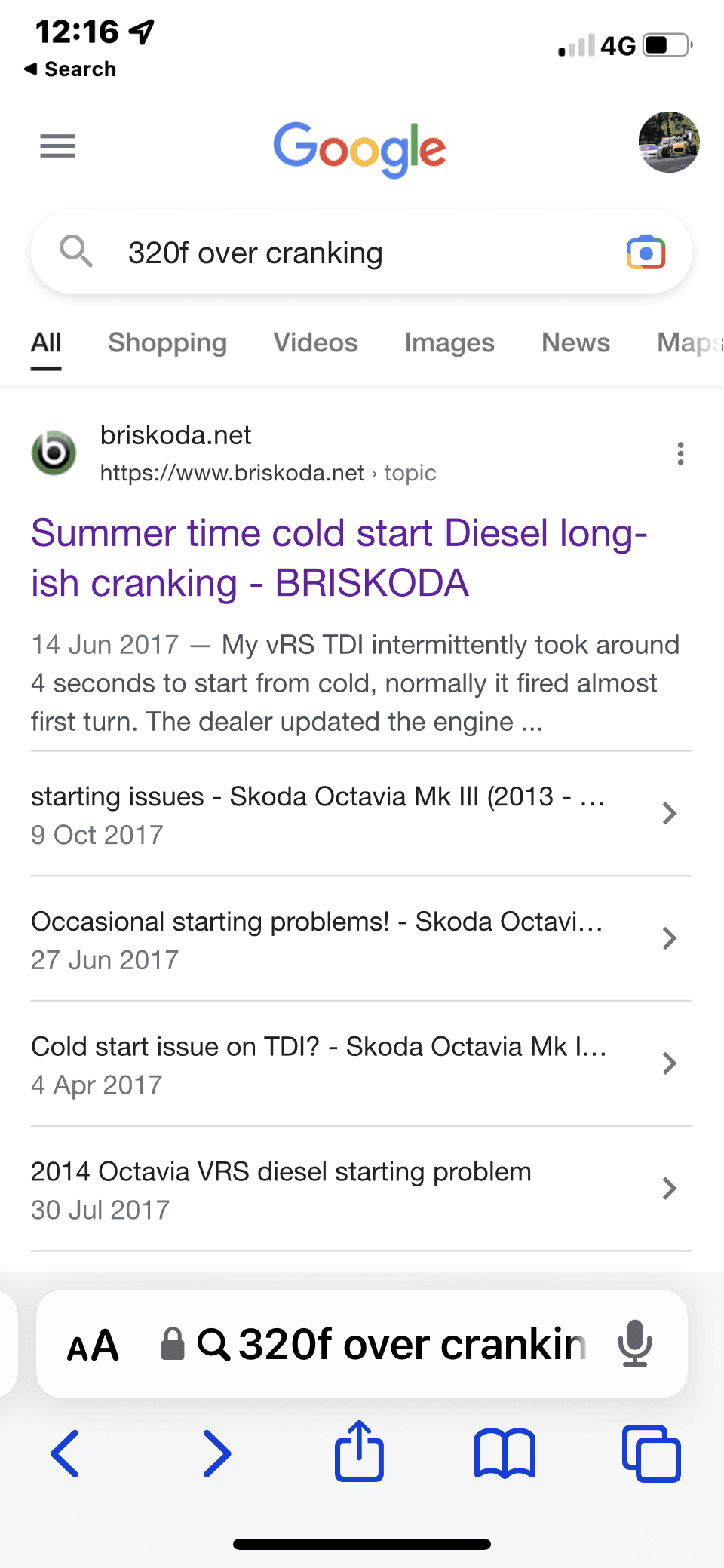

I did find this bulletin for my engine regarding difficult engine start from cold - BUT it mentions about a <21 deg air temp - and mine has defiantly occurred when the outside temps are higher than this - so I'm not sure this would be worth perusing? Don't know what Seat would charge to plug in and check for ECU software updates?
Have also read that some Skoda's have had a software update to 320F which for some has cured it - for others was just temporary improvement.

Interesting as that Technical Support Bulletin mentions poor cold start in warmer weather and over the last 2 years off ownership this is the time it does it especially this year in the UK as we are experiencing a heat wave
But it says < (less than) 21 deg C so I wouldn't associate that with any heat wave. Maybe it's a typo and should read >? who knows, but that is 2 different sources suggesting a software fix!
