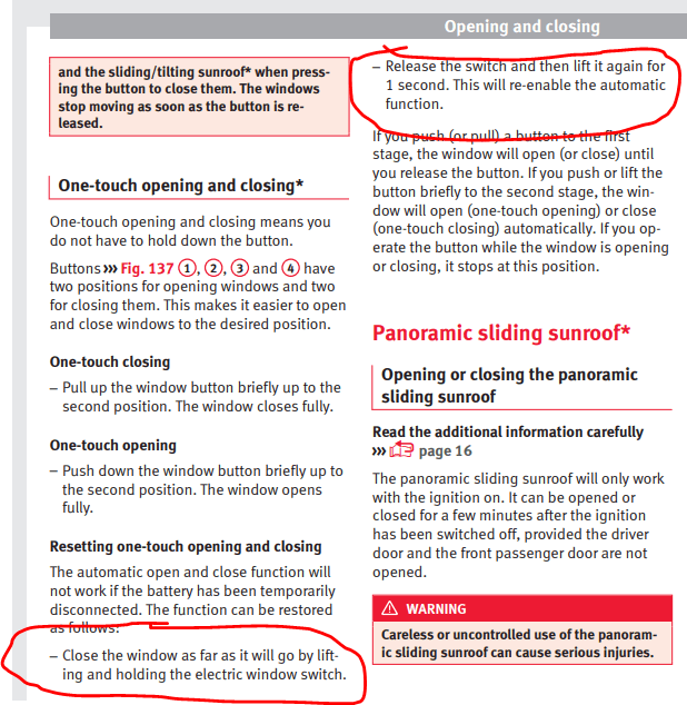

Had to do this procedure to reset the one touch windows afterwards to get my comfort windows working:
TCS and TPMS all had warnings where were easy to clear with a drive and re-set TPMS.
Had a load of fault codes stored - which all cleared ok.
