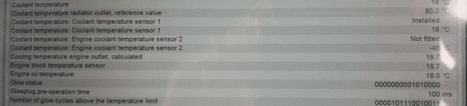

I noticed this 100ms glowplug pre-operation time last night which I was surprised to see at 18 degs?
Don't know if this varies with temp?

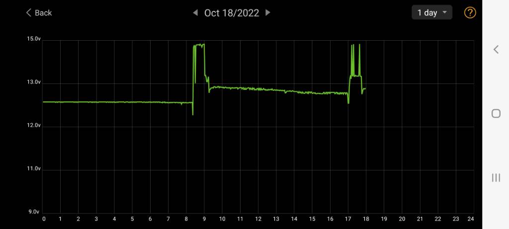

For some reason I get '--' when I view the SOC. I've got a 'Battery Monitor II' which Bluetooth's to your phone. You get some interesting data from it. After a run my battery will sit around 85% and then within a day or two it will have dropped to 65%. It tells you the cranking voltage, which is usually around 9.3v if it's been left.

Interesting, wonder why your SOC isn't working? Are you on the original battery?
Does your battery monitor graph your data so you can see voltages over a trip? Just wondering if you're seeing constant voltage or varying voltage depending on engine load? (see my previous graphs page 2)

It is on the original battery. Keep meaning to look at the battery setting within OBDeleven.
The attached image shows the slow battery decline overnight, my journey to work, journey home, etc.

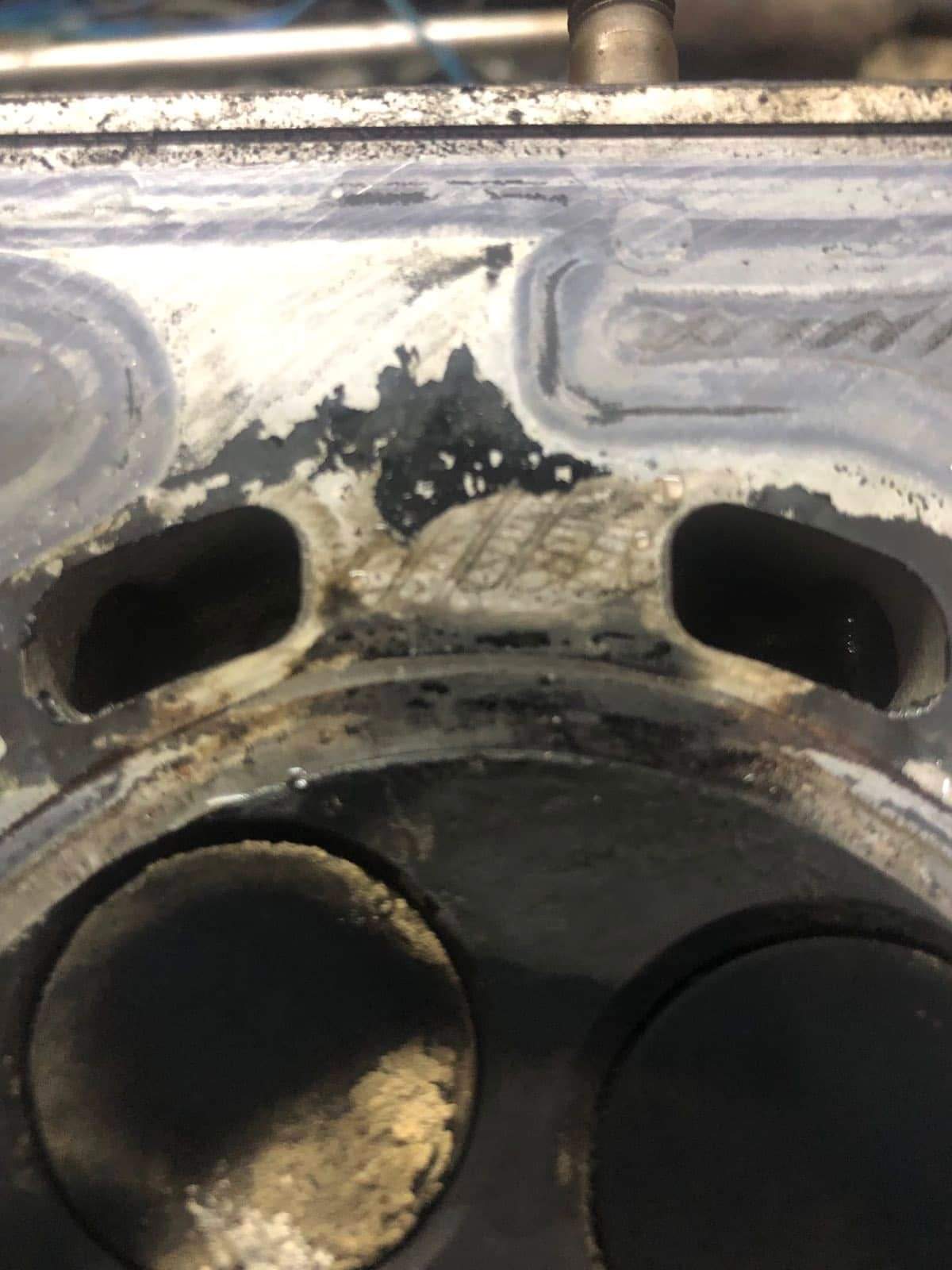

Hi everyone! To add one more experience to the "Long cranking" issue: I have the 2014 Seat Leon FR 184 CUPA and it as been randomly cranking on the first start of the day since I've got it. Sometimes it cranks for ~10s, some times it fires right away, no matter the outside temperature. No error codes on obdeleven as well. I was thinking it was a vvt issue, but there is no vvt on my engine :unsure:
I've changed the battery and it helped, for a first few days than the problem randomly came back.
Than, I had issue with coolant loss which turned out to be bend in the head so I've got it fixed and that also fixed the cranking issue, but, again, for a few days only. Coolant system was so pressurized and the fluid kept blowing on the expansion tank.
After that, there was another coolant loss, this time when the car was turned off, and that was the issue with intercooler/charge air cooler puncture. The dealership told me the charge air cooler is the common issue, and it could be the reason for the long cranking. Had it fixed yesterday, and today the car, again, cranked for a 8-10s before it started. I'll keep an eye for the next days to see if it comes back.
