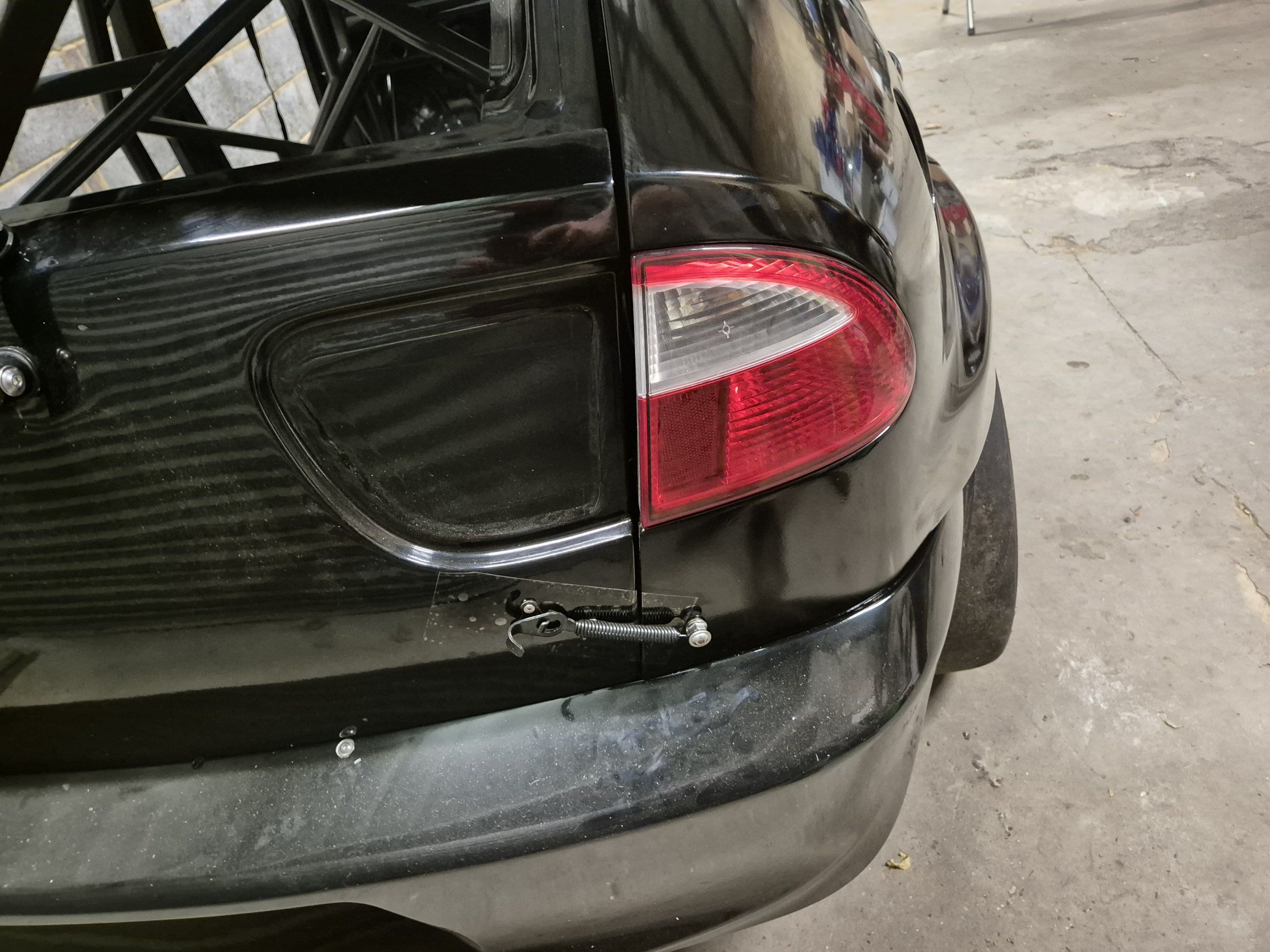

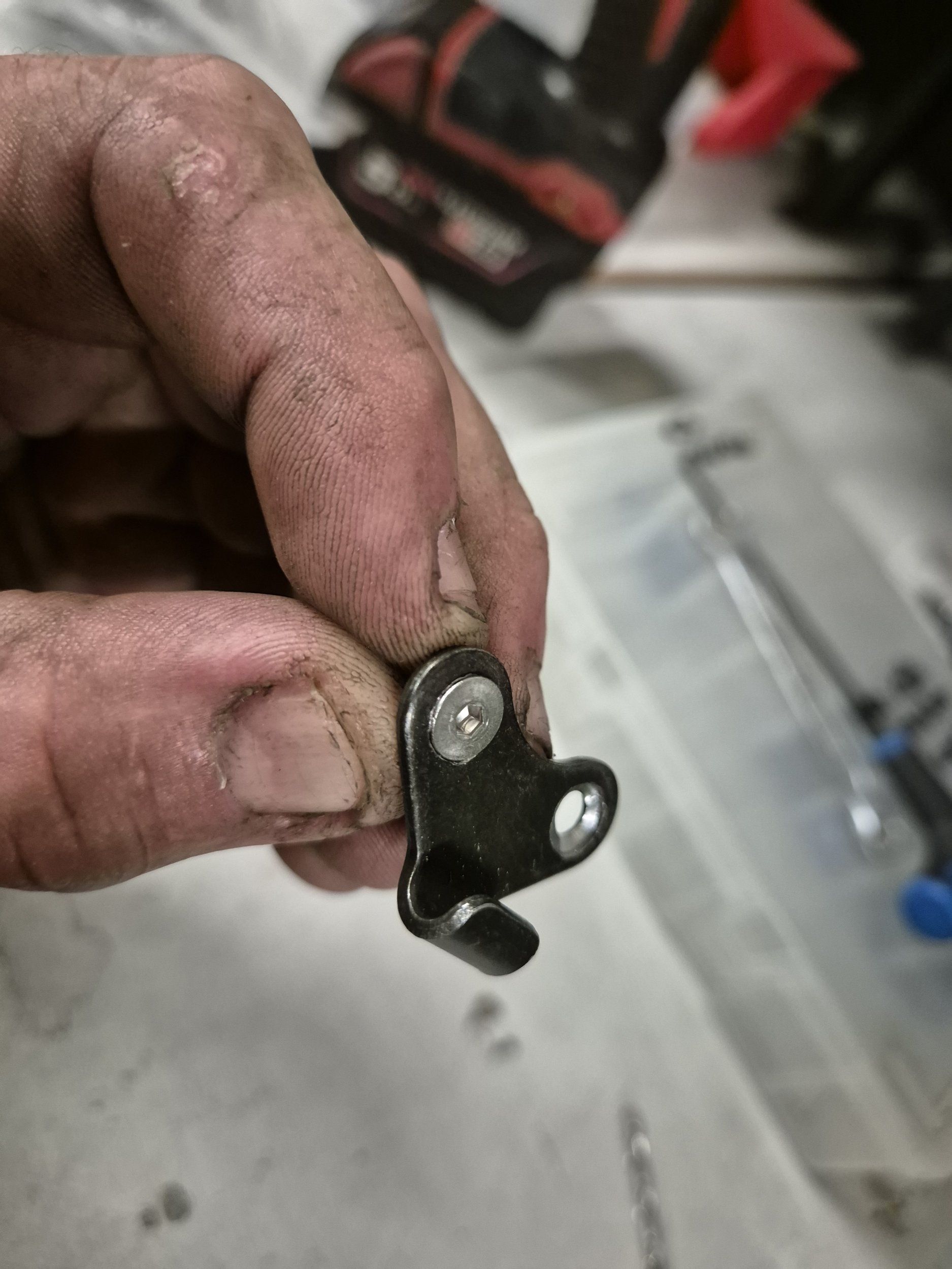

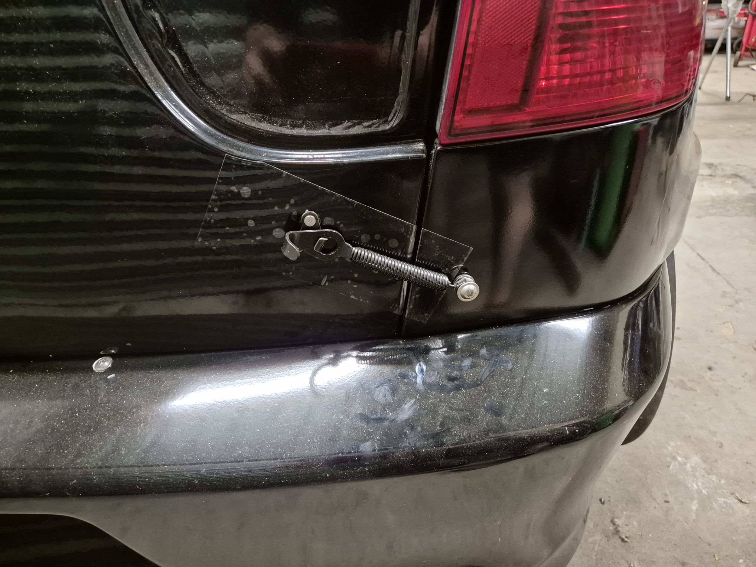

Also fitted the boot catches
Held them uo to the boot and rough calculations and measuring.
I swapped out the nuts and bolts for stainless version.
Bolted them to the panel under the rear lights .
I then place some clear vinyl where the spring will be.

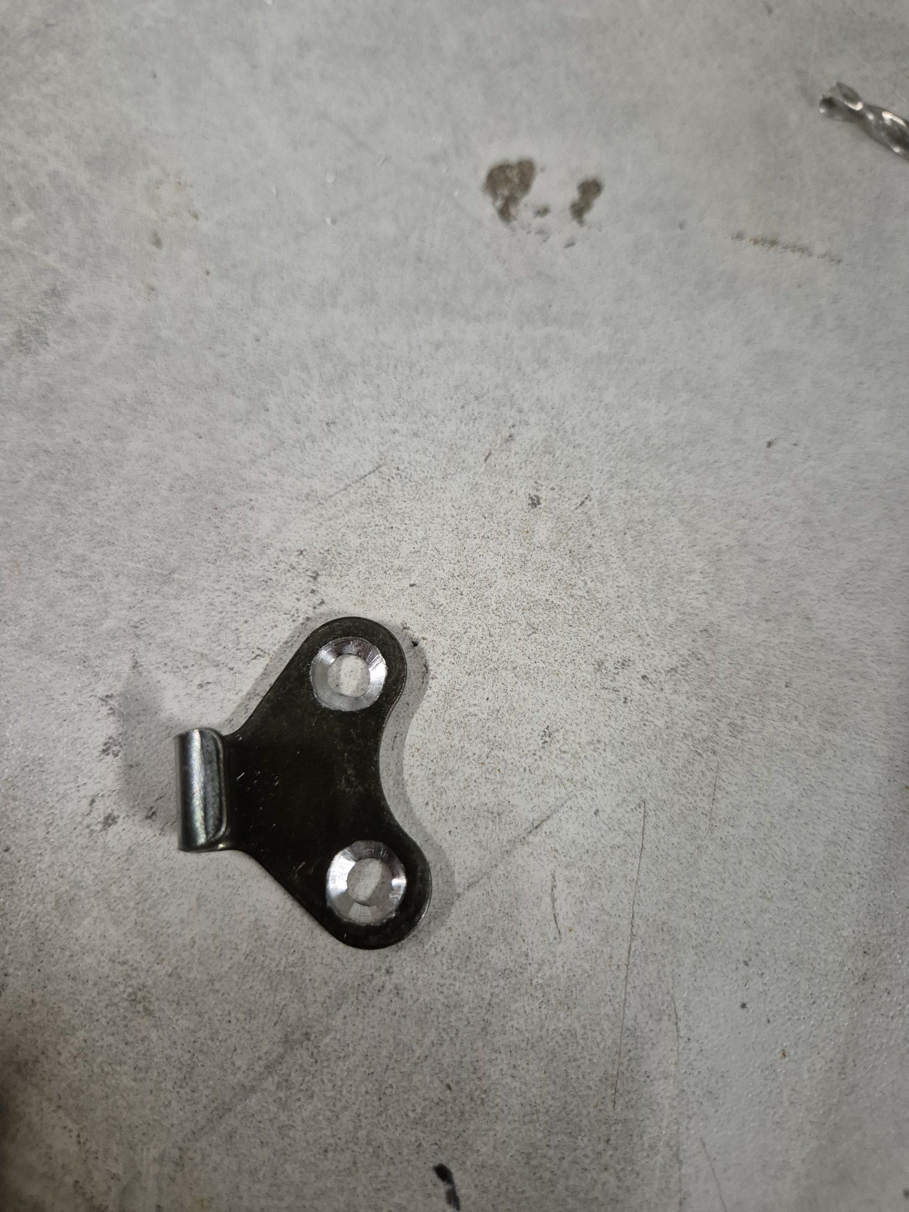

The little catch where the hook connects on to is ment to be pop riveted to the boot. But as the boot is fibreglass I decided to bolt them instead. I started by drilling out the 3.3mm hole to 4mm and counter sinking it
so now I can fit some m4 stainless counter sunk screws
Put some penny washers on the back and secure with nylock aluminum nuts.
And that's the boot lid secured...... I hope ?

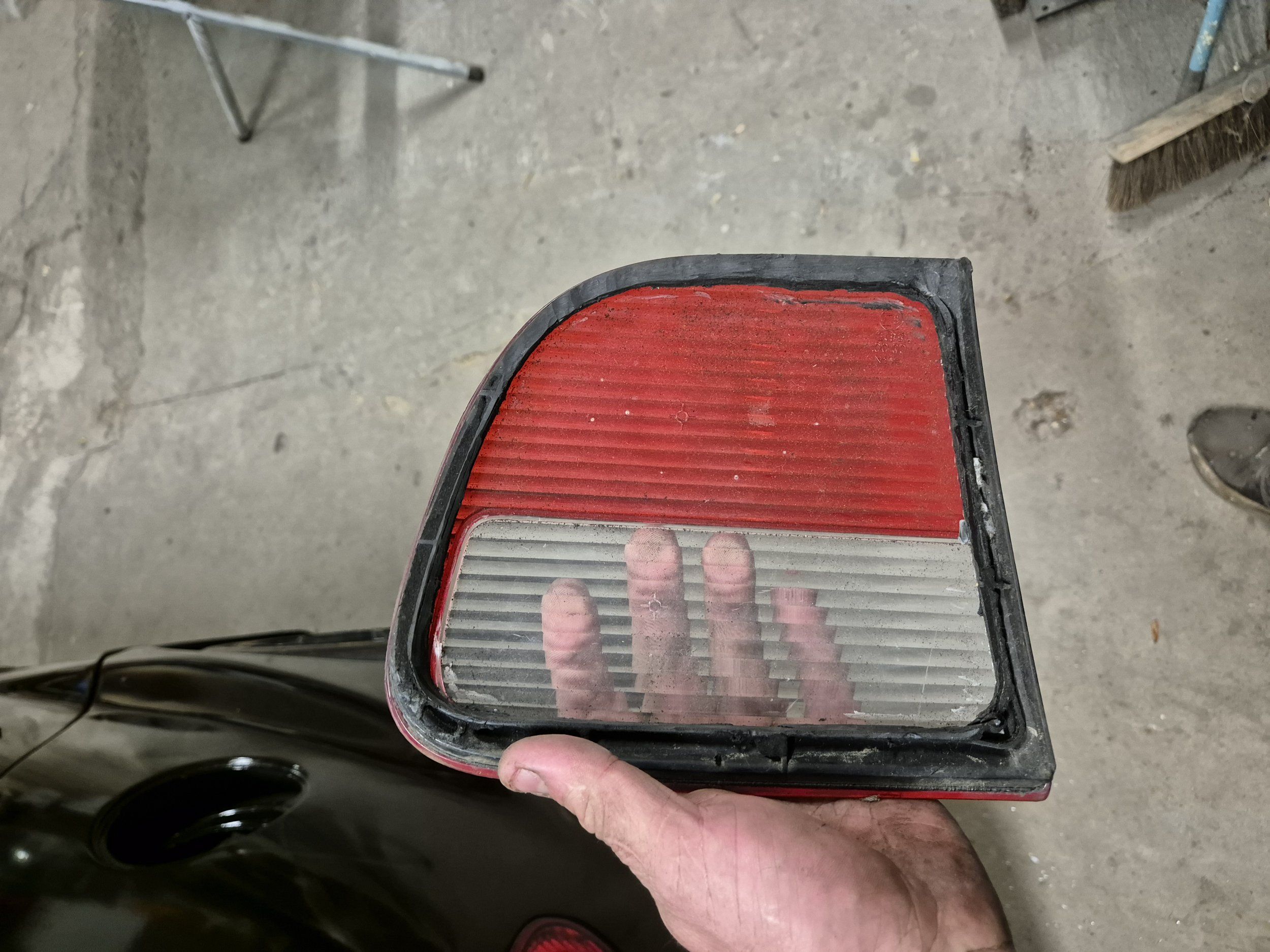

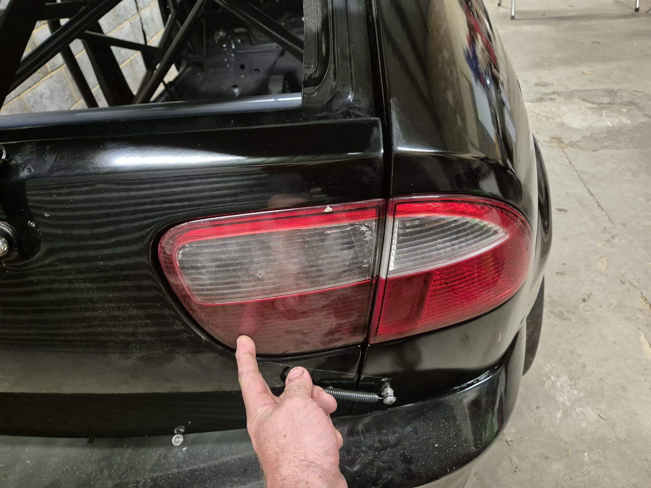

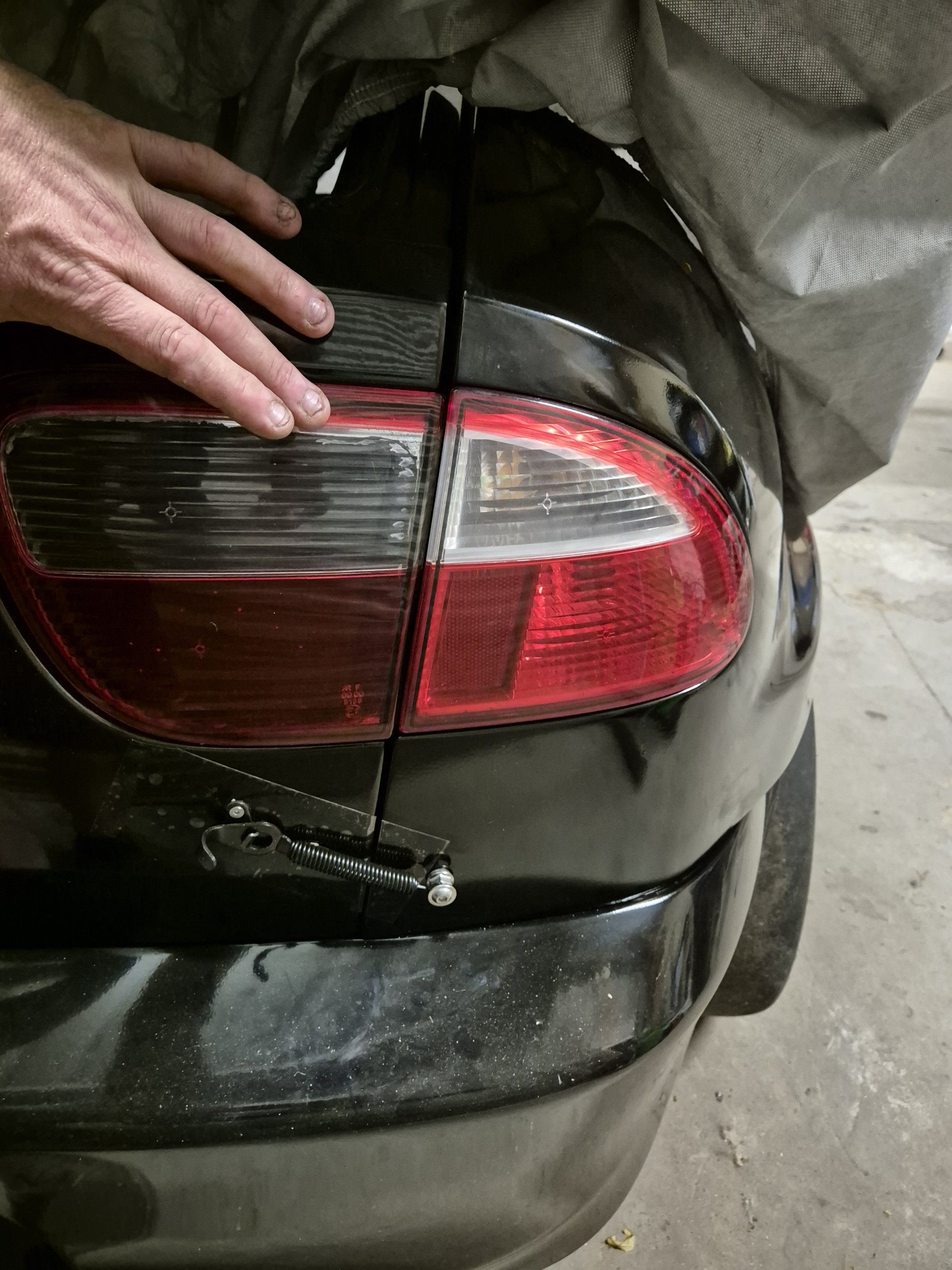

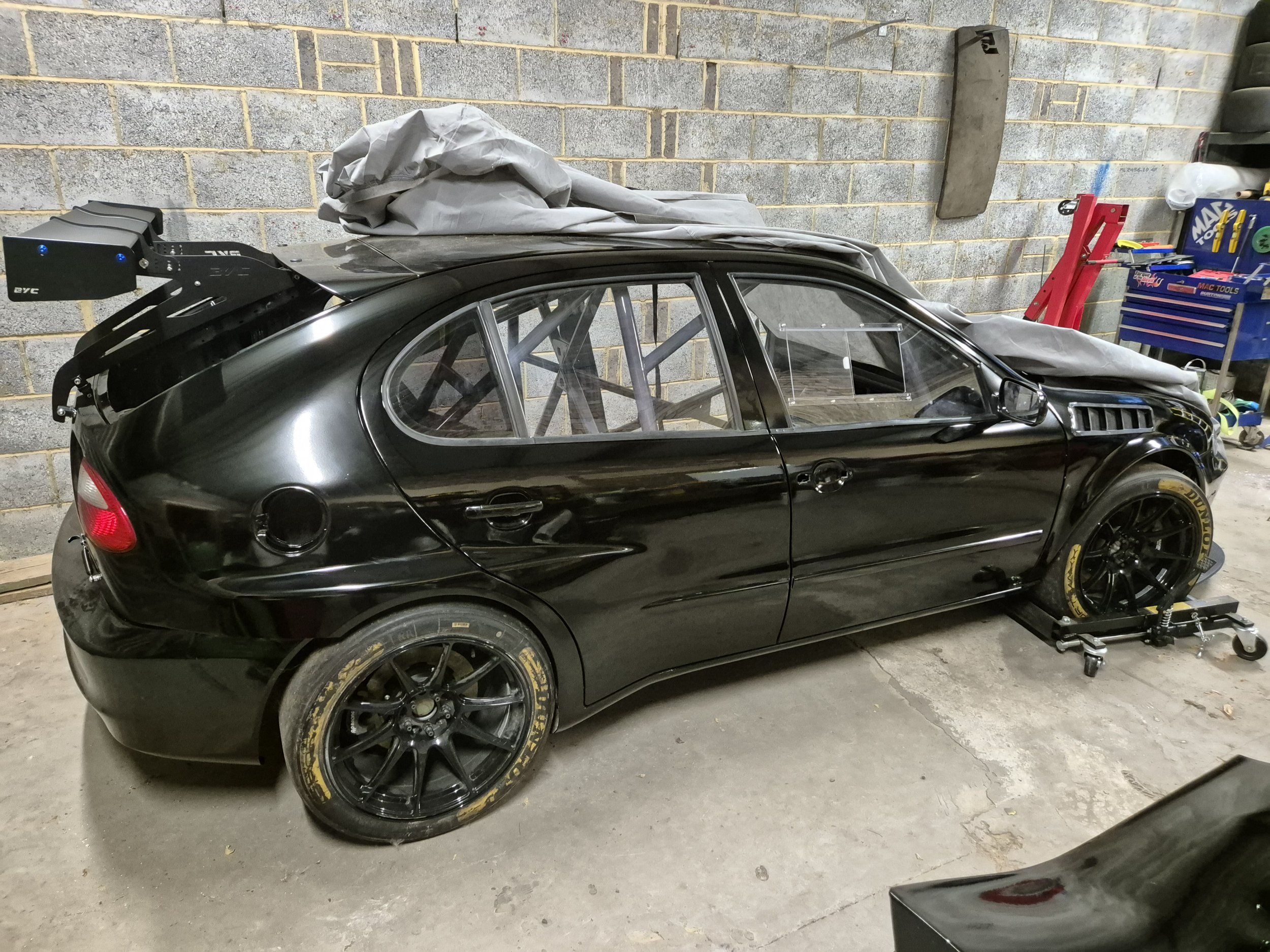

Next up I need so.e help guidance and ideas... right I'll try to explane. As its a race car I don't need reverse lights or standard fog lights.. so I only need the lamp clusters in the quarter panel to work.
But I feel it looks better with the boot lid mounted lamps in position
But due to me being semi lazy...and engineering lightness. If I don't need it it don't get fitted. So I cut the back off the lamp
Race car lightning in full action..
As the lens has been in the work shop for years and I been spraying etc. I gave it a quick compound and Polish.
But my issue is .. does it look OK with the black body. Or a few ideas I have come up with
1 chrome spray the back of the lamp
2 aluminium tape on the body
3 just stick them on..as they are
Please give me some other ideas.

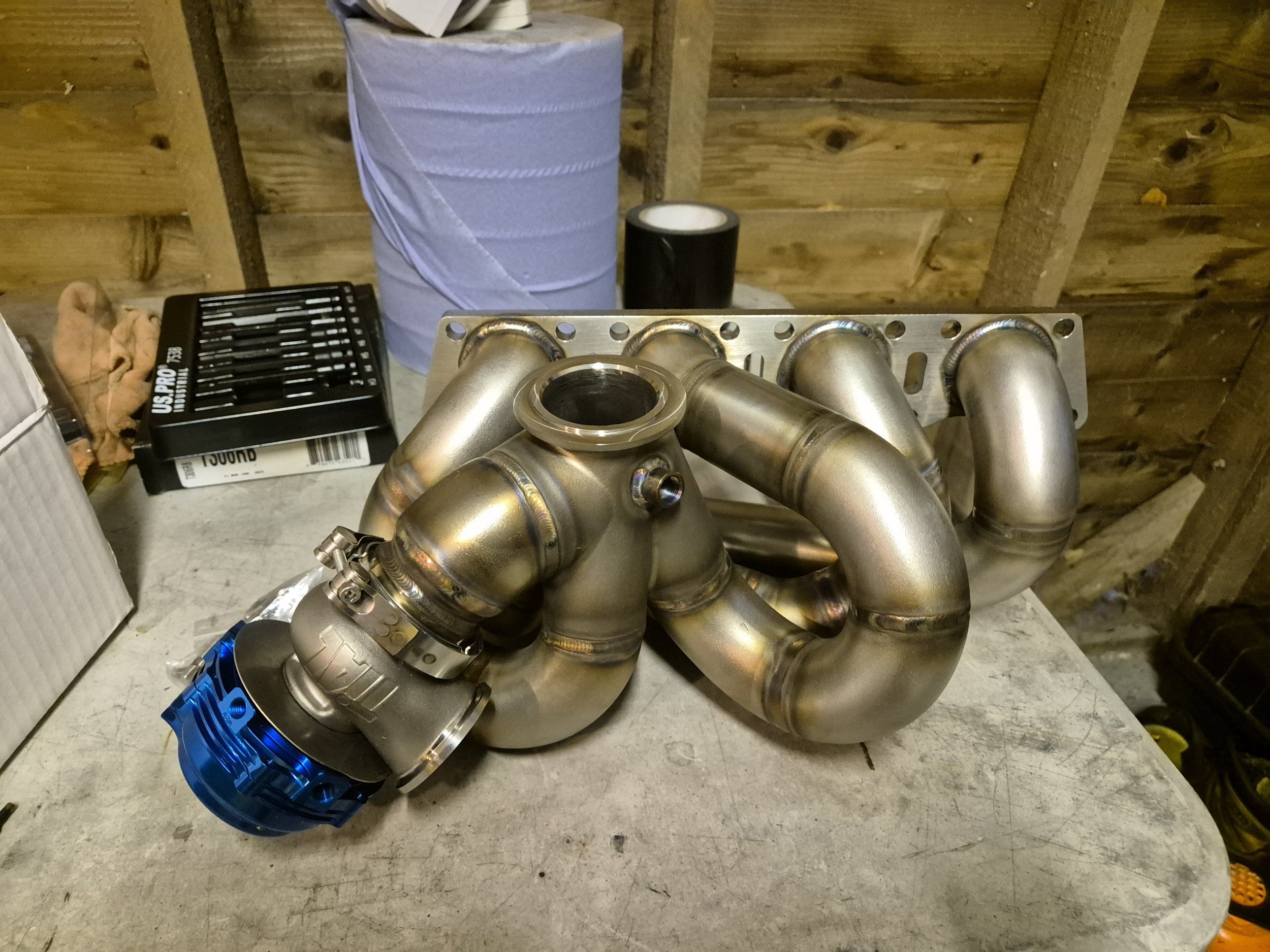

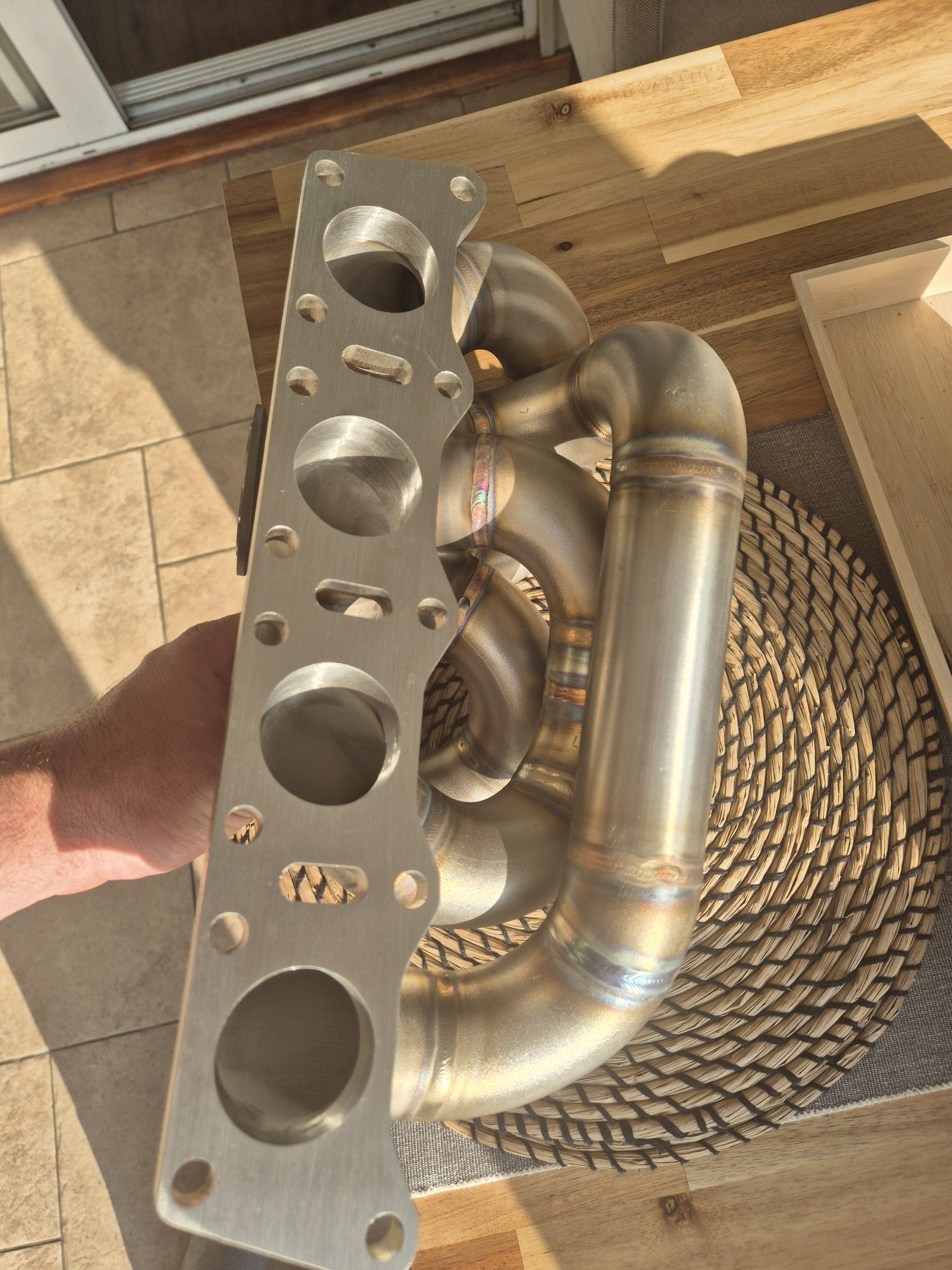

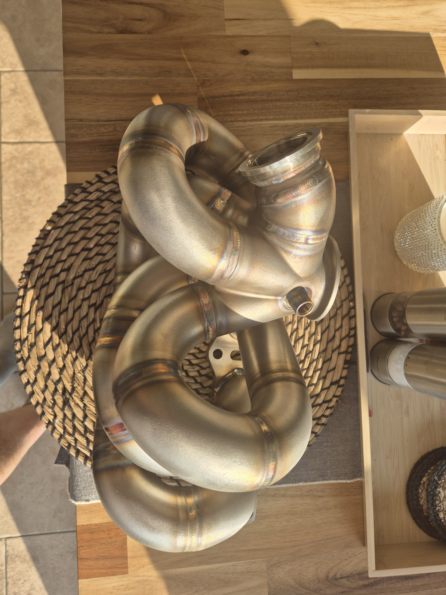

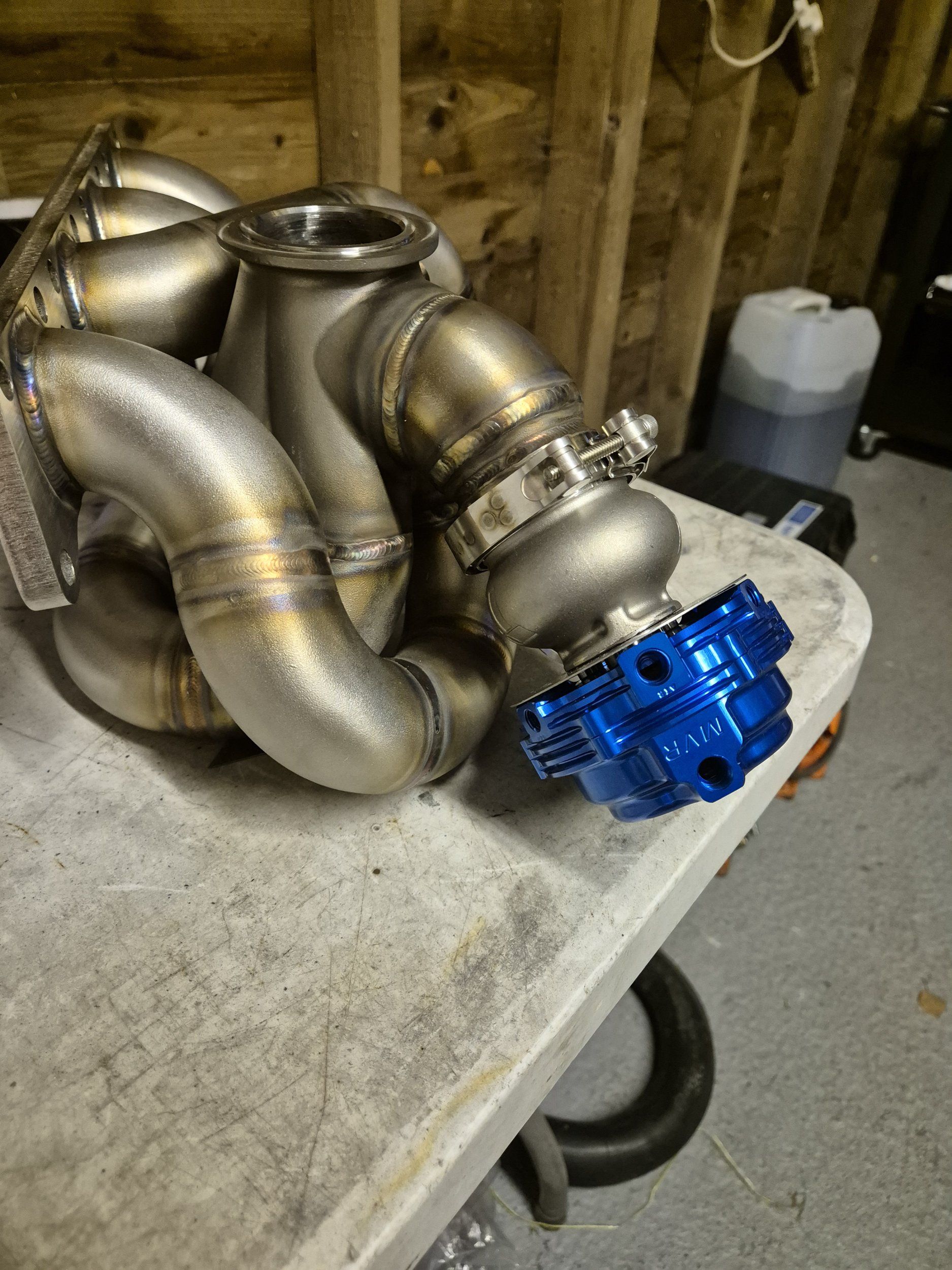

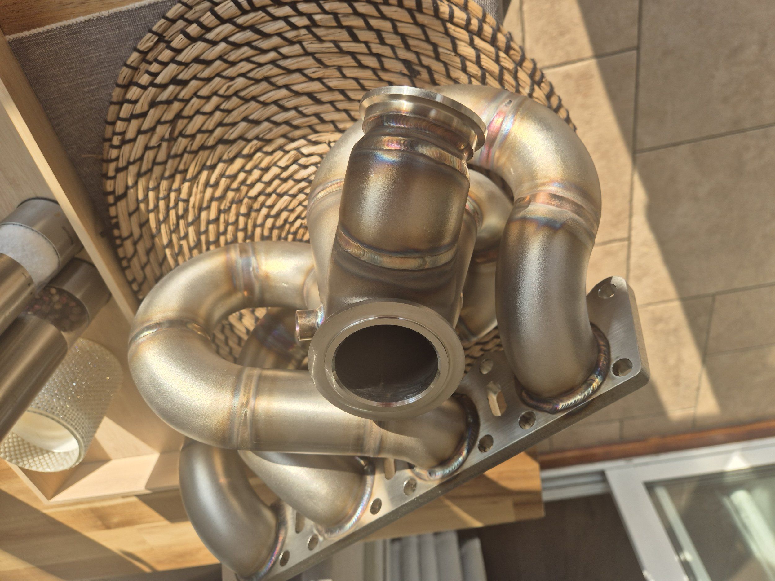

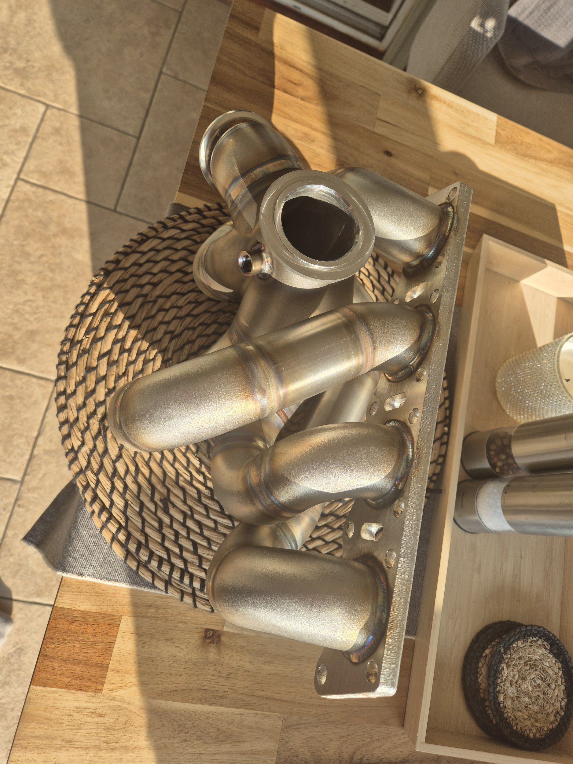

Delivered today... Nortec 1.5" runners and v bands to suit garrett g30-770 and tial wastegate set up.
Also had fitted a bos to moniter the exhaust gas temp. This will be used when the car goes for mapping. And will be capped off when in normal use.
Absolutely stunning welding. All the welds I can see are fully penatrated and it's just lovely
A big thank you to Nortec
Next up I need so.e help guidance and ideas... right I'll try to explane. As its a race car I don't need reverse lights or standard fog lights.. so I only need the lamp clusters in the quarter panel to work. View attachment 43793
But I feel it looks better with the boot lid mounted lamps in position View attachment 43794
But due to me being semi lazy...and engineering lightness. If I don't need it it don't get fitted. So I cut the back off the lamp View attachment 43795
You could always get some silver/chrome vinyl wrap on the bodywork or you could get some light tint vinyl (in black they are advertised as smoked but they do other colors as well) and cover all the lights (something like this )

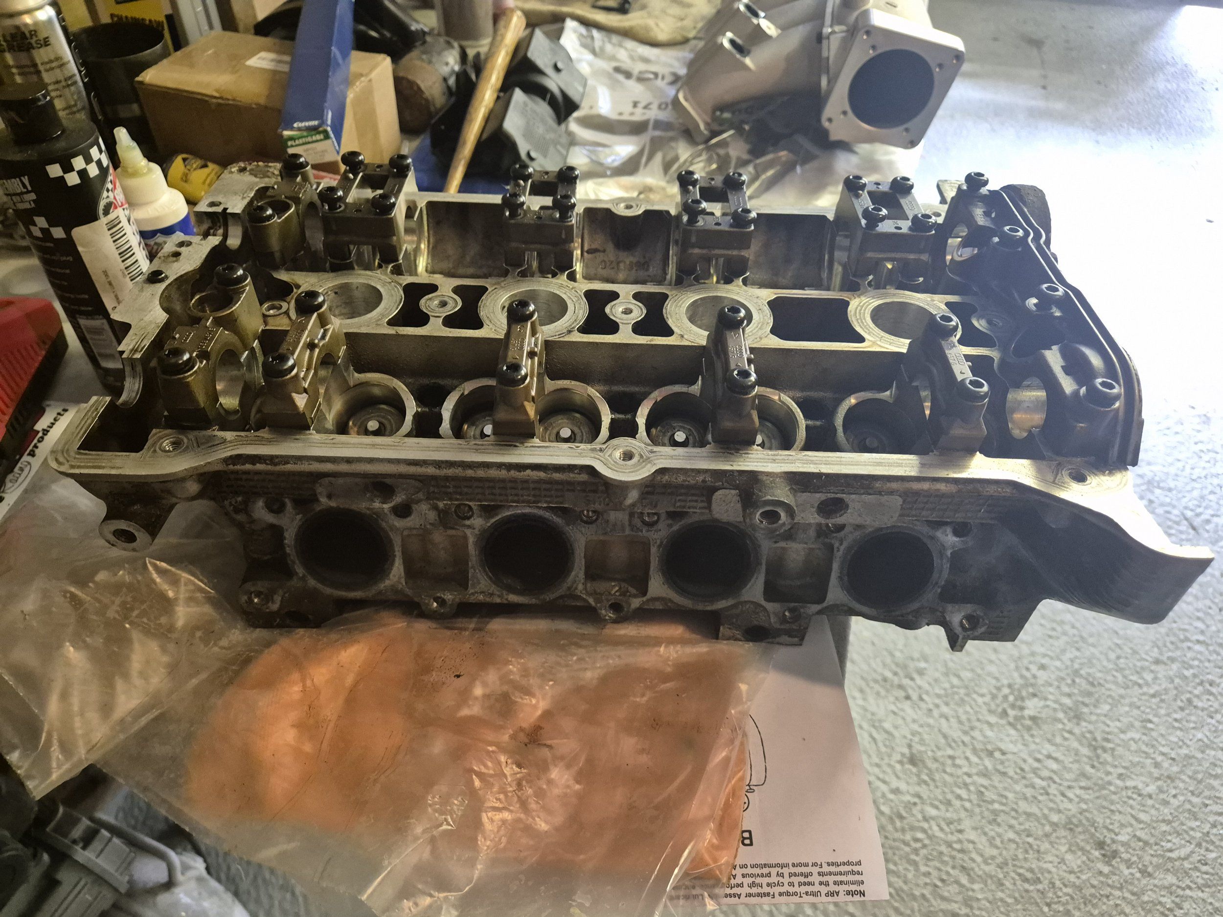

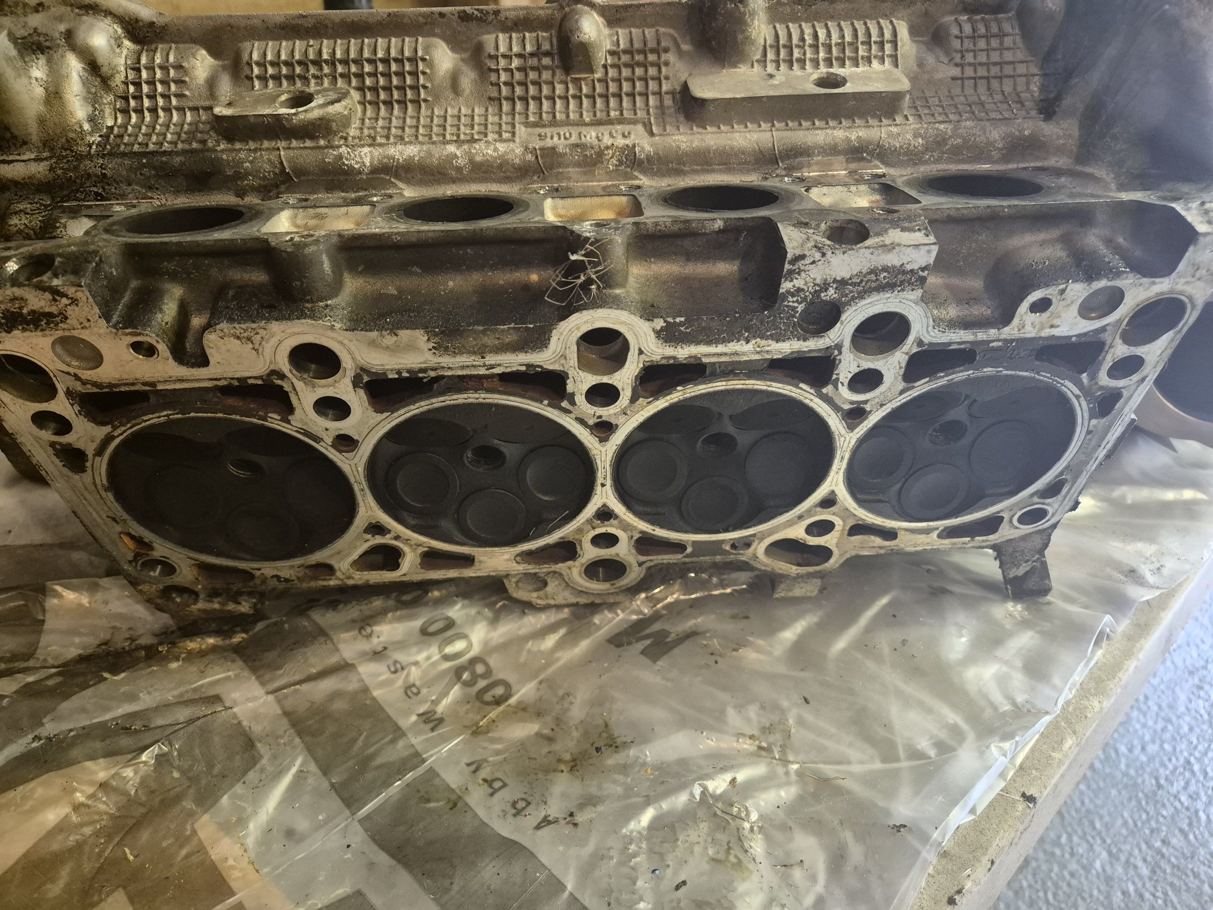

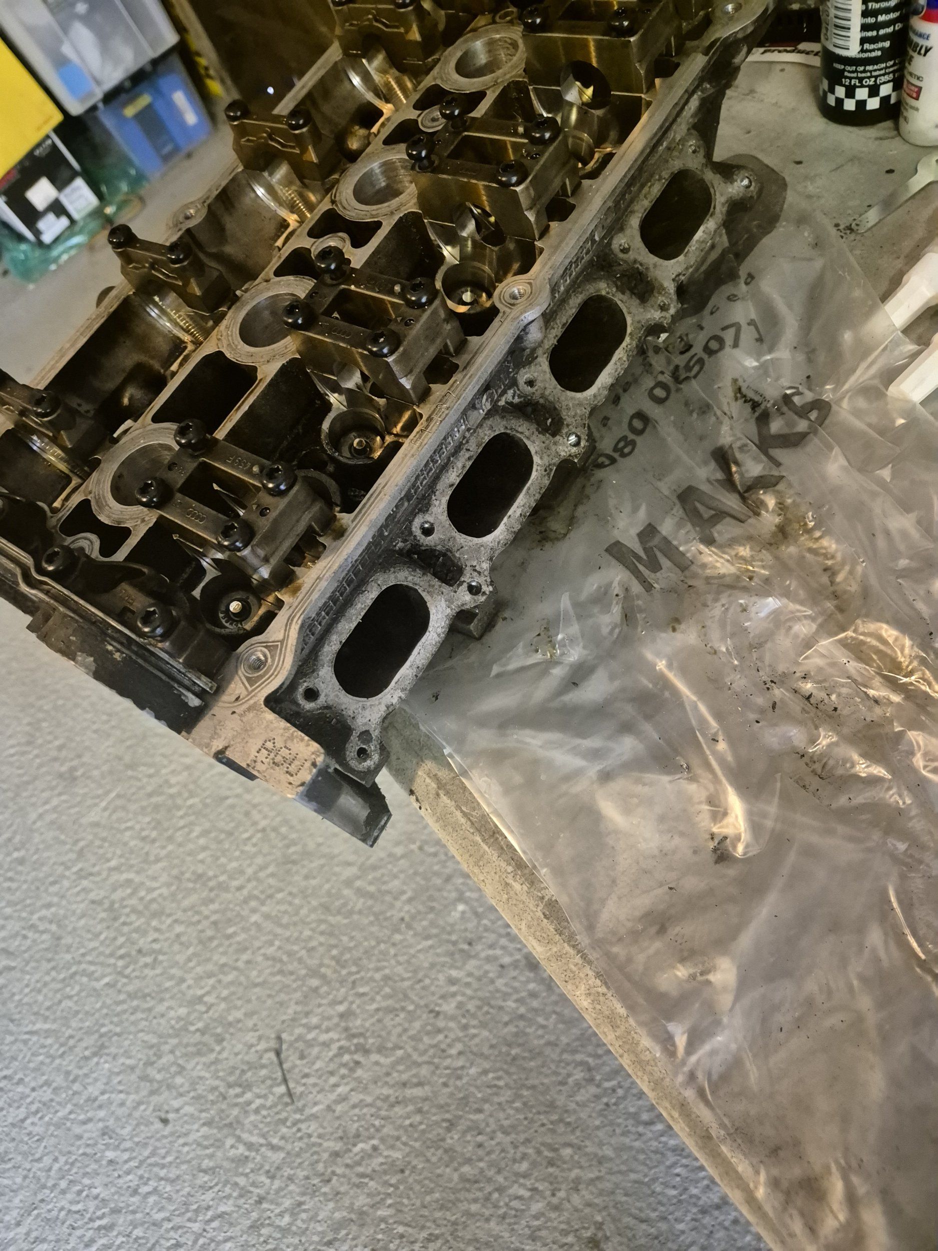

Finished stripping the head. All.studs and unwanted bits are off. Just waiting for the company to get back to me then I can drop it to them for port matching and building.
Got catcams to go in, with double springs , titanium caps and new guides, fcs solid lifters .
And a good clean up too.

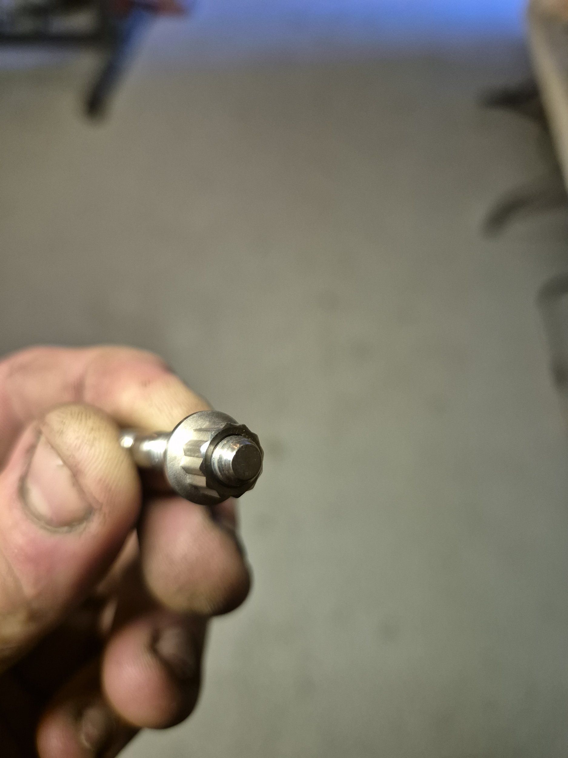

Sitting there quite happy. I had a thought... I don't think I have spent any money on that money pit in the work shop.

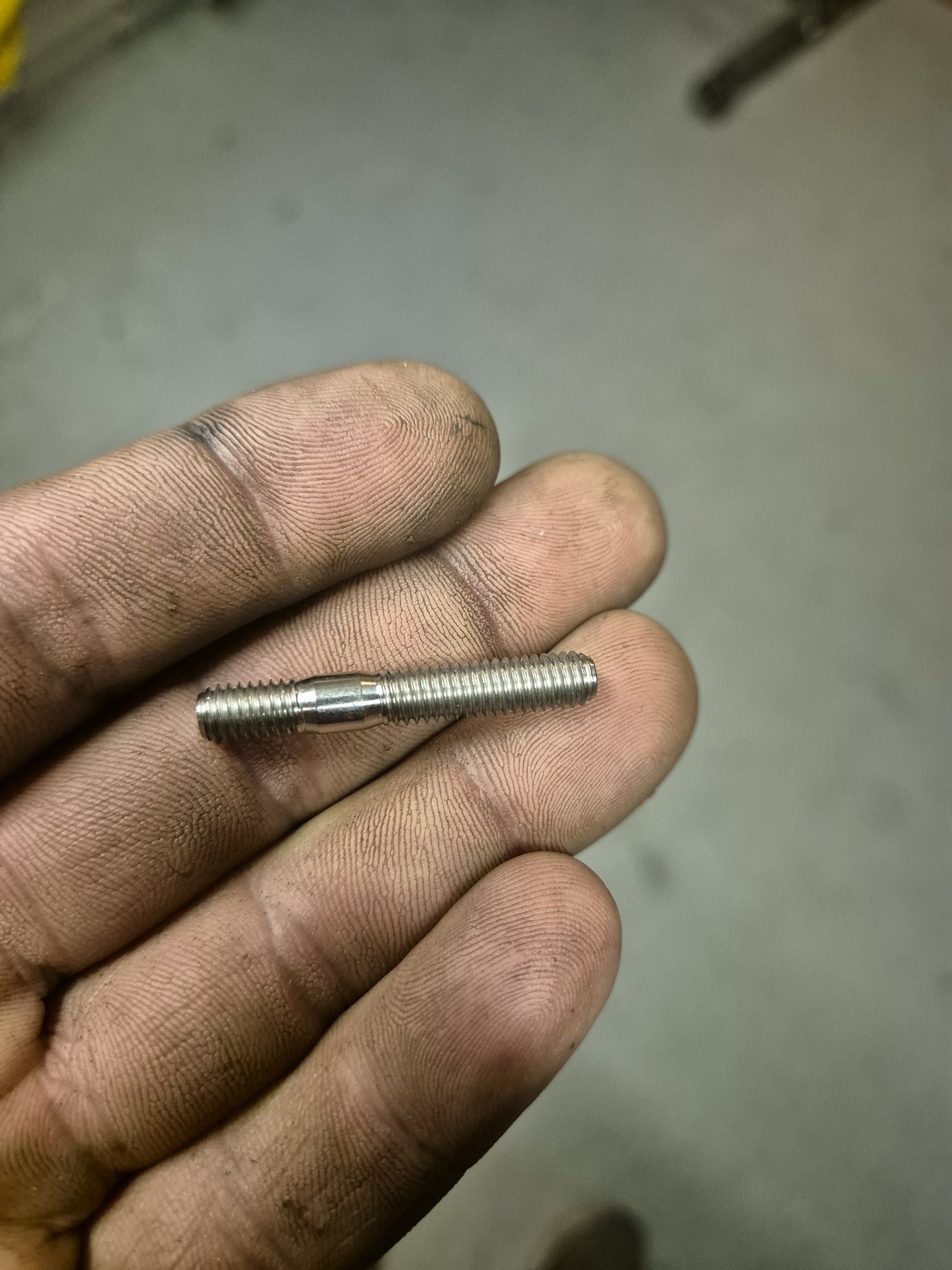

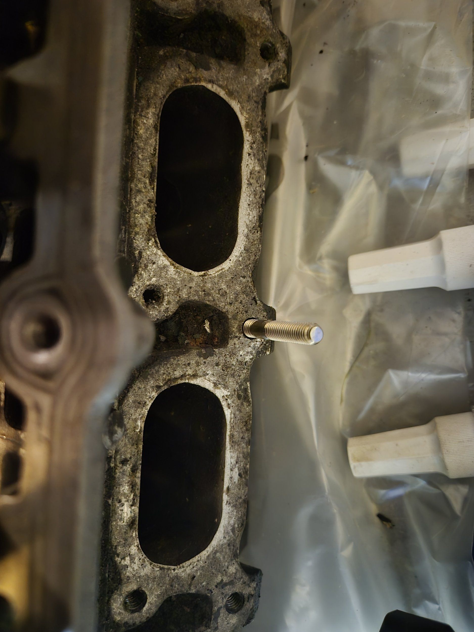

So I thought and thought... then realised I don't have studs for the head for the inlet manifold.
So I trot off to the workshop.. do some measuring.. and find the sizes I want and the amount I need.
Then it's google searching..
Shiney bit after shiney bit .
That will do...... na it's plated mild steel..... further and further in to the world of Google....
That's them... must have them. They are stainless steel. They will cost more than mild. . But wait. What's that.....
Oooooooo
Aaaahhhhhhh
Only bl00dy titanium... I gonna have to remortgage.. .
Some how the card details went in and sent befor I knew what happened...

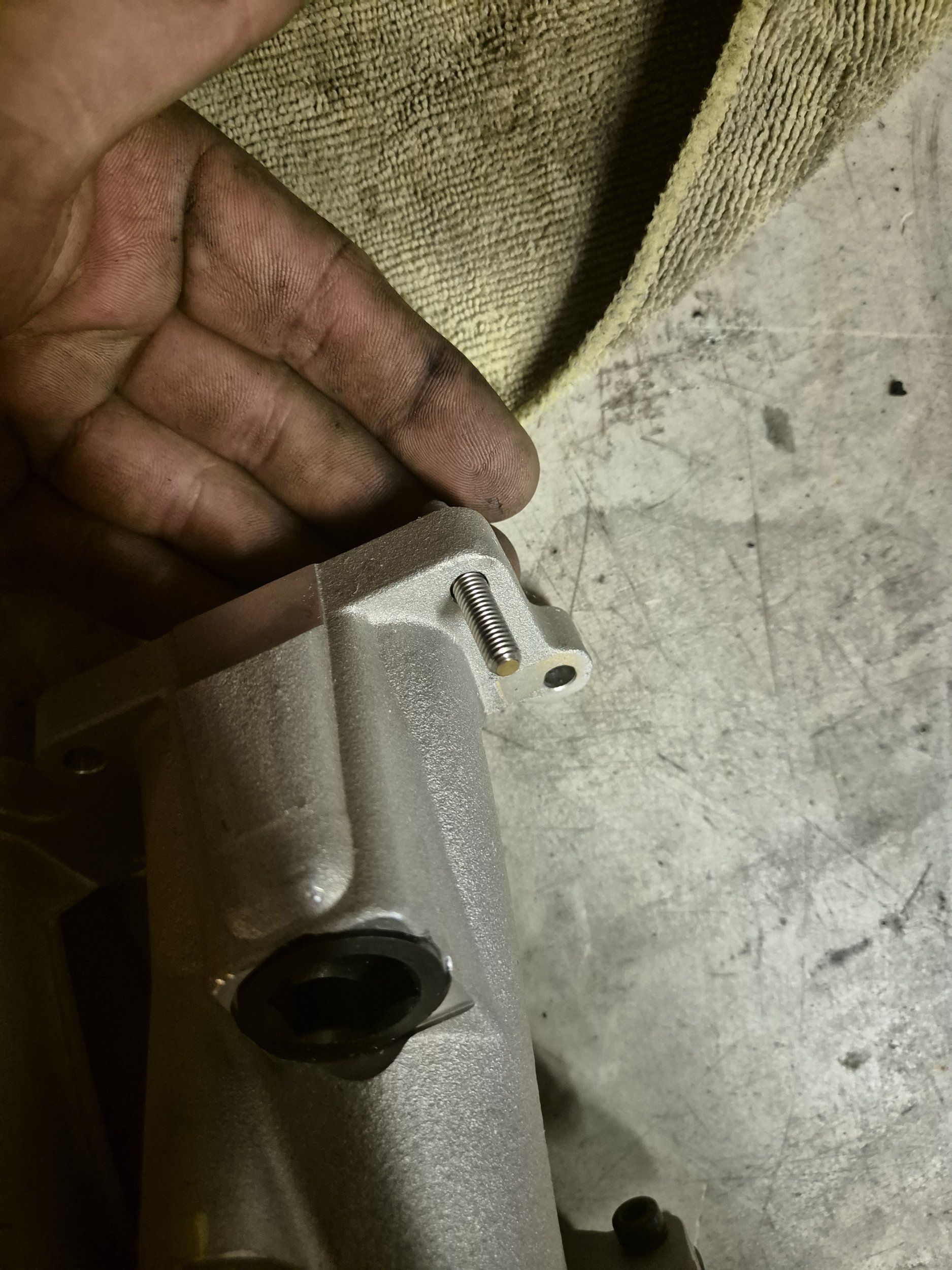

But look how nice they are...
look how they going to look against them manifold..
Look at them in the head it's all just so purfect..
But then the other half found the invoice......
10 bolts... 10 bl00dy bolt... £65 "f-in" quid
I took my " bolts" and now hiding in the workshop. I thought I would show you lot as you would under stand ...... soooo shiney
Those multi point nuts are a godsend for crappy access studs as they allow a smaller ratchet type spanner to fit on to them.
I have them on mine and also used them on my old AET380 turbo to downpipe studs....sooo much better!

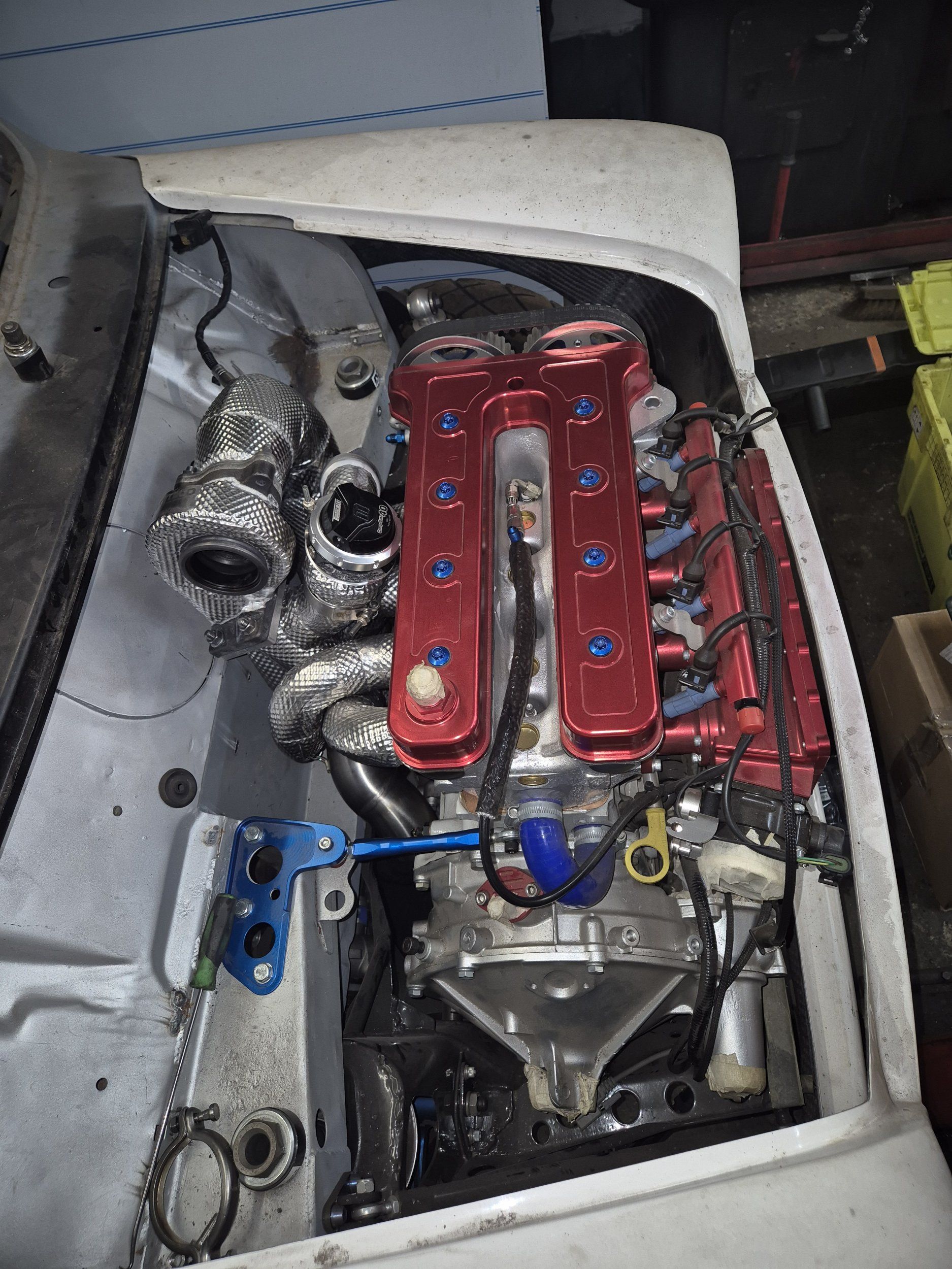

Spent a few hours in the garage.

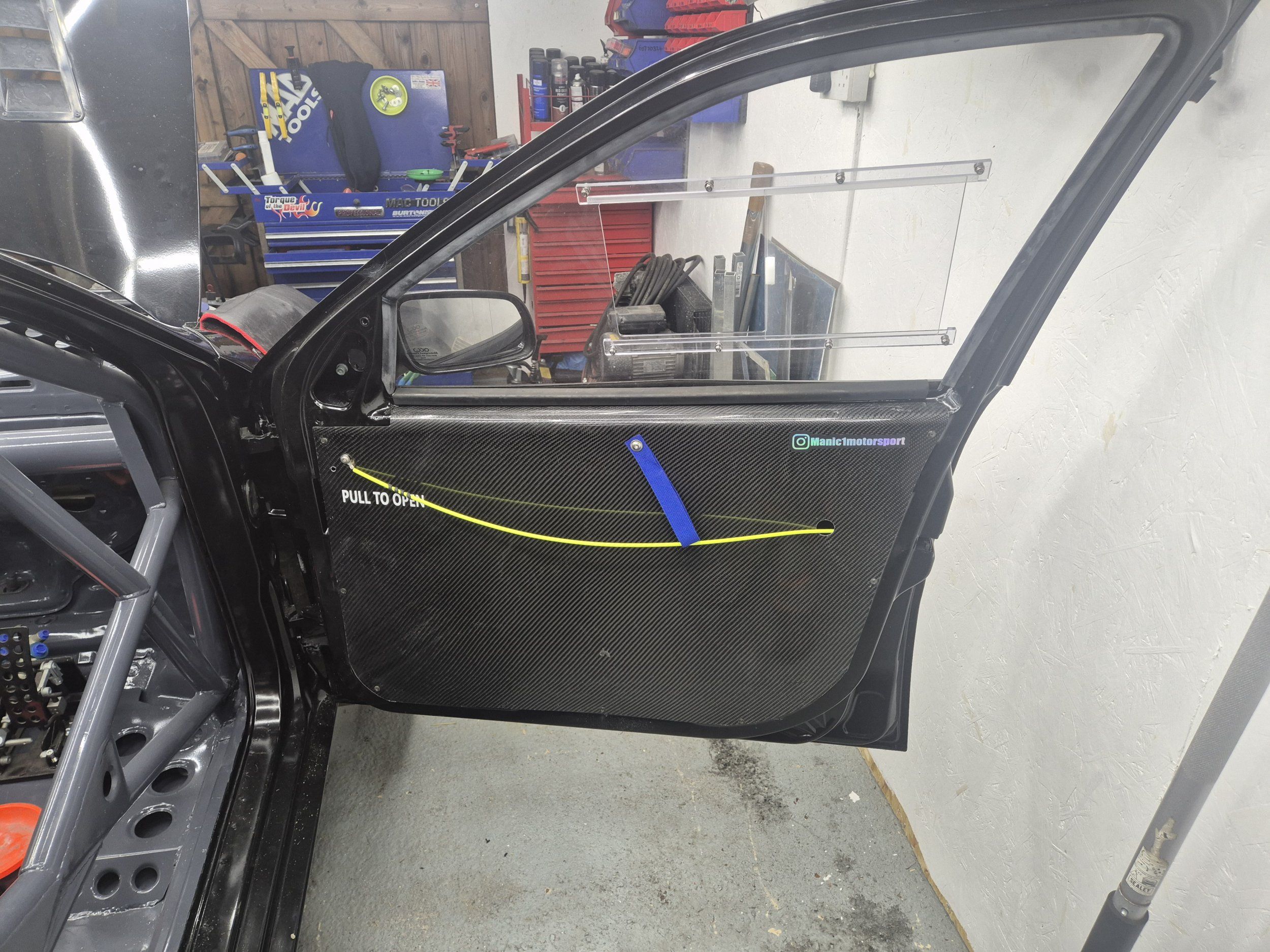

Finally sorted.all the doors. Fitted the blue pulls to close the doors. And the yellow pull cable to open.
Fitted all screws to the carbon door panels. And fitted and adjusted all the external handles (supplied by Mr thaiwronghorse)

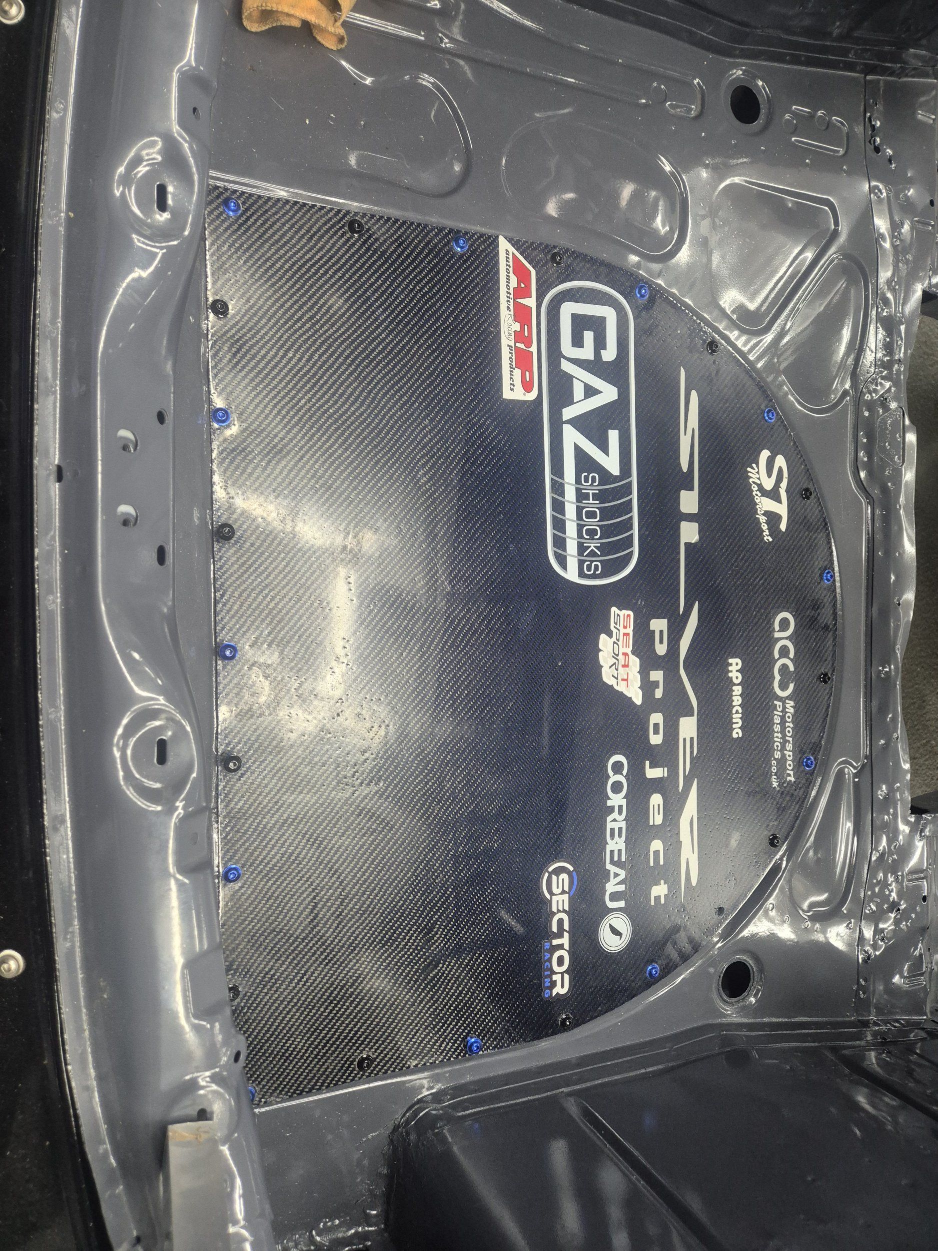

Then got on with the spare wheel well. Tidied up the edges and drilled out all holes to 8mm to help with the line up to the nutserts I put in to the floor. I used ally button heads as don't need any strength , alternated blue and black. Not sure like this or all blue or all black... suggestions please.
Spent a few hours in the garage.View attachment 46623
Fitted all screws to the carbon door panels. And fitted and adjusted all the external handles (supplied by Mr thaiwronghorse)View attachment 46625
