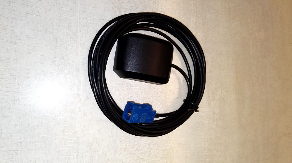

Part number of the original GPS antenna is 3C5035534F
Made the same retrofit. Get mine from aliexpress, working great.
„GPS Antenna Fakra MFD2 RNS2 RNS 510 MFD3 RNS-E For VW Skoda For Benz For Audi“
Reactions: Pac1man
Various aftermarket ones similar to the above post avaialbale on ebay, work just as well as the original antenna. Just mount under the top of the dashboard.

Aftermarket ones leave a "GPS antenna open circuit" fault in infotainment control unit, due to the voltage difference.
Nothing to worry about but some people care about things like this.

I replaced the factory GPS antenna with an aftermarket one on my previous 2014 Leon, no errors showed at all in the infotainment module (MIB1)

Then I have to change my wording as "some of the aftermarket ones".
I upgraded my infotainment unit from MIB2 Std (no nav) to MIB2 High (with nav).
Retrofitter guys installed an aftermarket one and it caused a fault in the unit (checked using OBDEleven) and it's still there.
Later I bought an original one but haven't installed it yet.

I don't remember exactly but I believe they have mounted it using something like a double-sided tape.
No rattles.
Does it have to be installed in a certain orientation or just wherever I find a spot as close to the top of the dash?
At first, they were about to mount it under the right A-pillar cover but I told them to put it in the original place and they were like "Oh, OK".
Then I asked the same thing about the orientation and they mumbled something so I got the feeling that it doesn't matter.
Oh I see. Thank for the help, Ill try the aftermarket antenna first since its dirt cheap and see how it works.
