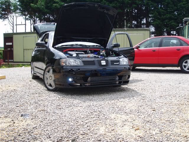

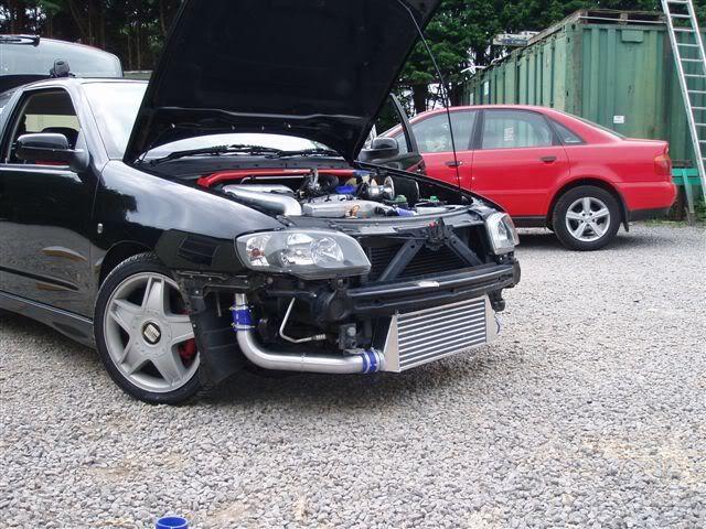

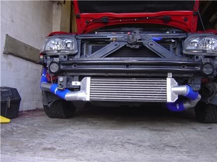

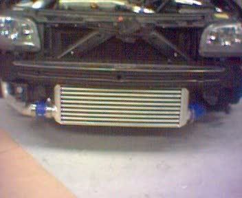

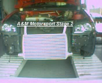

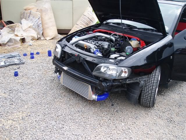

Some Pics
Our Modified GRS Core with our own fabricated Stainless Steel & Alu Pipework
Our Single Pass stg1 fabricated 10 Core, Revision A With Fabricated Alu pipes
Revision B of the 10 core same pipework
Our fabricated Stg 2 Single Pass 17core FMIC Revision A (As fitted to mine) with alu pipework
Revision B As fitted to Bills IHI and Adams Gt28RS

we were doing in batches of 5 but it worked out more of a development than a profit making tool.
Its amazing what little tweaks have acheived. as you can see by the pictures of the fmics different dwell times with different cores end tank design mandrel bent piping opposed to cheap straight cuts, bore of piping, thickness of piping routes and positioning is just a small amount of r & d needed.
