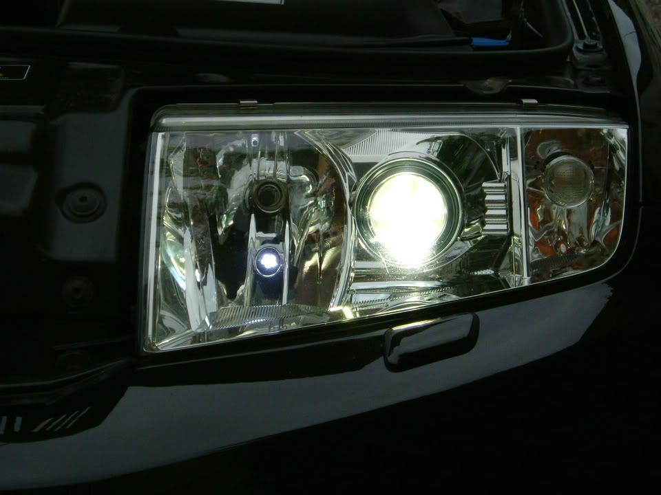

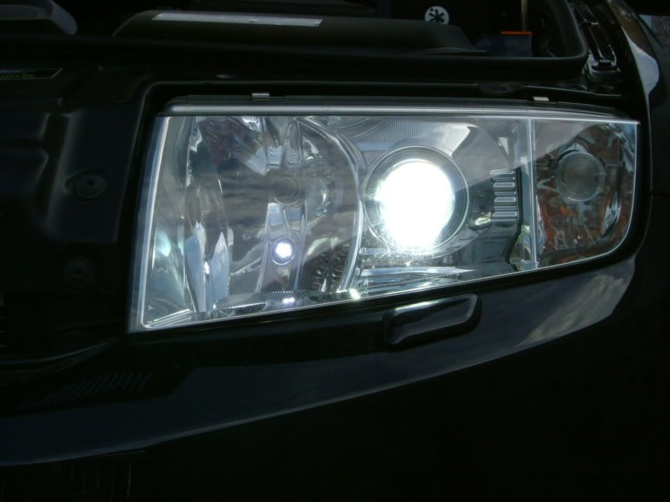

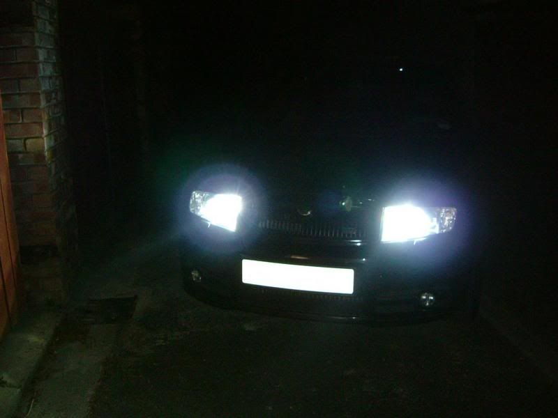

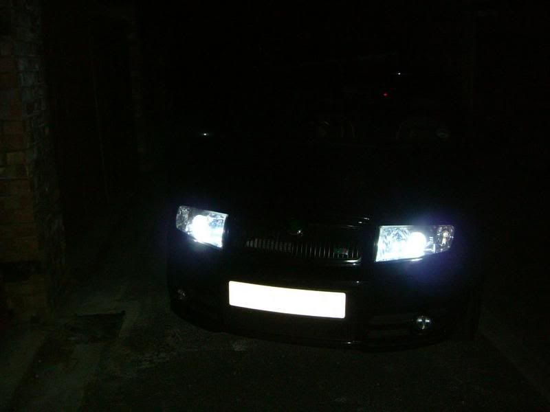

OEM Xenon upgrade? what did you have done and why?
The standard Fabia vRS Xenons have 4300K bulbs on dipped.
I upgraded to 6000K bulbs.
Then later, fitted H7 HID conversion on the main beam
Dipped:-
HID main beam:-

No, the K rating doesn't mean more power, you've actually got more light output from 4300K than from 6000K. 6000k just gives you more of a blue light than the OE yellowish one.
The projector lens combined with 4300K will give a whiter light, 6000k with projector lens will give a bluer light. 6000k with a reflector lens will give a blue / white light. 4300k with a reflector lens will give a yellowish white.
The projector lens units add a slight blue tinge which is why OEM Xenon / HID use 4300K and not 6000K
Dipped:-
HID main beam:-

So was there a difference on how they performed on the road? The HIDs 4u website reckons (as does UF) that they produce less useable light, so was it a purely aesthetic mod?
It is true hat 4300K bulbs will give more useable light than 6000K, but I couldn't tell any different. The mod was purely aesthetic.
As for the HID conversion on the main beam, well, that was a different story!!!
They were far, far brighter than the standard Halogen bulbs. Reminded me of my old Cibie spotlamps that I had on my first car - they were proper bright.
