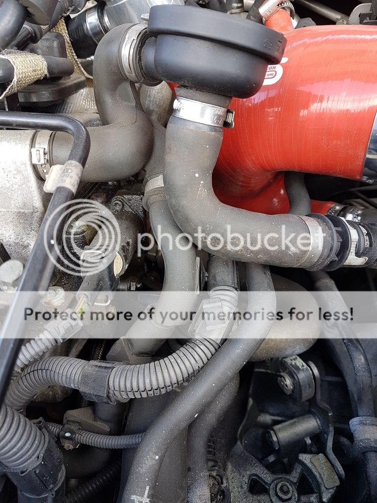

also this pipe was split
so need a new red silicone one any ideas which one as the one i thought it was is alot shorter.

split hose on pcv vavle to manifold

yea im taking it to another garage to have re scanned and cleared.
but still not sure which silicone hose i need can only find short hoses.

if anyone could link the pipe i need would be greatfull..

think most of them are to do with that split pipe.

so not all bad apart from that dam pipe .
now question is do i just go catch can and do away with pcv.?
but fix the pipe in the meantime.
