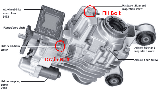

On any vehicle with a Haldex AWD system - the haldex pump is located on the rear differential, it's part of the Haldex coupling.
The pumps up near the gearbox are the support pump (only on the likes of the DQ381) and the VAQ pump (front wheel drive, active differential).
Reactions: Bahnstormer_vRS
I thought the pump was at the rear of the car, is the pump easily accessible?
