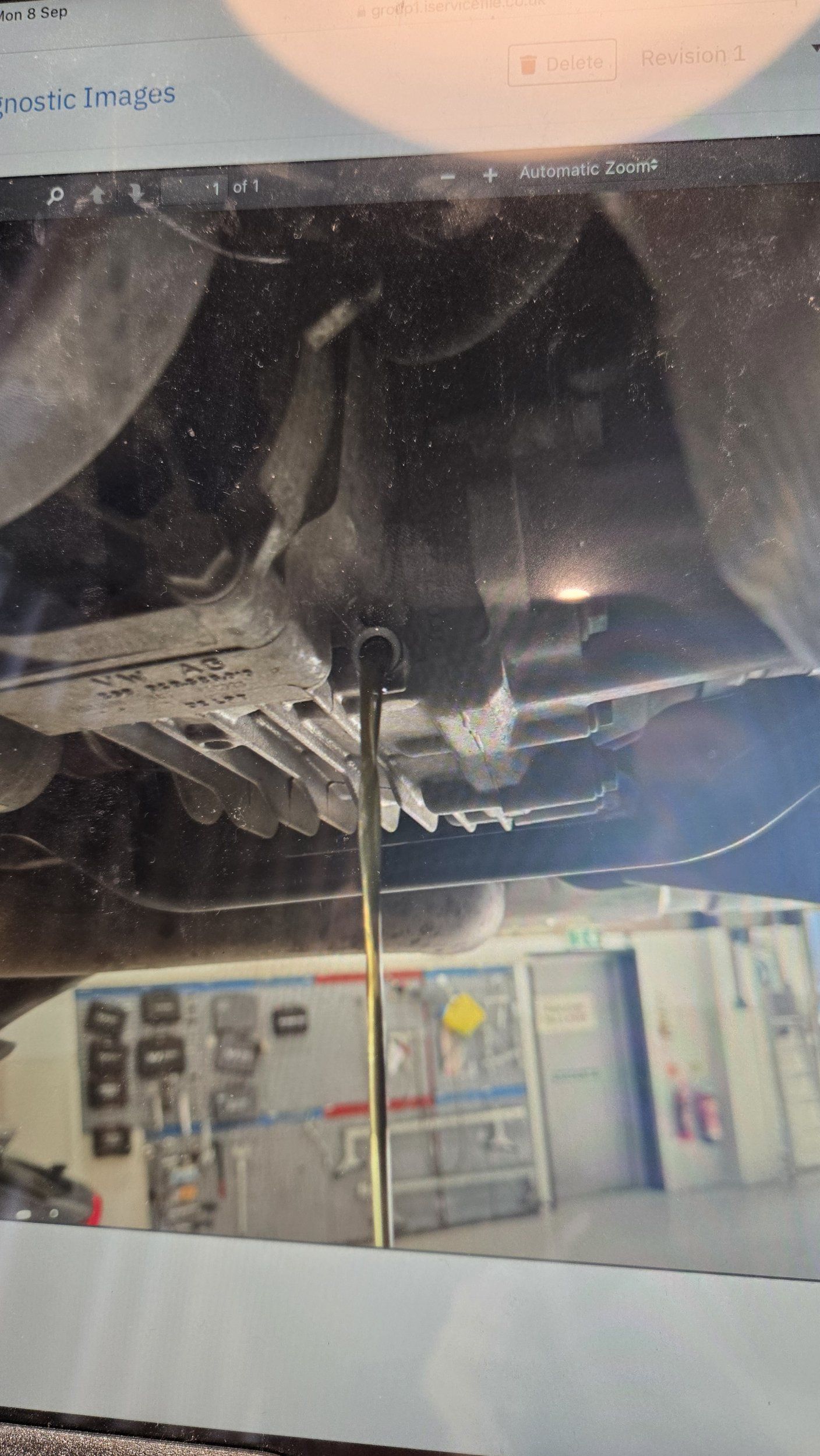

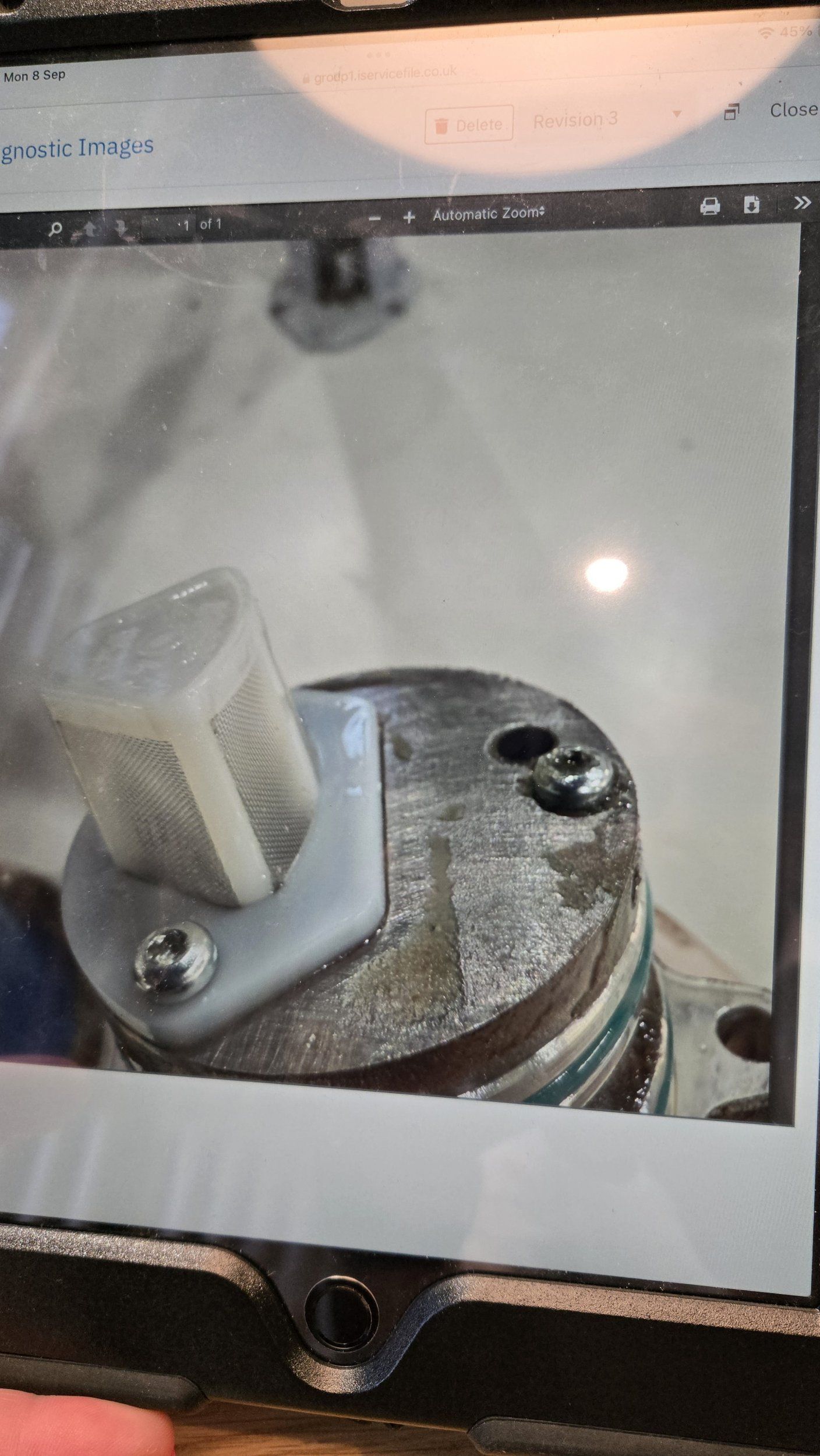

Hi Folks,
For those who are still thinking when to get Haldex service done.
See the attached pics got it serviced at 25k miles.
Definitely it was in a sad state.
Service done at cupra main dealer.
Owned it from new. Have not thrashed the car whatsoever just mostly peak time M25 drive.
Regards,
KJ
I can tell you that the manufacturer, Borg Warner, specifies significantly shorter intervals than VW does. Please take a photo of the unit's serial number; I have a bad feeling about this.

Good to see that the filter / strainer has been cleaned. Many VW dealers in the UK don’t do this as a matter of course; they say it’s not part of the Haldex service. They’ll just change the fluid and will only clean the filter / strainer if specifically asked to.
Yes it was a long shot, I requested dealer if they can take pics for my understanding and they showed me upon collection.
Even I asked if they would just change oil or do filter clean as well.
Answer was mostly oil change they would do.
I guess the technician did it regardless.
Happy days.
I guess 20k miles would be a sweet spot to get this done. Rest I think is a gamble.
Thought to post here for reference those who still wondering 3 years or 40k miles etc.
Better get it done every 20K miles.
