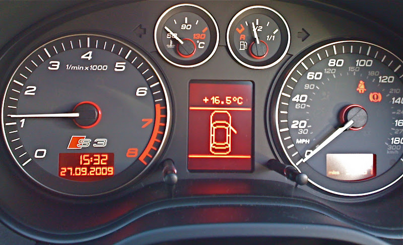

Just been out for another run:
1) Idle has changed from 825rpm to 750rpm with the can ????:confused:
2) The idle is MORE unstable than it was before
3) I seem to be getting a very light black deposit over the back of the car like soot
4) The car now sounds VERY cammy
Any other people who have one fitted noted anything?

Sounds a it worrying mate
have you vag com the car to see if there are any dtc's?
Silly thing to say but perhaps its just burning the crud off now you getting clean air in there? ecu might have to adapt?

it's a very fair point. Also I had forgotten that before I went away on holiday (3 weeks ago) I put injector cleaner in the car and I've just had to fill up the car this morning with a clean tank of 98RON Shell V-Power . I bet that has been wreaking some havoc in the system over 3 weeks whilst I've been away.
The car feels as strong as you like, so maybe it's just 'adapting' as you say.
