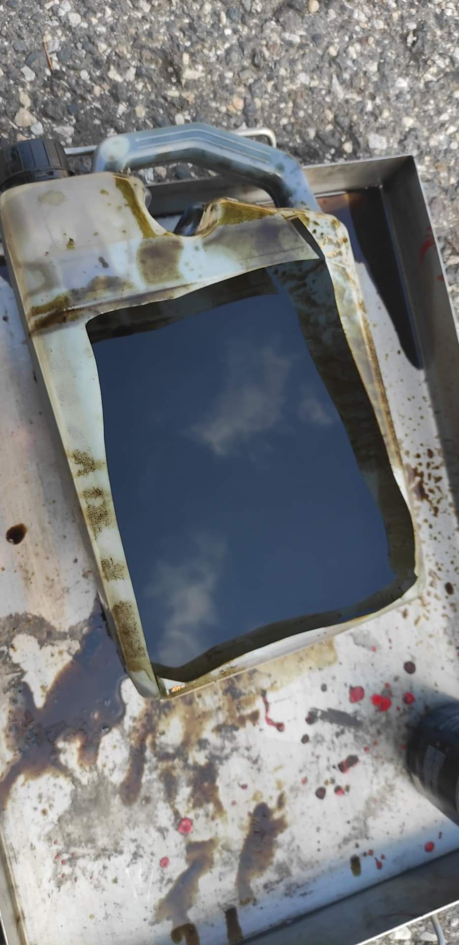

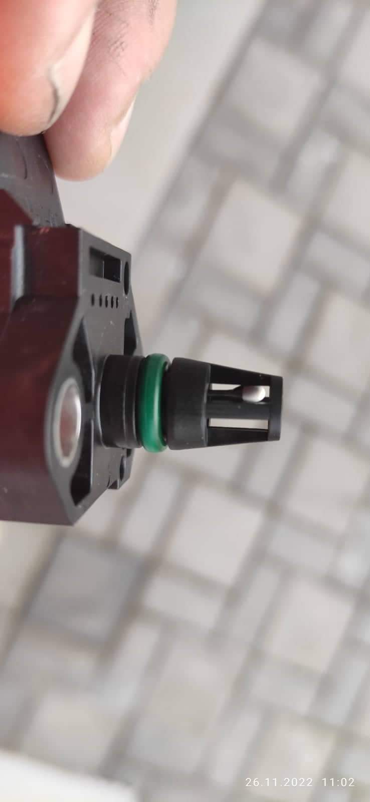

I have quite high fuel consumption compared to what i searched on the internet . I´ve changed the air filter (It was filthy) , sparkplugs , fuel filter ,oil and oil filter and i also checked the MAF sensors . All of this did help a bit because the car was neglected in the service department.

It´s a 2011 Seat Leon MK2 FR 1.4TSI 92kw CAXC with 160k (KM) on the clock. It had the timing chain done at 120k and clutch at 140k . Oil changes were long life but i suspect that when i bought the car it was´t changed for at least 40k because i had to flush the engine 2 times with ProTec engine flush. The car doesnt consume or burn oil , sounds healthy but rattles for a while on cold starts but from what i read thats normal .

Also some photos of the oil and MAF sensors
