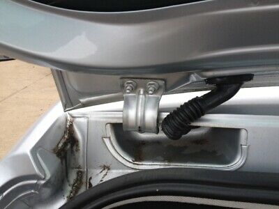

In the attached photo it shows an open tailgate from a MK5 Ibiza I think, this I found off the internet, but you can see at least 3 area's that are treated/covered over with seam sealer.
1) is directly under the hinge there's a panel joining there you can see seam sealer smeared over the joining gap, where the panel/s are spot welded.
2) inside edge of C-pillar there's 2 area's there in the corner, again where the panels join together as they are spot welded, the joint gaps are smeared over with seam sealer.
On your MK4 Ibiza it might be very similar that it has seam sealer smeared over the various joint gaps, that otherwise would allow water to run in to.
My point is that most car body panels are spot welded, they are not continuously seam welded, hence the use of seam sealer.
Check that area on your car with your tailgate open, your looking for any area's where the paint is split, or the seam sealer has perished and is coming away, allowing water to run in.

Thanks mate I went and looked today and you were right! I have 2 cracks one on each side in the same place!. Now what do you think the best option is? As i would silicone them but I feel its a bit of a bodge? Want to sort this properly really as not sure how long silicone will last!
