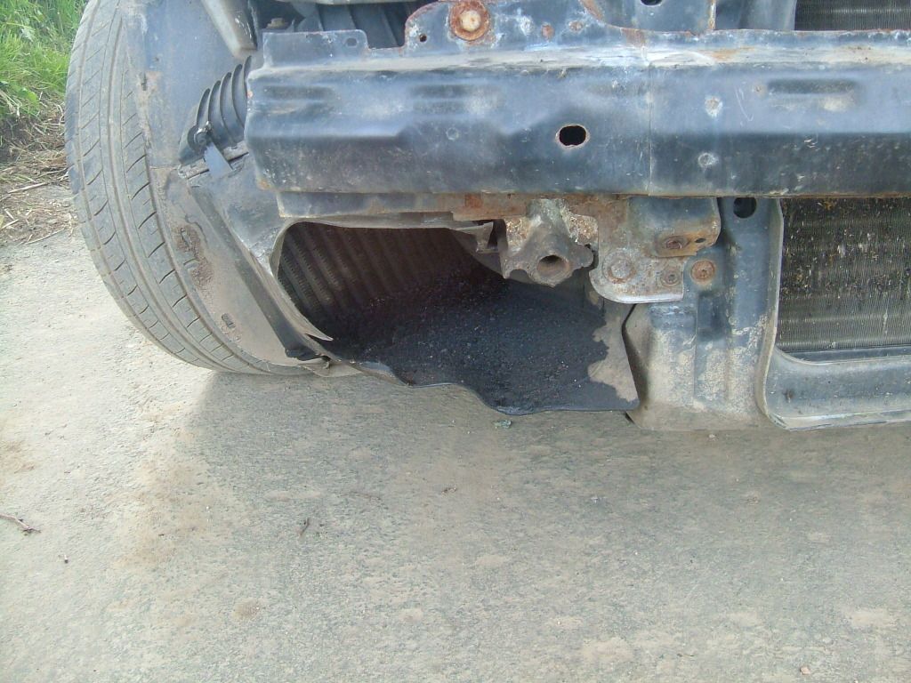

I had a look underneath the other day at the intake, and the bottom end egr, I didn't pull nothing but it's clear there absolutly caked in oil, carbon shite, it's that bad that it's actually flicked on to my radiator and across all the bottom guards, gonna disconnect Monday and clean out the crap see if that helps, as for egr blanking or deleting any good guides?
The inlet system gets oily from the crankcase fumes fed in by the PCV system. The oil pools in the lower pipe runs and leaks out of all the joints.

And yeah the intake at the Front is leaking as well as the pipes all ye way through well caked in oil and splashing everywhere

Yeah all the joints and stuff are leaking it's pretty much all caked so it's hard to tell ATM but joints are suspect
