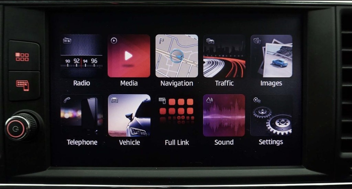

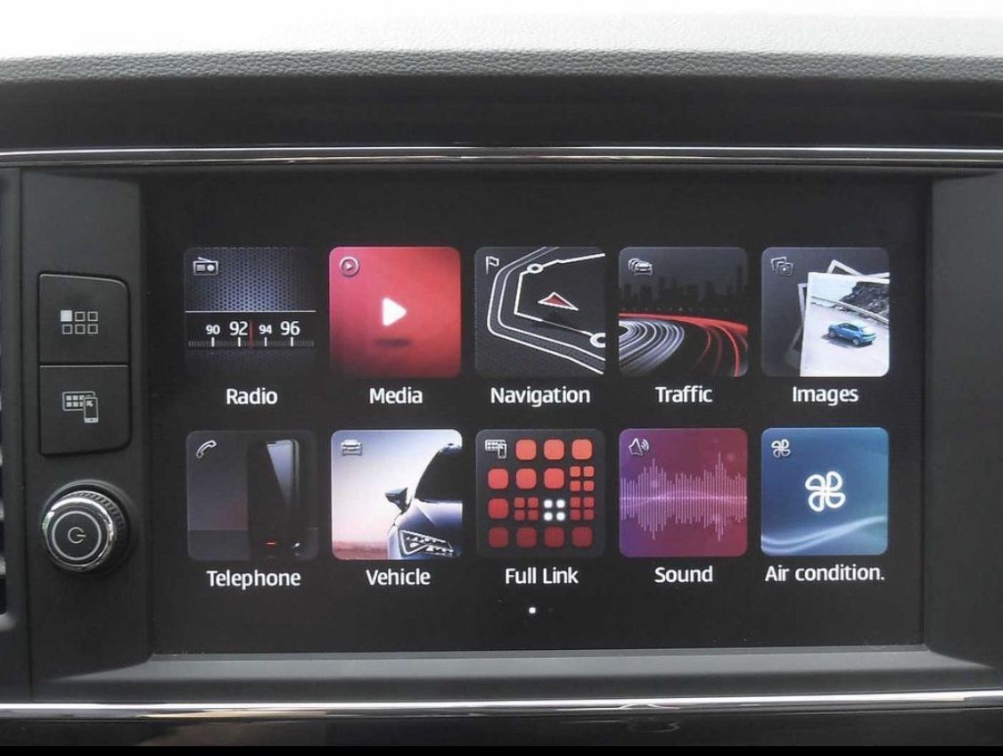

So my car has the version in the first photo, another 2017 Leon for sale near me has the version in the second photo, notice the navigation, air con and vehicle tiles are different.
I can only assume the one for sale has been updated, funnily enough it’s for sale in the same garage that tell me there are no updates available!

You should be able to swipe the screen sideways to see more tiles. I take it that you have Auto Aircon?

Scrolling doesn’t show anything else. I do have auto air con yes. I’ve been having issues with CarPlay cutting out and thought an update might help that’s the main reason, but I noticed some of the tiles have changed too.

There must be a tile for the settings menu, try doing a soft reset, hold down power button until the unit restarts.
Also put it into 'carousel' view and see if it shows any different options compared to the 'tile' view.

My 2018 FR has the same icons as the second image, but SW version says 0468.
It's not been serviced yet, so no updates since new.

I have the version in the first image, so I have the settings button but no air con icon.
I believe there is a much more recent version but where to find the file I have no idea!
Found a Spanish forum with updates but the files are a few years old so no support for the 8” screen.
