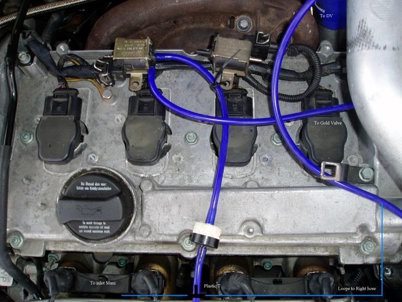

I can take a pic of my setup and you can see from that
I have only one nipple on actuator also!
Cheers, Jack
Thats a pic of my setup, i need to trim some hoses down but you get the gist.
Then from the n75 you have one hose to charge pipe, the long end in tip and the other end to the wastegate actuator nipple.
Hope this helps!
If im wrong then please correct me!
