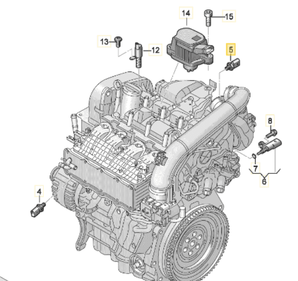

There is low oil presure on ingnition on but not latter, drives normal no shakes normal oil and coolant temerature. Oil presure checked and sensor replaced still same problem.

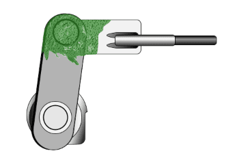

Regarding your fault code - this will probably be a seized turbo actuator pivot. Quite common on the 1.4
A 1.4 Golf in my family had this fault - we managed to disconnect the pivot pin (it was very seized), clean/file & grease and a new circlip and all working fine since.
If severe you'll need a new turbo actuator
This thread has some useful photos:
As long as your oil light goes out when the engine starts that is normal. No engine will have any oil pressure when the engine isn't running.

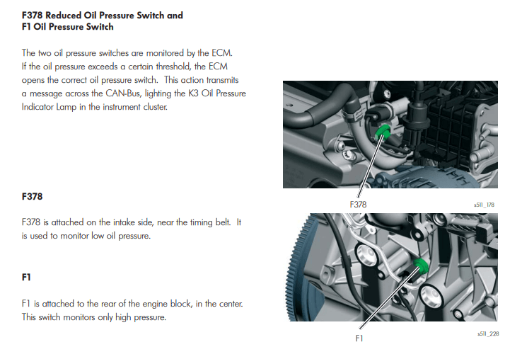

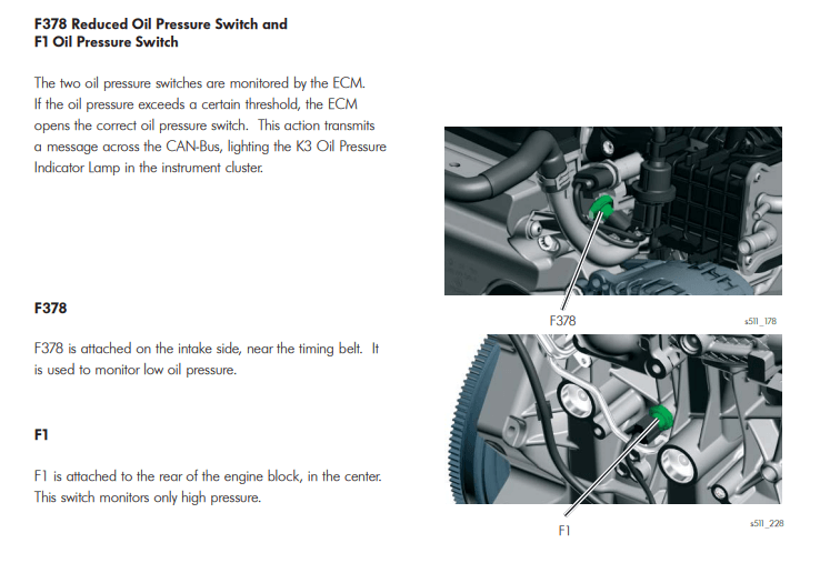

If it wont hurt car ho cares! Eaven on startstop got it. Its down on turbo side sized. Going to other mehanic for inspection. Everyone is like dont buy tsi it unreliable bla bla bla. Im preaty shure they are better tha any tdi.

That is an oil light you SHOULD be concerned with!
I though you were referencing the oil light which goes out when the engine starts.
There are plenty of cases with the 1.2 and 1.4 oil filters being incorrectly changed either by leaving an old o ring seal in there (or missing one!) or fitting the wrong oil filter part number.
To double check I would give it a fresh oil and filter change with genuine oil filter from dealer - and the correct oil grade.

Presure is nice on cold and hot

5581 - Oil Pressure Switch
P164A 00 [00101111] - Implausible Signal
Confirmed - Tested Since Memory Clear

Did you check mechanically? or...
This is something you need to dive in further

yes im bringing it to other shop
