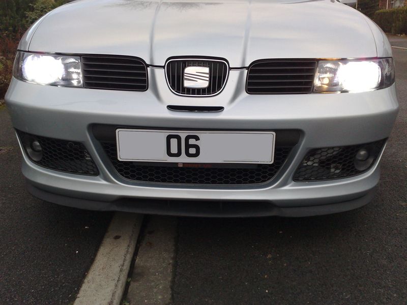

heres a picture of mine from HIDs4U, they are the ultimate ones, cost bout 160 with a discount code! 8000k ones with the LED sidelights too (only one side has got it in because one was faulty)
very easy to fit, took about 40 mins tops
