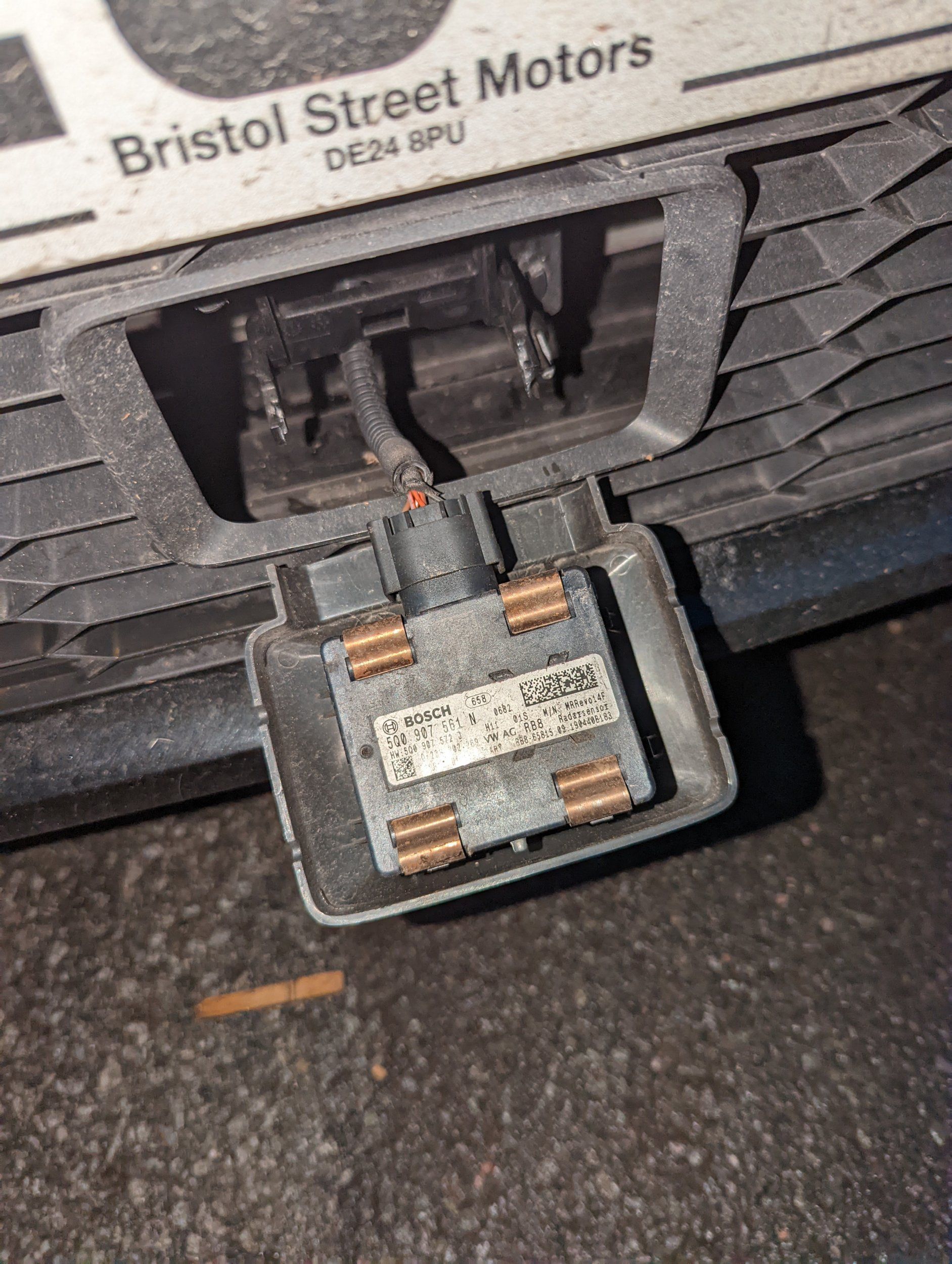

Hi I was on route to work this morning only to unfortunately hit a badger. Being that they're tough little things I thought it would have caused damage to my car but thankfully it hasn't.

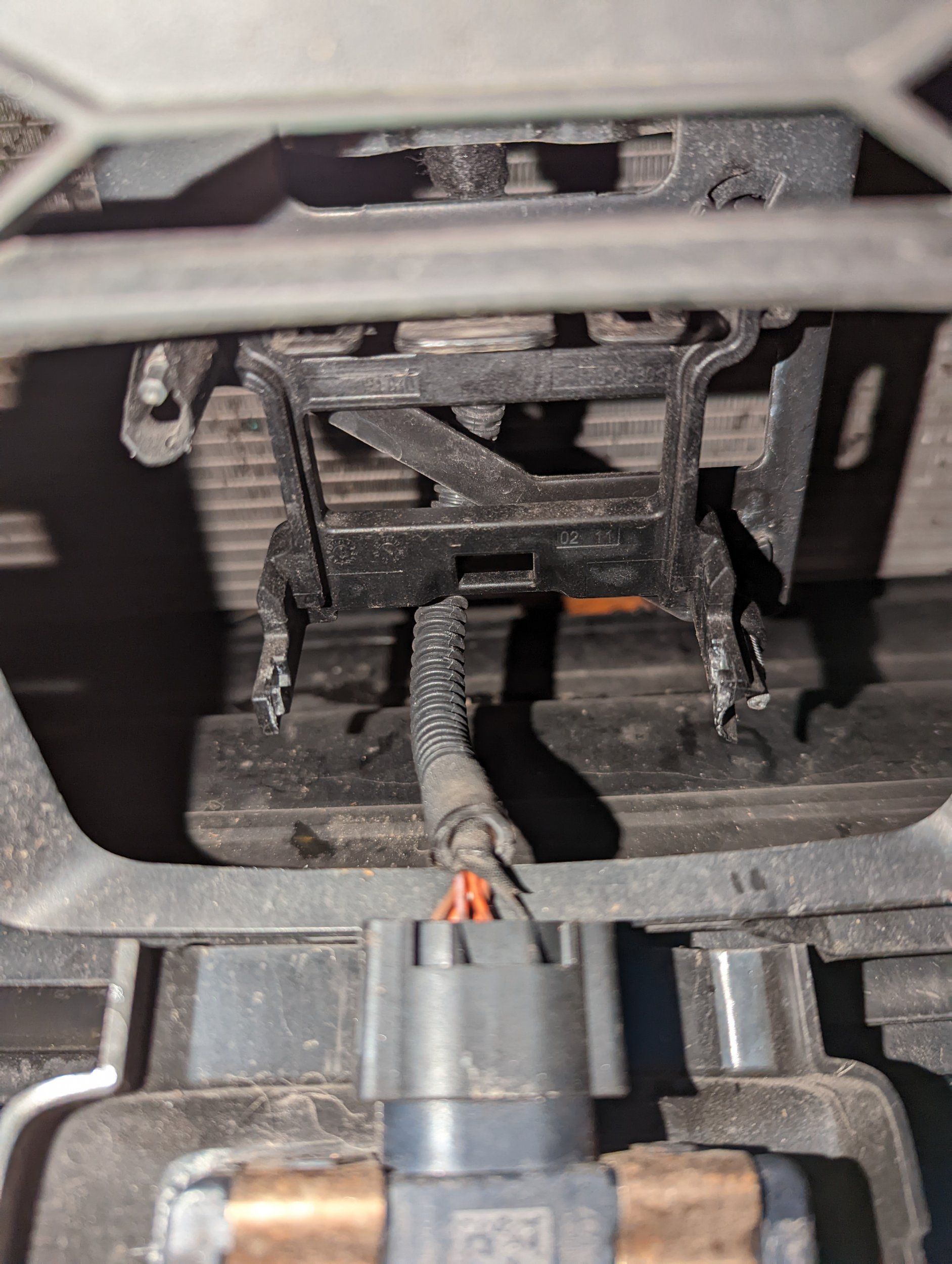

After closer inspection it seems it's knocked the front radar sensor out of place. I've been looking around online at images of new mounting brackets and mine doesn't look like it's broken per say but I thought I'd post the images here for anyone more clued up than me in this area. Looking at my (admittedly shoddy) pics do we think this is a new mounting bracket job?

Yeah managed to have a look at the bracket after work yesterday, turns out the bracket was fine and it was a case of clipping the sensor back into place. Unfortunately driving along today the car threw up an error so it clearly needs recalibrating. What kind of costs could I be looking at if anyone knows?
I think it’s around 300 it used to be 400 but think it’s gone down in price that’s dealer. You may be able to get a fast fit place to do it for a lot less but I have never done that myself.

I think that it depends on the dealer - I was quoted £170 at Audi previously - the radar is supposed to be adjusted if the rear suspension geometry is adjusted.

Ouch, yeah it's in the dealers on Thursday for the dreaded rear seat catch rattle so might get them to look at it whilst it's there.
