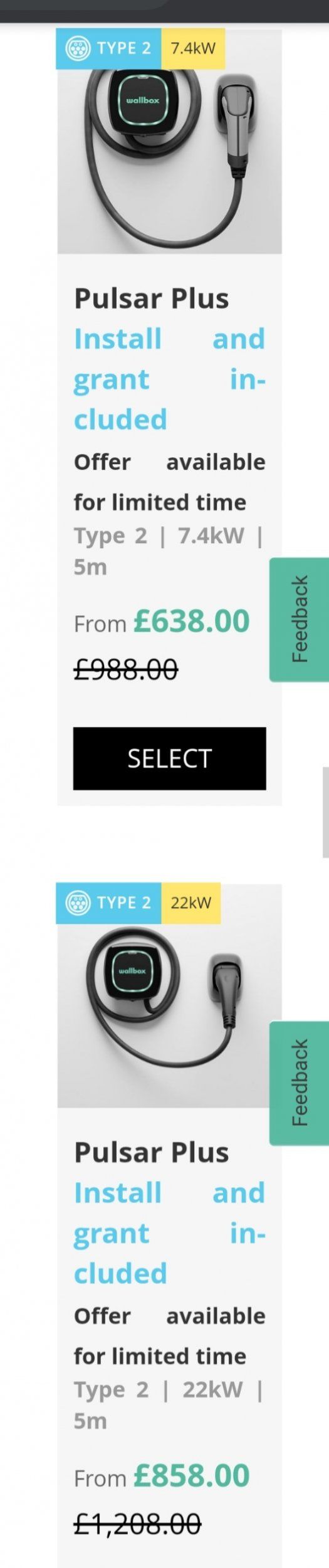

Considering a wall box charger and see their 22kw version isn't too much more. Probably worth the extra for future proofing.
You'll need a three-phase supply to the house and, unless someone can correct me, most homes don't have this and it's expensive to install/switch to it from single-phase.
