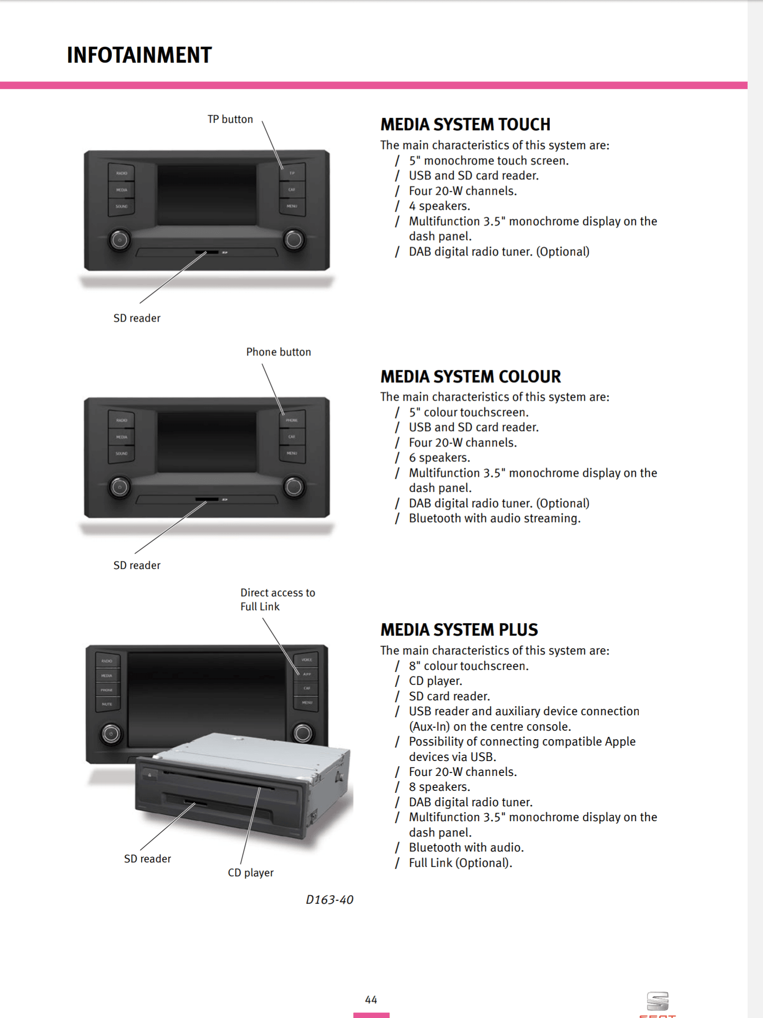

Anybody ? Or you pay the boards retrofitter to do it remotely if a mib2 standard. That's what I advised somebody the other day. Mib2 standard which I think you have, you use the mib2 toolkit as I posted up above but there is little experience of it here. Mib2 high (Seat Plus) you either use the mib2 high toolkit link above or install 1447AIO. Either of the mib2 high solutions unlocks full link. If your unit uses a map card then it's a mib2 standard. Other tell tail signs is to hit the media button, repeat. If it shows Jukebox then it's a mib2 high. Suspect not. They were optional extra so people didn't pay for them. There were Atecas sold with baseline infotainment systems. No navigation at all.

I don't have navigation in my vehicle, but I think I don't know if mib2 is available. My only goal is to make a full link. I want to do it myself. I don't want to buy it. Do you know a forum that explains how I can do it? I need a full link very much right now. That's why I'm trying to do it. If it's something you know a little bit about, I won't do it step by step. I would be glad if you help

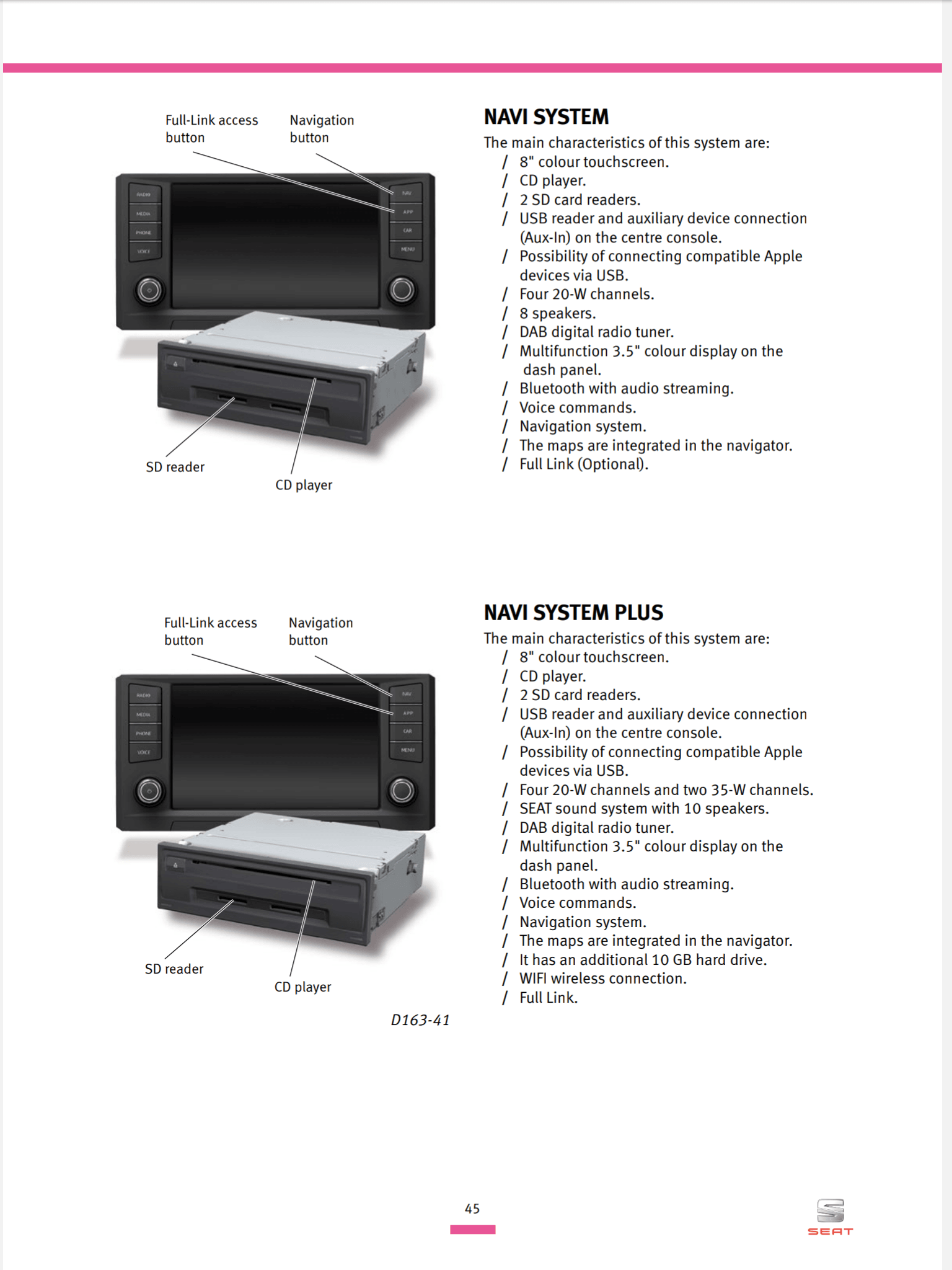

You might check whether you have the third unit down then which has an option for full link. If its one of the two above I doubt it's got the programming power, memory, operating system etc to do it.
You can actually kill your unit if you incorrectly load up modded software or jump mib2 standard trains. That media system plus unit may have a weird train I've seen or it could be the two above.
@East Yorkshire Retrofits may give you pointers but they are in the business to make a profit. The other place to ask the question is on the Leon 3 part of the board or look for an answer. The volumes of sales of Leon 3s were higher than Atecas and more modding going on subsequently. If yours is one of the two first units you are out of luck, you would be on a bigger retrofit. If its a mib2 standard, forth then you are risking bricking the unit if you get it wrong. Those units were common to Seat cars at the time.
For completeness the Navi units:
